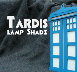

After making a wooden lampshade* for one son, the other decided that his shade was a bit past it as well. But he wanted something "a bit less bare".
Since we’re both fans of Doctor Who, and we both want our own Tardis, this is what he got...
Step 1: Design
As you can see, I went for a Tardis-themed lamp (I had no idea which Doctor Who to do).
There are lots, and lots, and lots of resources out there - I used a number of stencil designs as design cues, and simplified them to go for the instantly-recognisable silhouette.
The stencil designs were, obviously, two dimensional, but I decided to add layers to improve the silhouette.
Once I got the proportions from the online sources, I sized the design according to my needs (3cm hole at the top for the pendant fitting, enough space inside to fit my hand etc), then turned to MakerCase to generate a finger-jointed box of the right size.
Using Inkscape, I removed the bottom, added the door details, and drew up additional details like the lintel and the roof shape.
Here’s a cool thing: if you haven’t got your own laser cutter, you can use one of the first two files on this step to try laser cutting at Ponoko, - you won’t get to watch focussed radiation evaporate wood, but you'll have the desired effect.

Step 4: Main Construction
Before you start gluing, make sure you've got the parts in the right order.
Add a thin line of glue to the finger joints, and build the main box - you will need to clamp it gently while it dries.
Step 5: Lintels
There are two kinds of "lintel" in the design - one with a hole in (to suit the "POLICE" banner on the original box), and one that is just a strip of wood for the bottom of the Tardis.
When you glue the top lintel in place, the hole lines up with the hole already cut in the main body of the lampshade.
For both top and bottom, there is a 3mm overlap on the left-hand side - when all four are in place at top and bottom, the overlaps all match up.
Step 6: Roof Outline
There are four roof outlines to complete the silhouette of the Tardis.
There are no slots or other parts to hold them in place - you just have to balance them in place by eye.
Do not be deterred by the roofs' tendency to fall over at this point - once you add glue along the bottom (and one end), they will be much easier to balance.
You should now leave the whole shade to dry properly before going on to the next step...
Step 7: Paint
As much as I like plain wood, the Tardis is wooden, but it's not plain. It's blue.
I used a blue spray paint from my stash - it may not be the canon-perfect shade, but it's close enough if you grew up with the early versions in black and white. If you spray, use even, top-to-bottom passes, starting above the shade and ending below it. I used three thin coats, letting it dry properly between coats.
You could use acrylic paints and a varnish, or even enamel paints. It's your lamp shade, you choose.
Whatever you do, though, it's a good idea to stuff the lampshade with scrap paper before you paint, so that you don't darken the inside of the shade.
Step 8: Windows
You could stop at step 7, and hang the shade, but you'd get glare in odd points around the room.
You diffuse the light by adding translucent panels - you could use tracing paper, baking parchment or coloured sweet wrappers, but I used freezer paper.
Cut four pieces, each slightly smaller than a side of the lampshade.
Reaching carefully into the lampshade, add a small smear of glue around the edge of one side of the shade, then slip the paper into place and smooth it down.
Leave the glue to dry, and you are ready to go.
