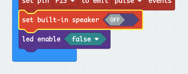

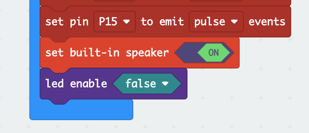

Step 21: Change the Speaker
  • In the code, set the "built in speaker" to off, then re-download the code to the micro:bit.
