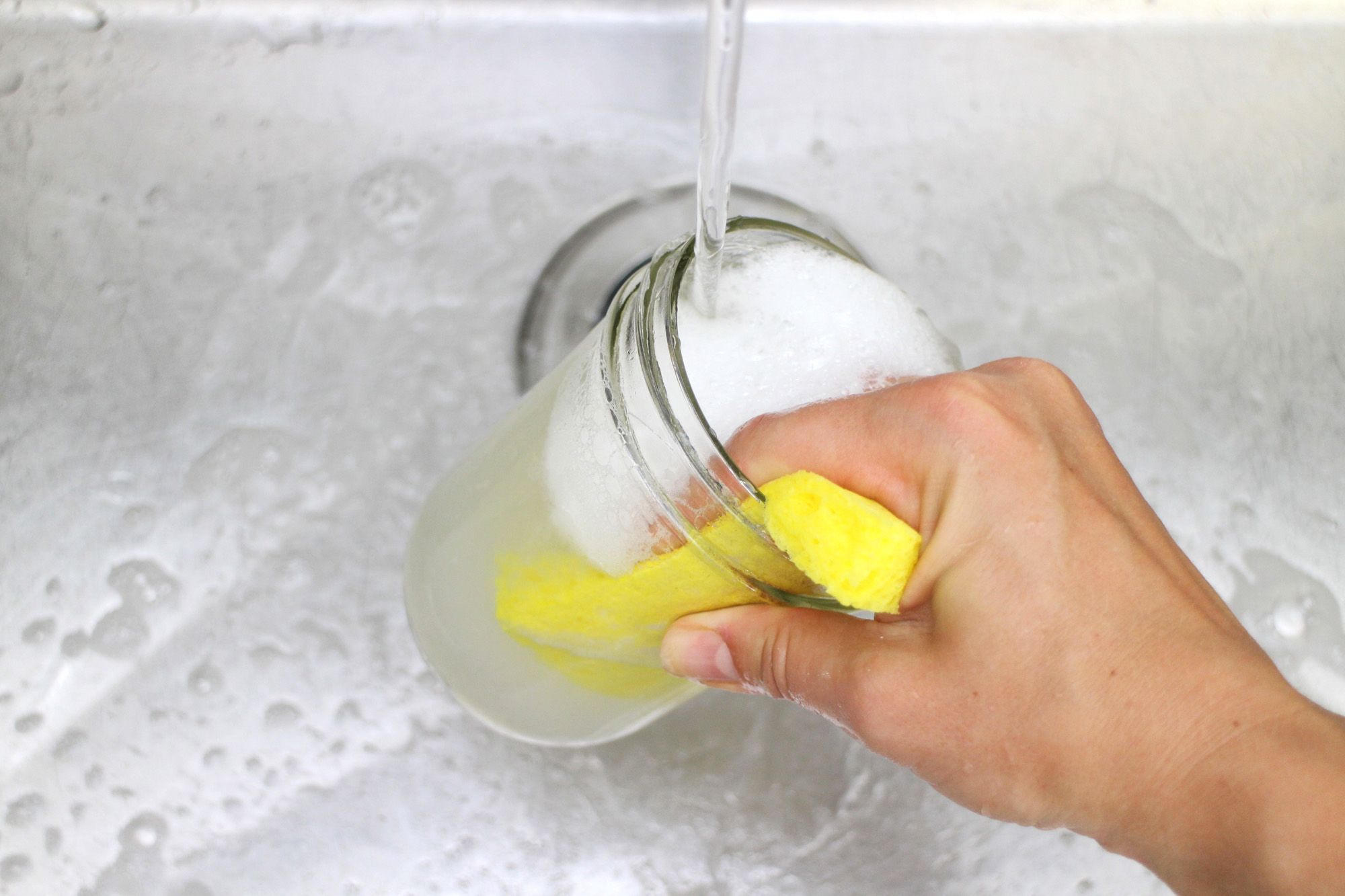

One common ally against spoilers that all preservation techniques share is: SANITATION
One of the best, and easiest, ways to keep spoilers at bay is to simply wash them off and prevent them from returning by keeping your hands, work surfaces and equipment clean throughout each preserving process. This best practice will go a long way toward helping you achieve safe preservation.
NOTE: Cleanliness is a must to ensure safe & successful preserving!

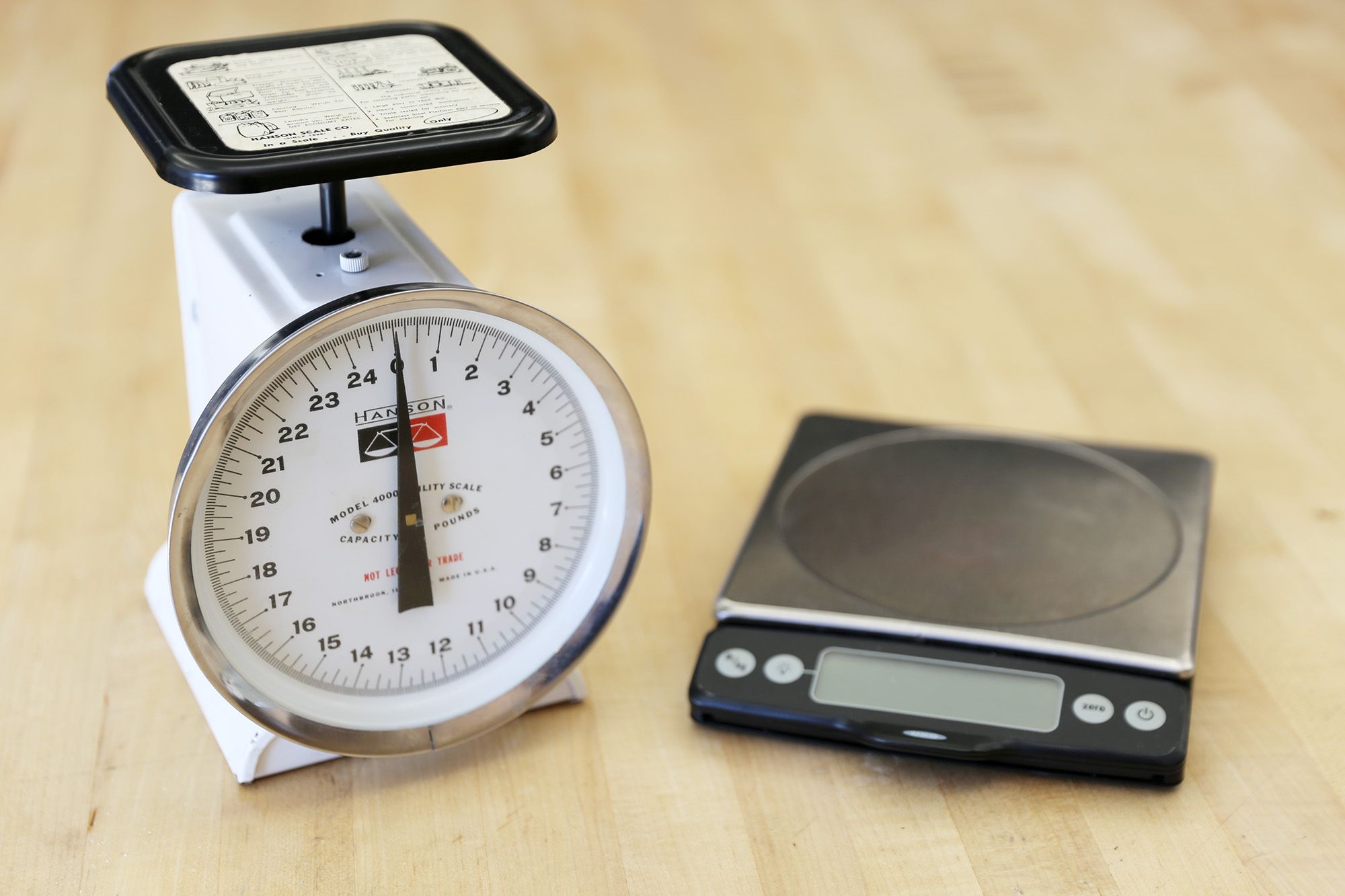

A Note on Kitchen Scales
The most accurate way to prepare the correct amount of ingredients for the desired number of jars, is to use either a manual or digital kitchen scale. Both work well. The only disadvantage to having a digital scale is that if you zero out your scale for a bowl you'll be loading up, then cut up your ingredients and start loading up the bowl, the digital scale can just turn off, erasing all memory of the bowl's tare weight. This means you have to weigh the bowl and write down its tare weight so you can subtract it form the total weight. Not a big deal, but math. With the manual scale, once you zero out the weight of the bowl, it's there until you manually adjust it for the next thing.

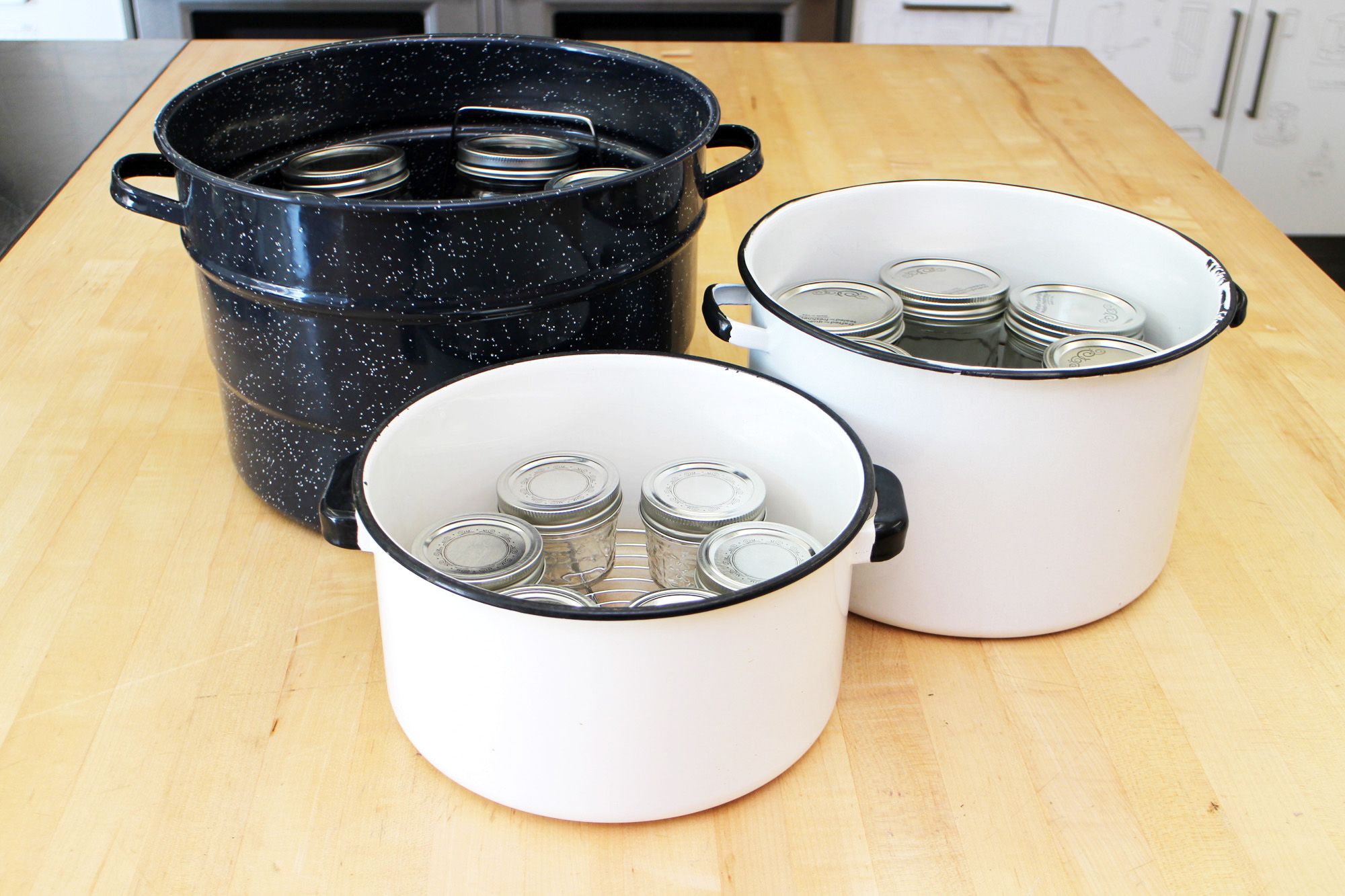

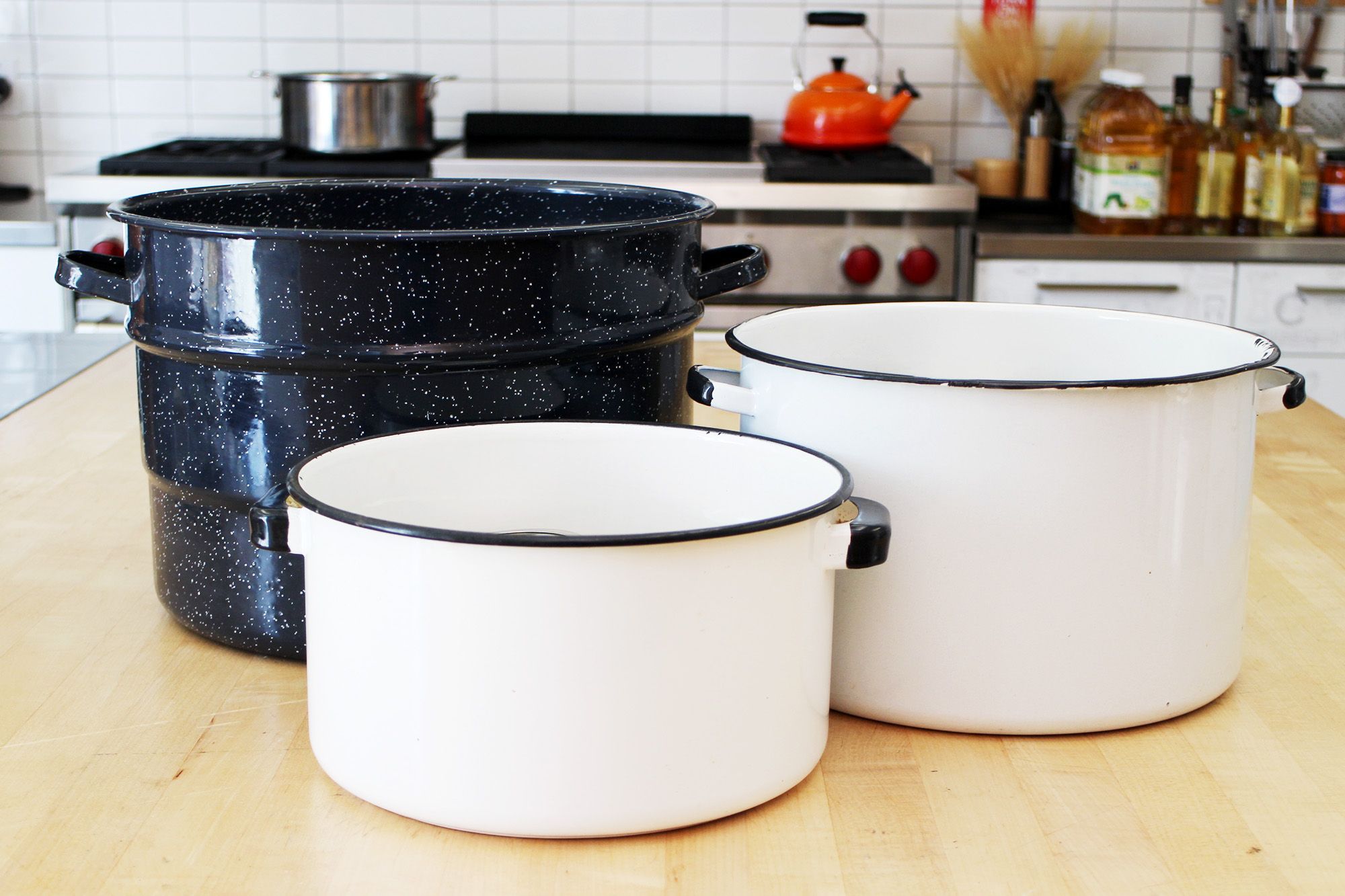

Deep Canning Pot
The 3 most useful sizes of canning pots: 5.75-quart (5.4 liters), 11.5-quart (10.9 liters), 21.5-quart (20.3 liters)
I recommend choosing the size you buy based on how many people are in your household and the kinds of things you'd like to can.
- The 5.75-quart pot (10.5" W x 5.5" H) fits seven 4oz jars that work best for jams, jellies, spreads, and fruit butters.
- The next size up, the 11.5-quart pot (11.75" W x 7.25" H) will hold seven 1/2 pint or pint jars, which I like to use for spreads (8oz), whole fruit, applesauce, as well as picked veggies like dilly carrots (see next lesson).
- The 21.5-quart (14" W x 9.5" H), fits seven quart jars perfectly and works for whole fruit, tomatoes, pasta sauces, etc.
Because there are only two of us at home, the largest canning jars I use are the pint sized ones, because I'm confident that once opened, we'll eat that amount before it goes bad in the fridge. If you have more mouths to feed, then you will want to consider using the quart sizes for recipes that accommodate that.
If you only want to invest in ONE pot to get started, I recommend going with the 10-quart, as it will cover most of your beginner canning needs without taking up too much cupboard space.
There must be at least 1-2" of space for water above the jar lids for proper/safe canning to occur.
The only important thing to remember is that whatever pot you choose, it MUST BE big enough to allow for 1-2" of water above the jars you're using in order to properly, and more importantly SAFELY, can.

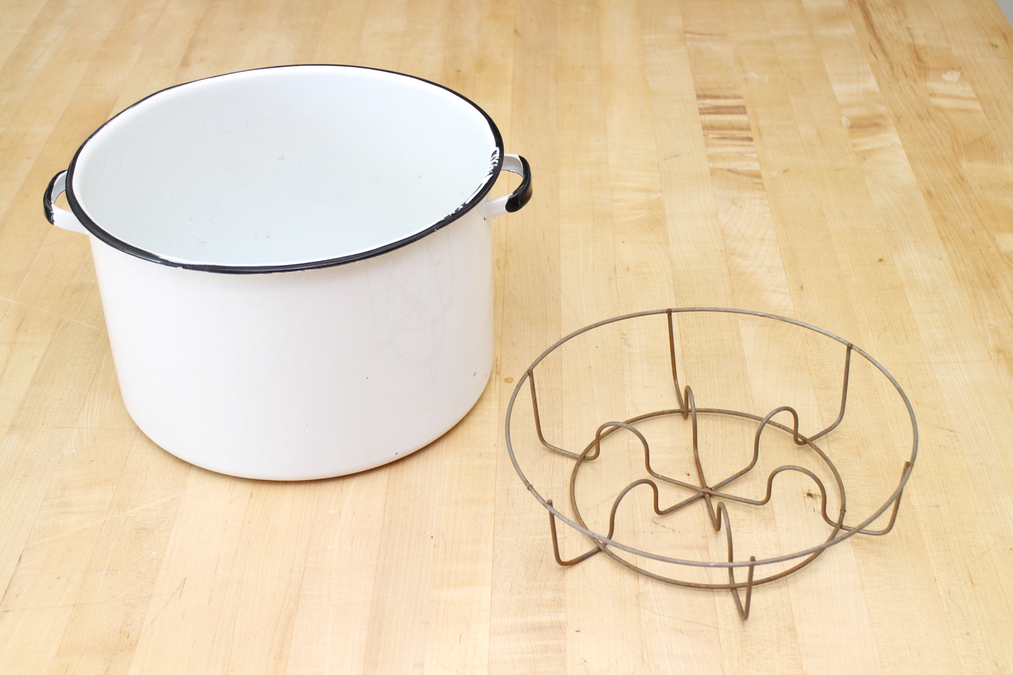

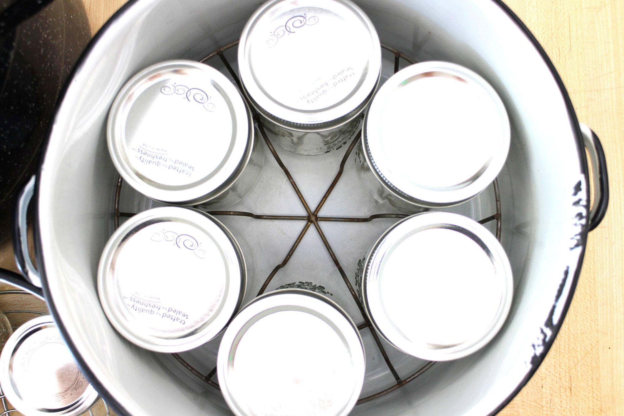

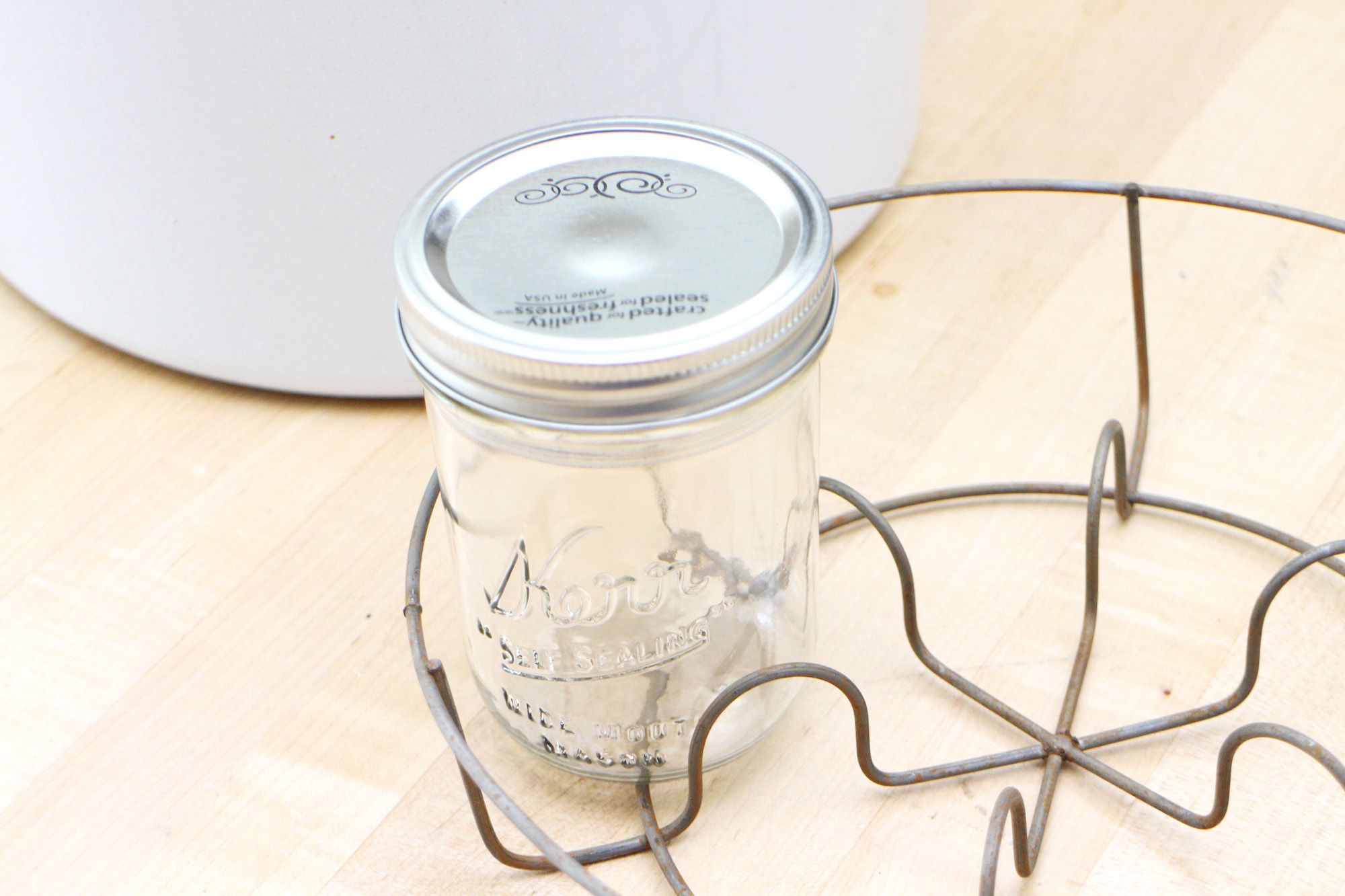

Round Jar Rack
Official racks are made to accommodate 6-7 jars.
Top view of loaded rack. A seventh jar could be added in the center.
Adding a round rack to the bottom of your canning pot (to raise the jars up off the bottom of the pot) is necessary to prevent the jars from cracking. You don't have to buy an official one (some canners I know use 7 lid rims tied together with baker's twine), it just has to be something that is approximately the size of the pot bottom and will elevate the jars without floating to the surface and getting in the way of the canning process.
Other options: How about a round silicone trivet or a round pastry rack? Even a dishtowel will work in a pinch!

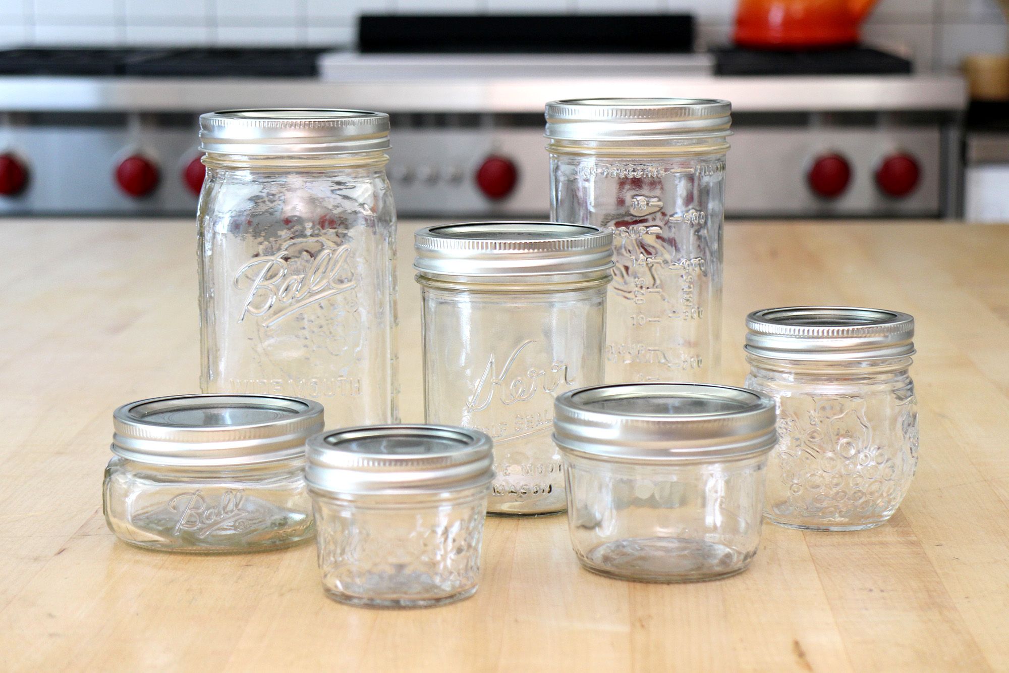

Canning Jars
There are many different sizes and shapes of canning jars. There are both wide mouth jars and regular - the regular having a 'shoulder' on the jar where it goes in to meet the smaller lid. This can be helpful for avoiding 'float' in which the canned food floats up and out of the canning liquid. (This isn't harmful, but it can cause the exposed fruits or vegetables to dry out and/or discolor.)
Choose your jars based on the serving sizes that you want or need for your family size. If the recipes I provide in this class don't align with the amounts you want to make, a quick check on the internet will help you find the correct info (size and number of jars along with canning times) for making a bigger batch.
A note on lids: The flat sealer lids are meant for one time use only. Never reuse these. Always use brand-new and clean lids every time. The rings may be reused without issue.

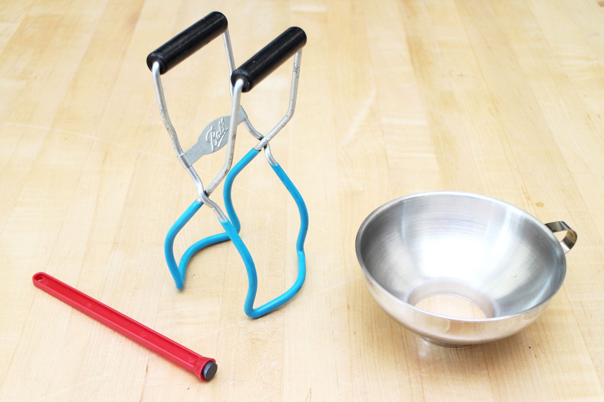

Magnetic Lid Lifter, Jar Lifter & Canning Funnel
These little specialized canning tools are inexpensive and SO USEFUL! Definitely worth getting to make your first time canning a pleasant, tidy, and pain-free experience. (Remember, this is called BOILING water bath canning.) :)
The magnetic lid lifter is used to pick up the metal sealing lids out of warm water and place on the jars. This hands-free exchange prevents potential contamination and saves your fingers from having to take a dip in hot water.
The jar lifter, in my opinion, is essential. It's used to put in and remove the jars from the boiling water bath. Its shape is designed to fit to the contour of the jars, and therefore, safely move them without risk of dropping them back into the hot water which could splash on you or your hands. That's some pretty inexpensive safety!
The canning funnel sits comfortably in the opening of all jar sizes and helps tidily corral whatever you're canning into the jars. Less mess is best!

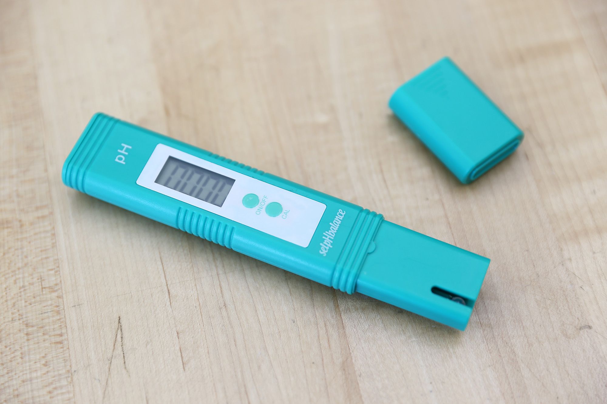

OPTIONAL TOOL:
Digital pH Meter
If you plan on only following recipes when canning, then you will never need this tool. But if you are an inventor at heart and want to come up with your own recipes to can, you will need a good pH meter in order to know whether or not your creations are acidic enough (below 4.6 pH) to be boiling water bath canned.
