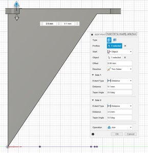

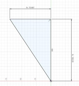

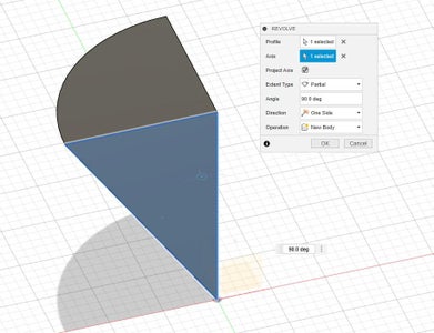

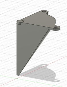

Now it is time to draw the main sketch. You could draw any shape you like for this step so long as it has the correct overall height (or close to - as we will scale it later). I chose a simple right-angle triangle with a height of 106mm and a width of 106*2/3.
Then use the Create > Revolve feature to turn your sketch into a 3D model. Since each corner of the monitor stand needs one leg, by revolving only 90 degrees it means we get 2 flush sides, preventing the legs from sticking out the side of the wooden top.

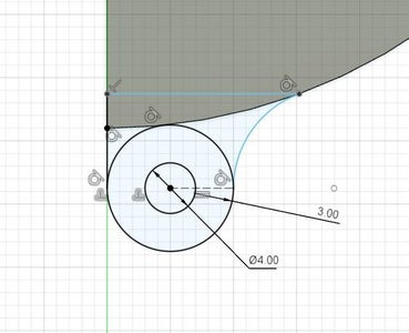

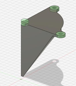

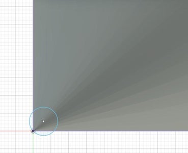

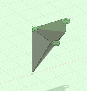

To add mounting holes, we'll start a sketch on the top of the model. Start by drawing a tangential circle with another circle inside it on one of the corners. The inner circle represents the screw hole, while the outer one is the material around it. It's crucial to overestimate the material needed because refining the mesh later may result in some material loss, potentially causing the screw to snap the model.
Connect the concentric circles to the top face using an arch on one side and a line on the other. Since the model is cone-shaped, extruding this sketch downward alone won't connect it to the model. To fix this, join the base of the arch and the end of the line with another line. This will provide a flat face when extruded that we can then extrude again.
Then by using the Create > Extrude feature, we can join our mounting holes to the component. You need to do this in 2 separate extrudes. The first one is of the new sketch (downwards) of the desired thickness. The second is of the innermost flat face you have now generated, and extrude it into the main component, joining the 2 bodies together.

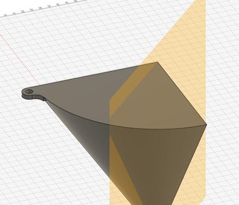

Next, create a plane at 45 degrees. You can do this by going to Construct > Plane at Angle. This plane should divide the model down the middle. We can then mirror the component using the Mirror feature about the plane, resulting in a body with 2 identical mounting holes. We only need 2 mounting holes as when attached to the top plate of the monitor stand, the weight force will try to push the legs outwards, resulting in a compression force on the corner, whilst pulling against the screws, holding it in place.

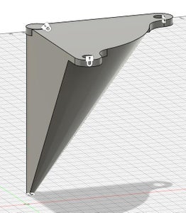

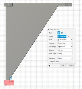

So that the final design doesn't have such a sharp point, we can create a sketch on the bottom of a circle as shown below. This allows us to cut away a section of the point, whilst also adding a section at the top for additional stability (using the extrude feature).

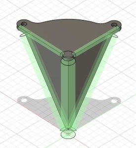

The first step is to define the regions we do not want the optimisation to change. We can do this using the preserve region feature. Select the outer contour of the region you wish to keep (in our case the 2 mounting holes and the back circular feature), then scale the region using the arrows and feature pop-up. Your model should look like the following:
We also want to preserve the outer structure and the face on the bottom (where it comes to a point). You can do this by using preserve region, and this time selecting the outer contours of the model. As shown below:

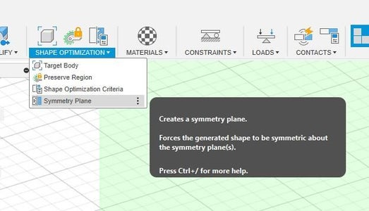

If you want a symmetrical leg (which I do), we can also add a plane of symmetry. If you recall from earlier, we created a plane that divided our model in half (as we needed to mirror the mounting holes). We can select that plane, and use the Symmetry Plane feature to generate a plane of symmetry that cuts down the middle of our part.
Next, we need to add structural constraints. This defines the points that will be fixed in place. In our case, we want to apply constraints to both screw holes, the circular feature on the top of the model, and the point that will be in contact with the table/ground.

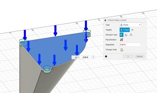

Now we need to apply the load. In this scenario, there is only 1 force acting (down from the top), so the magnitude is not relevant. To add a load, click on Loads > Structural Loads, then select the top face and enter any value greater than 0 into the magnitude field.

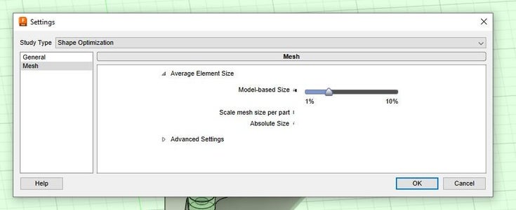

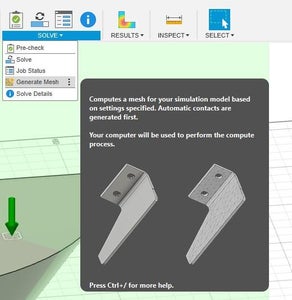

We now want to generate a mesh of our part to make sure everything looks correct. Go to Solve > Mesh to generate the default mesh. More often than not, this mesh is too coarse for the part, reducing the accuracy of the results. To modify the mesh size, we can go to Manage > Settings and use the slider to change the mesh size. Making the mesh size smaller will increase accuracy, but also the time it takes to process the optimisation.

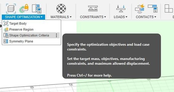

Next, we define the goal of the optimisation. In our case, we want to remove material to save filament and hence money. We can set the goal to around 30% of the original mass however, once the simulation is run we are still able to visually see other weights and choose the best one. We can do this by modifying Shape Optimisation Criteria, and then changing the Target Mass value. We want to keep the target as Maximise Stiffness.

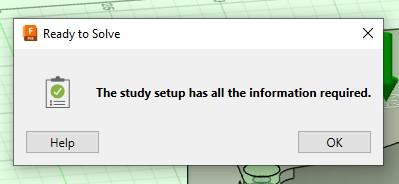

Choose the target body by clicking on the icon in the toolbar and then choosing the leg as the body. Then click on Solve > Pre-Check to make sure there are no errors. If all is ok you should get a message as shown below. Now you can hit Solve and the topology optimisation will begin!

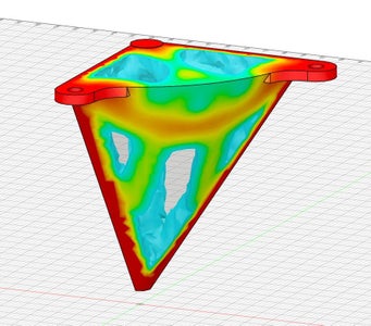

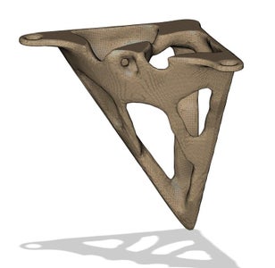

Step 6: Results
If the optimisation goes as planned, you should now have a beautiful and futuristic-looking part right in front of your eyes! You can change the weight ratio by modifying the slider on the right-hand side. You can see this in the video above. Once you are happy with the way it looks, and you think the part will be strong enough, you can promote your results back into the design workspace as a mesh model.

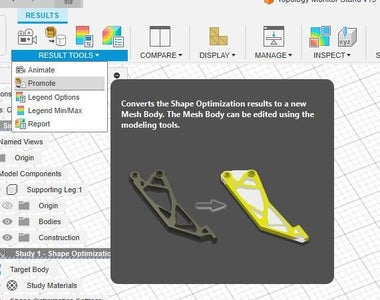

Step 7: Refining the Model

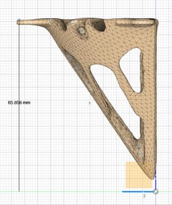

Having successfully generated a mesh body, we need to refine it to improve the print quality as much as possible. First, use the Smooth feature to improve the mesh quality.

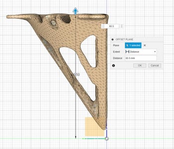

Since excess material protrudes above the mounting holes, we must remove it to ensure the leg sits flush with the top plate. Use the Inspect tool to measure the distance from the base plane to the top of the mounting holes. Then create an offset plane slightly under that height.
We can then use a plane cut on the offset plane we just created, fine-tuning the height of the cut using the numerical input fields.
After you cut the top flush, you need to combine the face groups. This can be done with the combine face group feature. Simply select the main body and all other faces and combine them into a single mesh.
Finally, you can use the repair feature to smooth out any imperfections. Once you are happy with your mesh, just right-click on your mesh body in the component browsing tree and hit save as mesh (this will save it as an STL for 3D printing).
