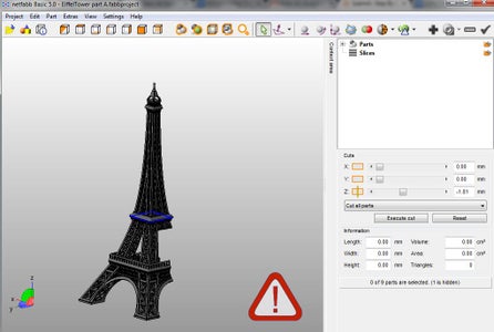

Step 2: Cut and Export on Netfabb
Use the free version of NetFabb : Netfabb Basic, to import your piece.
-Rescale it to the size you want it to be at the end.
-Use the Cuts option to slice portions of your model so that the tallest piece doesn't exceed the overall dimensions of your 3D Printer's Build Plate. (In my case, 15cm high)
-Export every single piece separately. You can save time with if you notice parts that are symetric or if they repeat themselve. In this case, export only one.
-Import the parts separately on your 3D printer's software, like MakerWare and orient them so you use a minimum of support.
-Send to the 3D Printer.
