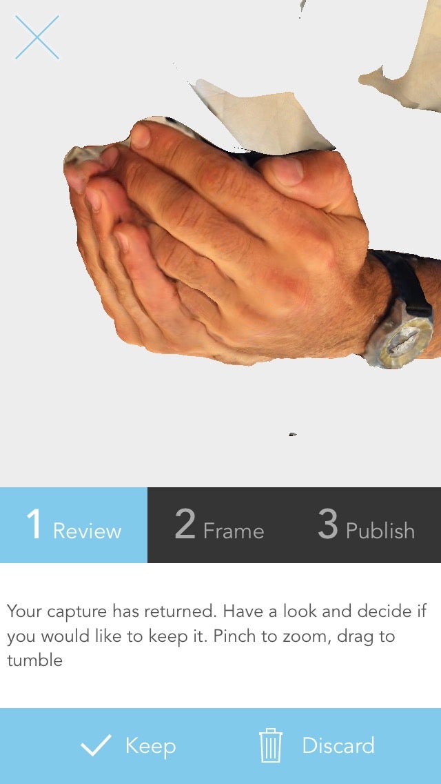

In order to get the shape of hands, I used Autodesk's 123D Catch software to capture the geometry. Even though there are more advanced scanning technologies at the Pier, this worked exceptionally well.
Once the raw data was on my computer, I began modifying it to prepare it for creating the critical spherical geometry and making CNC toolpaths, which I needed to do with Autodesk's engineering software, Inventor.
This turned out to be a kind of crazy hodge-podge workflow of strategies I cobbled together from around Pier 9 to turn my 123D mesh data into a solid model that I could edit in Inventor. That process is documented in a separate Instructable.
