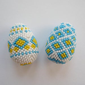

Introduction: Using Beads and Geometry to Decorate Eggs
About: Always making something....
Seed beads are close to my heart, they're one of the first crafty things I ever got into.  They're incredibly versatile, and in this case pretty festive, too.  They work well with math, a lot of common beadwork stitches are influenced by fractal-like increases and, in this case, I'm working with the relationship between hexagons and circles.  (Is there a special term for that relationship mathies?  I couldn't find anything easily with google!)
Don't let the tiny beads intimidate you.  Start with small eggs and work up to larger projects.  I make up my patterns as I go, but you could also make up a chart and plan that in advance.

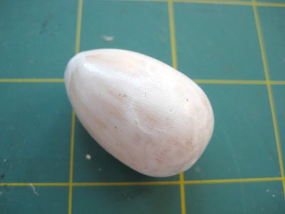

Eggs - wood are nice because they're sturdy.  Base coat them to match your beads.  Plastic would work, real are kind of risky (though pysanky people use real eggs, so it works for them!)

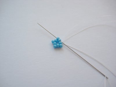

String on 5 beads.  Run the needle through those beads again to make them into a circle.  Pull it up snug, leave a few inches of tail (enough tail to put a needle on later.)

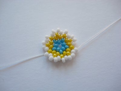

On this row, add a bead, go through a bead, and repeat until you've added 5 beads.  Go through the first bead you added so that the needle is in the right place for the next row.
Add two beads, go through a bead, repeat to the end.
On this row add a bead in the 'normal' place for peyote and add one in the center of each pair on in the last row.

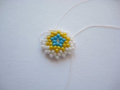

You'll want to repeat that same three row pattern - one row of ordinary peyote, one row with pairs of beads and one row with an extra bead in the center of each pair - until you reach the waistline measurement you determined earlier.  Only increase at 5 points on each row and keep those increases aligned.
At some point this will start to "cup."  Let it.  If you fight that you will have threads gapping between the beads.

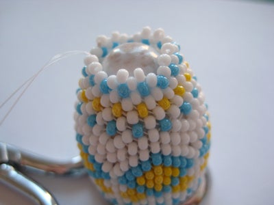

This part is kind of coasting - you just do row after row of ordinary peyote stitch for a while.  The idea is to keep doing this until you've worked to a point where your row is about 10 beads longer than the diameter of the egg.  Put the egg inside the beadwork, and as soon as you think it's safe to start decreasing do so.  You want to error to the early side because this can help pull up any slack around the egg.
Step 8: Decreasing to the Top
Decreasing is simple - it's just the opposite of increasing.  Track up from the bottom where your increases were, and at those five points around the bead just skip adding a bead - go through two of the beads from the previous row.  On the next row place one bead in the gap above the pair that are stitched together.  Since the top of an egg is much less like a sphere than the bottom you may have to add a few extra rows in between decrease rows.  If you don't like how it's working just undo a few rows and try again.  The sphere is mathematically easy to manage, the top of an egg less so.
At the top you'll find yourself with 5 beads.  Run the thread through those several times, weave the strand in through some of the beadwork and trim your thread neatly.
