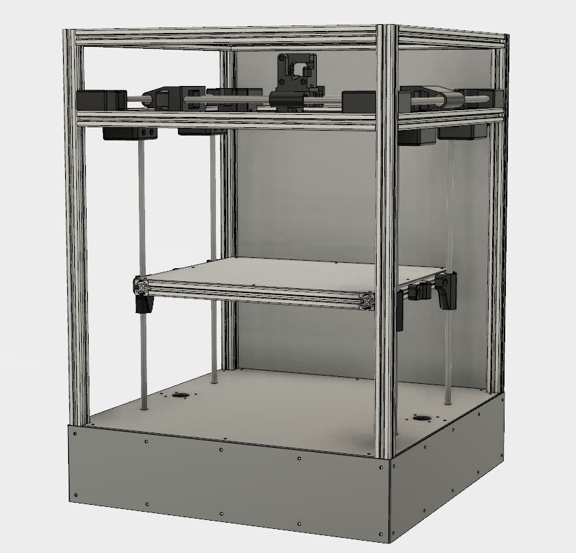

Step 4: Assemble the First Stage : Basis for the Other Stages
What you need:
-4x 40cm Aluminium Extrusions
-12x Printed Part "Corner bracket 2020"
-24x M5x10 Srews
-24x M5- T-Slot-Nut
What you make:
You put everthing together to a square and tighten everything down.
You need to repeat this steps four times, because this printer has four "Stages"

Step 7: Assemble the Third Stage: CoreXY-Movement
What you need:
Printed Parts:
- 1x "Belt tensioner"
- 1x "Idler"
-1x "Idler with endstop"
-2x "Motor"
-2x "X-End Bolt"
-2x "X-End Nut"
-4x "Z-Rodclamp"
-4x "Z-Rodholder"
Mechanics;
-2x Nema 17 Motors
-2x GT2 pulley
-1x GT2 belt
-4x LM8UU
- 2x 33cm (mm smoothrods (X-Axis)
-2x 34,7cm 8mm smoothrods (Y-Axis)
-16x 624zz Bearings
-20x M3x 20 Srews
-20x M3 Hex-Nuts
-16x M5x12mm Screws
-6x M5x10mm Screws
-some M4 Srews (the lenght for the Screws i cut individual from 45mm M4 Screws)
-some M4 Nuts
Electronic:
1x Microswitch
What you make:
1.You Screw the "X-End Bolt" + "X-End Nut" with some M3x20mm Screws and M3 nuts together. After that take the smooth rods in it. Then you connect the Extruder to the X-axis.
2.Now you put the Y-Axis smooth rods in the X-Ends and connect them with the printed parts "Motor" and "Idler".
3.Tighten the "Motor" with some M5x 12mm screws down, the "Idler" with some M5x10mm screws
4.Then you make the Idlers (see pictures) and tighten them down
5.Put the Nema 17 Motors in the "Motor" and tighten them with some M3x 10mm screws down.
6. Connect the belt (Help: CoreXY)
Step 8: Assemble the Last Stage: LED-Light
You just take the step from step-4 and insert the LED-strips in the extrusions.

Step 10: Put the Stages Together
What you need:
-4x 60cm Aluminium Extrusions 2020
- Printed Part " Z-Axis LM8UU Bolt"
-Printed Part "Z-Axis LM8UU NUT"
-Printed Part "Z Axis M8 Nut"
-8x LM8UU
-16x M3x20mm Screw + Nuts
-4x 36cm smooth rods
-32x M5x10mm
-32x M5 T-slot Nut
-2x Axis-Coupler 5mm to 8mm
-M8 Threated Rod
What you make:
1. You screw the first Stage with 8 M5x10mm Screws to the 60cm extrusions together.
2. Then the Z-Axis Stage
3. After that you put two LM8UU Bearings in the "Z-Axis LM8UU Bolt + Nut" and screw them with 4 M3x20mm srews down. Repeat this Step four times
4. Then you connect "Z-Axis LM8UU Bolt+Nut" to the Z- Table
5. Now you screw the CoreXY Mechanics to the Frame and insert the 8mm 36cm smooth rods
6. Now you put the Z-table on the Z-smooth rods

Step 16: Vulcanus V1 Rework 2016
(If you can't see the interactive 3D model above, its probably because you're not using a WebGL-enabled browser, or you're using the Instructables Mobile app)
Here is the new Vulcanus V1 Rework 2016 edition. I improved allmost every single part of this printer for a more profesionell look. Also the belts are not rub to eachother. You can tension every belt individually.
Features
- the belts don't rub to eachother
- you can tension the belts individually
- the maximal print size in X&Y is now 25x25cm ! by a footprint of 44x44cm
- the extrusion sizes are the same as in the Vulcanus V1, so you can easily change to the new files
Additionell parts for the conversion:
- longer smooth rods in X/Y: 2x [8x350mm] & 2x [8x365mm]
- 16x F624zz Bearings Aliexpress
- Longer GT2 Belt as in the Vulcanus V1 2x [2m GT2 Belt] Aliexpress
- Some screws M3 ; M4
Here you can download all required files for the Vulcanus V1 Rework 2016:
.f3d is for Fusion360
.step is for other CAD programms
