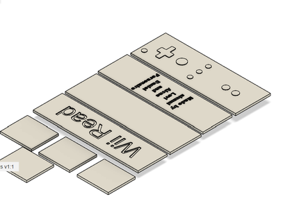

Step 2: Putting the Ideas Together

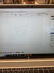

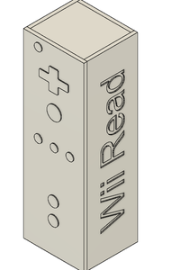

We used Autodesk Fusion 360 to help us design and figure out any problems for our bookshelf. For the buttons we designed them on the software Light Burn.

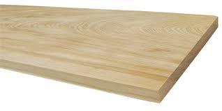

Step 3: Cutting Out the Wood
Cut the Birch wood to the correct sizes. You will need:
  • 54" X 18"
  • 54" X 16"
  • 16" X 14" (4 of those)
  • 54" X 15" (2 of those)

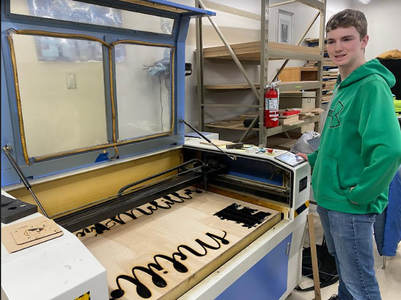

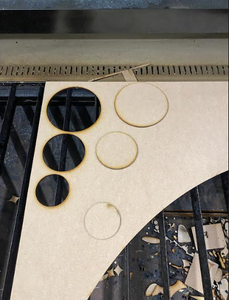

Step 4: Making the Buttons
Laser Cut out the buttons from the Maple MDF.
Use fusion 360 or Lightburn to make the buttons. You will need:
  • power button
  • + button
  • - Button
  • 1 Button
  • 2 Button
  • Home Button
  • A Button
  • The big X thing in the middle

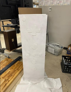

Step 5: Apply the Buttons to the Door
Glue the buttons to the door (the 54" X 18" piece)

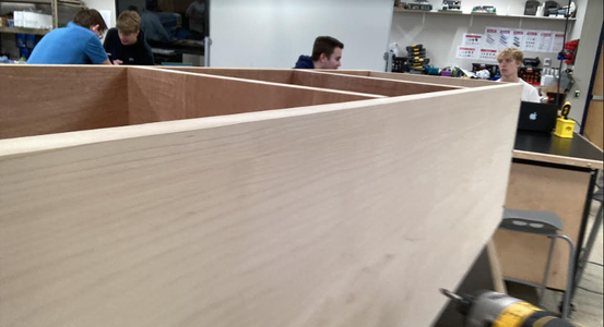

Step 6: Screw It Together
Screw the wood together. Follow the picture.
Step 7: Fill in Any Holes
Use wood filler putty to fill in any accidental holes. Let dry and sand.

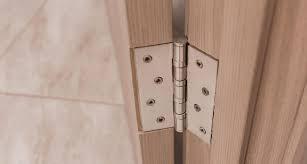

Step 8: Attach the Door With Hinges
Attach Hinges

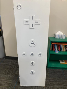

Step 9: Paint
Paint the whole thing white, with two coats.
Step 10: Paint the Buttons
Use the grey paint to add details.
