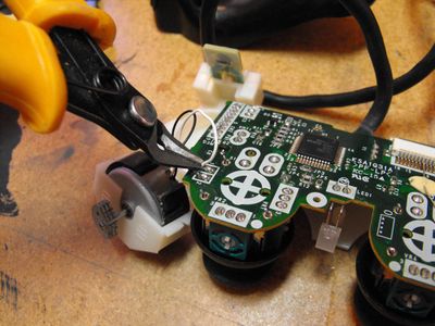

Step 3: Remove the Motors and Their Supports
We'll need some space to add electronics to the control so the motors gotta go!
  1. Using a pair of flush cutters, clip the two wires leading to each motor. Cut these wires as close to the circuit board as possible, we don't want them hanging loose.
  2. Remove the motors and, with the same set of cutters, snip away the plastic supports that held them. The plastic in my control was surprisingly soft and it was very easy to cut it down.

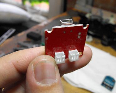

Step 5: Trim the LiPo Charger to Fit
In its natural habitat the Sparkfun lipo charger board would not normally take shelter inside something as cramped as the PS2 control. However, in times of crisis this little, red board can shed access body weight and nestle itself quite snugly within the control's crannies.
  1. With a rotary tool and a cutting disk, grind through the board removing anything that isn't part of the circuit. The pictures show were these cuts should be made.
  2. Straight from the factory this lipo board is configured to charge at 500mAh, that's too high for battery small enough to fit inside the control. However, the board's charge rate can be changed to 100 mAh by cutting a pre-existing jumper on the board and soldering a jumper between the center pad and the "100mA" pad to lower the charge rate.

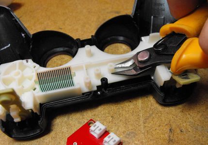

Step 6: Cut Plastic to Make Room for the Charger
With the charger trimmed down to it's bare essentials it can fit just barely inside the control, but to do so a little modification to the plastic frame is needed. With care and finesse the charger will press fit perfectly into the plastic and won't need any glue or screws to stay in place.
  1. Disconnect the circuit board from the frame by gently pulling the flexible ribbon cable free of its connector.
  2. Set the charger on top of the white frame and mark where the cuts need to be with a sharpie.
  3. Flush cut the frame until the body of the charger fits inside, or rather fits as best it can without a hold for the USB plug.
  4. With a sharp x-acto knife*, mark the black shell along the outside of the USB connector. Use the knife to shave away the black plastic until you have a rectangular hole that the USB can fit through.
  5. To test the fit, put the two halves of the shell back together with the charger inside. The outer casing needs to fit together snugly, just as they did before they were modified.
Step 7: Add the Charge Indicator LED
The charger includes an option to add your own LED charge indicator. This LED will light up while the board is connected to a computer (or other power source) via USB cable and the battery is being charged. The light will turn off when the battery is fully charged.
  1. Solder a few short wires to the end of the LED and cover the connections with heat shrink tubing.
  2. Solder the free ends of the wires into the appropriate thru-holes as marked in white on the board.

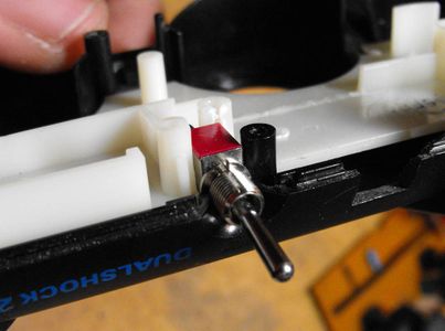

Step 9: Cut the White Plastic for the On/Off Switch
Use an exacto knife to cut notches into the screw posts so that the micro on/off switch fits snugly inside the control. When the case is put back on the switch will not need any glue to stay in place.

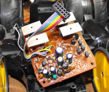

Step 16: Trace the Motor Driver Circuitry
I'm still learning how things work but fortunately I recognized what was going on inside my RC. Like most inexpensive RC toys, my car uses an H-bridge to control it's motor. H-bridges consist of four transistors (or MOSFETs) and, given that they are handling the drive motor current, are usually the largest transistor looking part on the circuit board. Additionally, they pretty much always have some heat sinks attached as driving all that current makes them get seriously hot.
To find which traces of the circuit board are controlling the H-bridge I first examined the PCB and found the traces that connected the H-bridge transistors and the main microcontroller (chances are that the trace will go to a resistor first.)
In this case there are four wires coming from the H-bridge going to the microcontroller on the board. Each of the car's two motors is controlled by two of these wires. One of the wires for forward, the second for reverse. When 9v (the car's working voltage) is applied to one of these wires it turns on its respective motor in either direction.
Step 17: Remove the Car's Brain
I don't know exactly what chip is controlling this RC car, and I don't care. Identifying ICs in commercial products can be difficult sometimes and even if we were to try to find out exactly what the main chip is, chances are it would be a microcontroller with custom code that we don't have access to. It's just easier to rip that sucker out so I can add my own chip with my own code.
The easiest way I've found to remove ICs (if you don't want to save them) is to use wire cutters to clip all of the chip's leads from the top of the circuit board. Then I'll use a spring loaded solder sucker and soldering iron to suck up the loose leads from the bottom of the board. Quick n' crude but it gets the job done.
Step 18: Tap Into the RC's H-bridge
Now that we've removed the IC that was driving the H-bridge we can add some jumper wires to the board. These jumpers need to connect to the traces that go the the bridge. Later we will connecting these wires to our circuitry with a breadboard.
