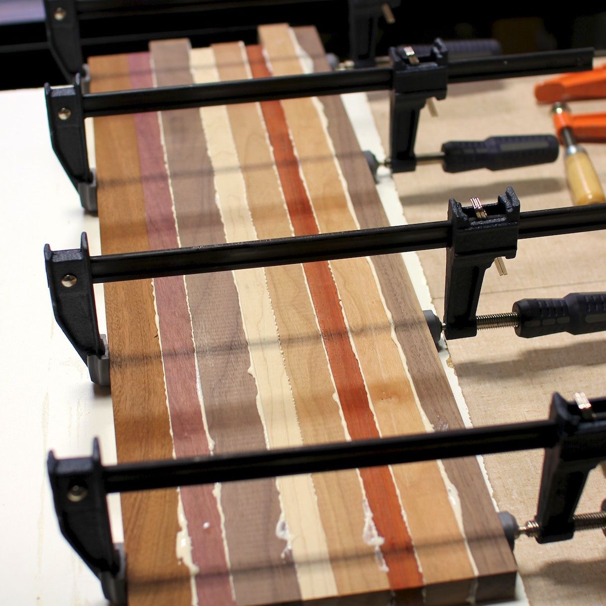

When you clamp wood together, a sure sign of a successful bond when glue begins to bead out of the joint. That thin bead of glue does need to get cleaned up since wood glue can discolor wood, and affect the way stain is absorbed by the wood grain. Removing excess should be done first mechanically, I like using a silicone knife, then wiping it off with a lint-free cloth, then a quick pass with a damp sponge to remove any remaining residue. Glue residue can dry very quickly, so time is of the essence.

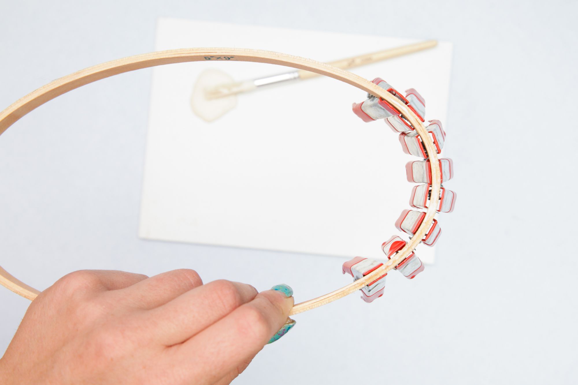

Clamping of wooden parts is cause for creativity. It all depends on the scale of the parts you are applying to glue. I work most frequently with spring clamps to make small repairs, but sometimes band clamps or long bar clamps may be necessary. Be sure to clamp parts perpendicular to glue lines so that air is being squeezed out as surfaces are mated without parts slipping.

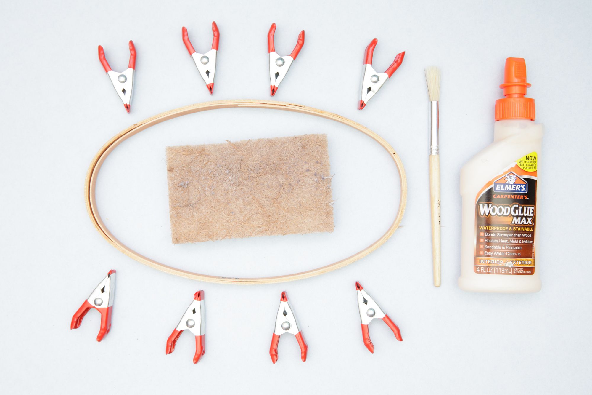

Materials needed for this repair

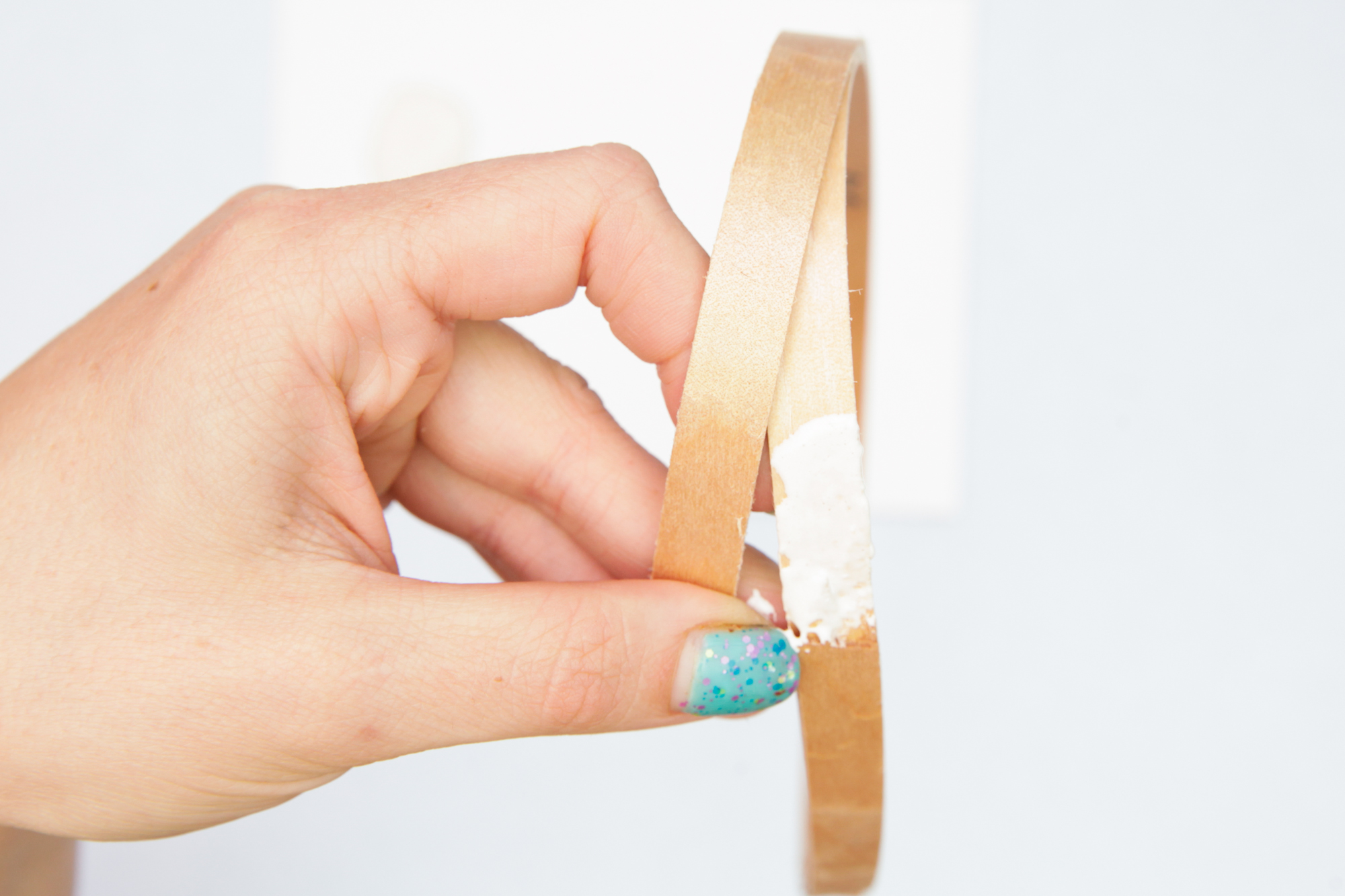

Pry the split open as far as possible using your hands, or a leverage tool if necessary.

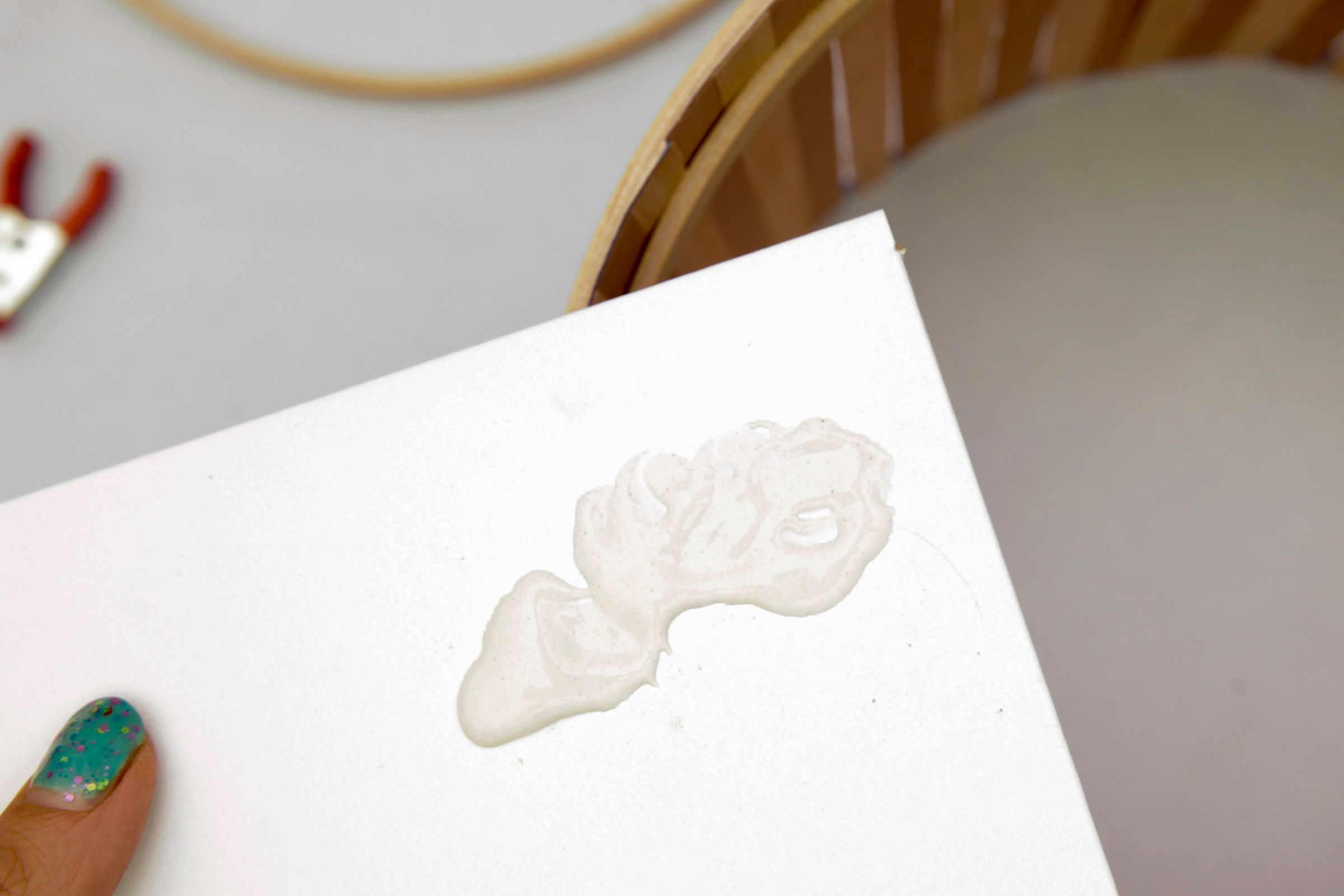

Inject glue into the split using the tip of a glue bottle, or an applicator. If you really want to get precise amounts of wood glue in between pieces, you can use one of these nifty squeeze applicators. For this repair, I only needed a brush. Try and get the adhesive as deep into and between your parts as possible.
Place clamps across the wood perpendicular to the split, until glue oozes out. Wipe off the excess glue with a barely damp sponge. Allow the glue to dry overnight and remove the clamps.

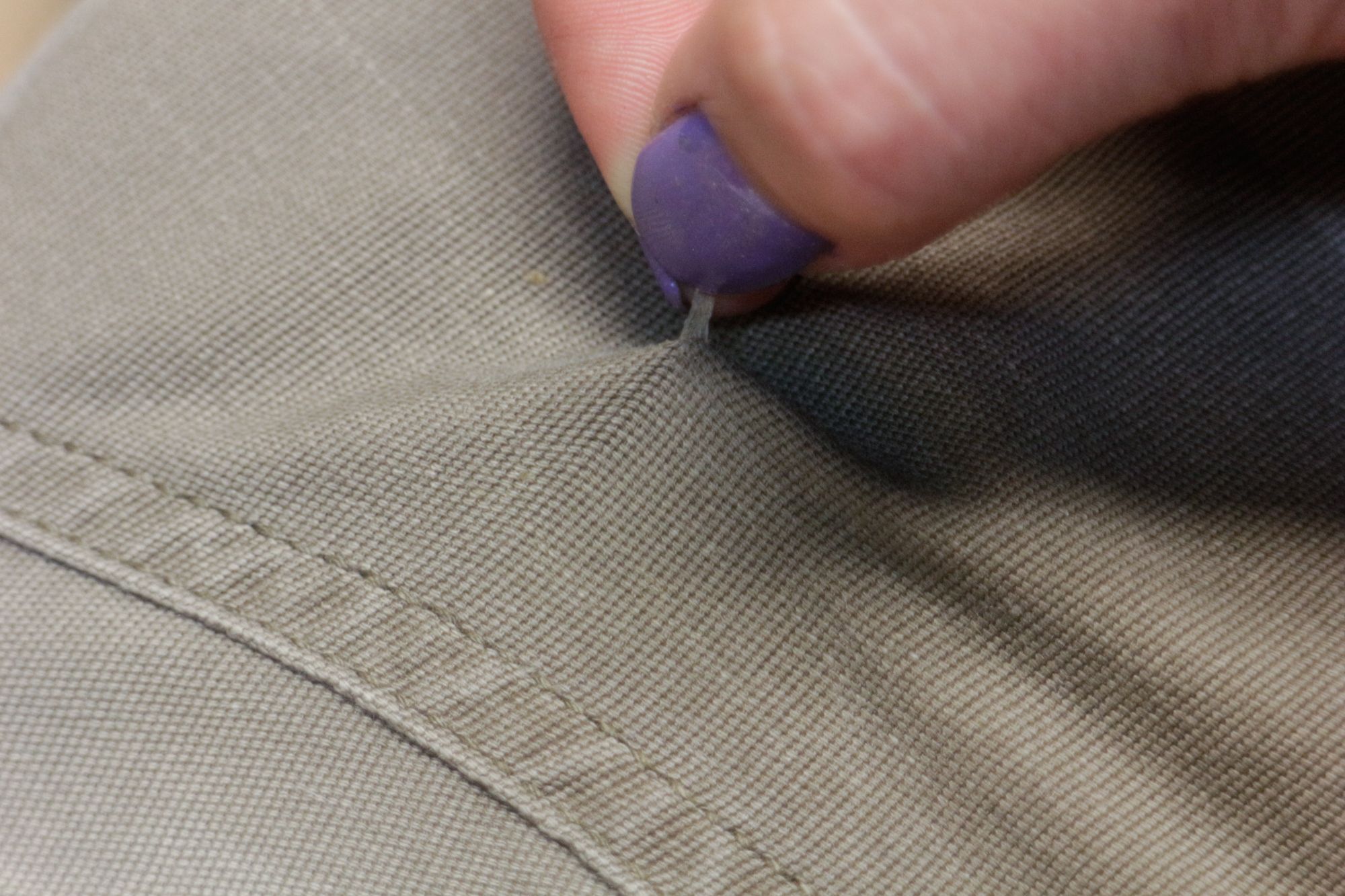

Getting wood glue out of clothes can be a real drag. Since it is water based, you catch it quickly to minimize damage.
Begin by soaking the garment in a hot water bath to see if you can lift the stain. Remove as much uncured adhesive as possible by blotting it with a warm damp rag. If there is remaining glue residue, try soaking in a diluted white vinegar solution. Vinegar can cause colored clothing's dye to run, so always test for colorfastness first.

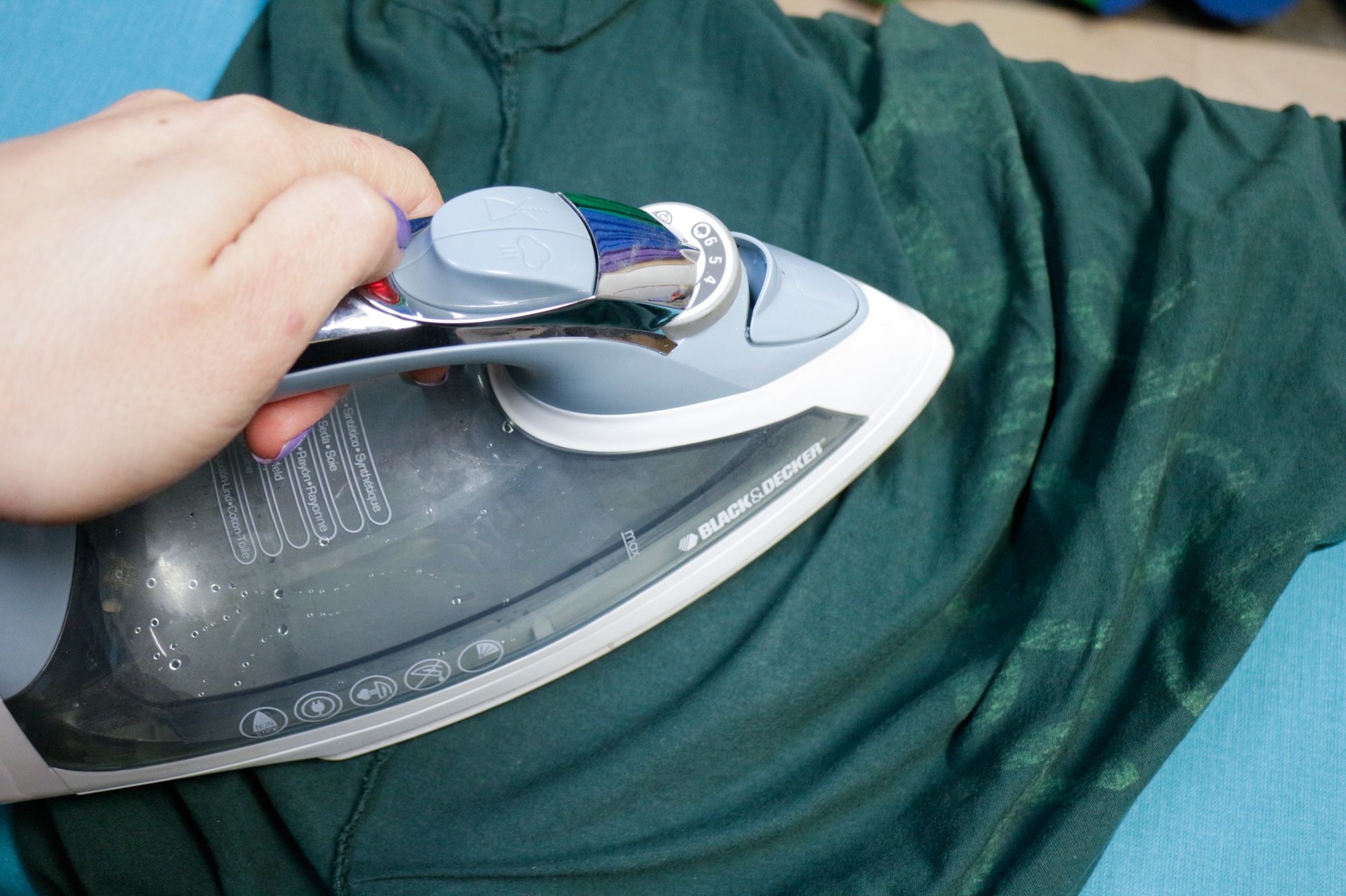

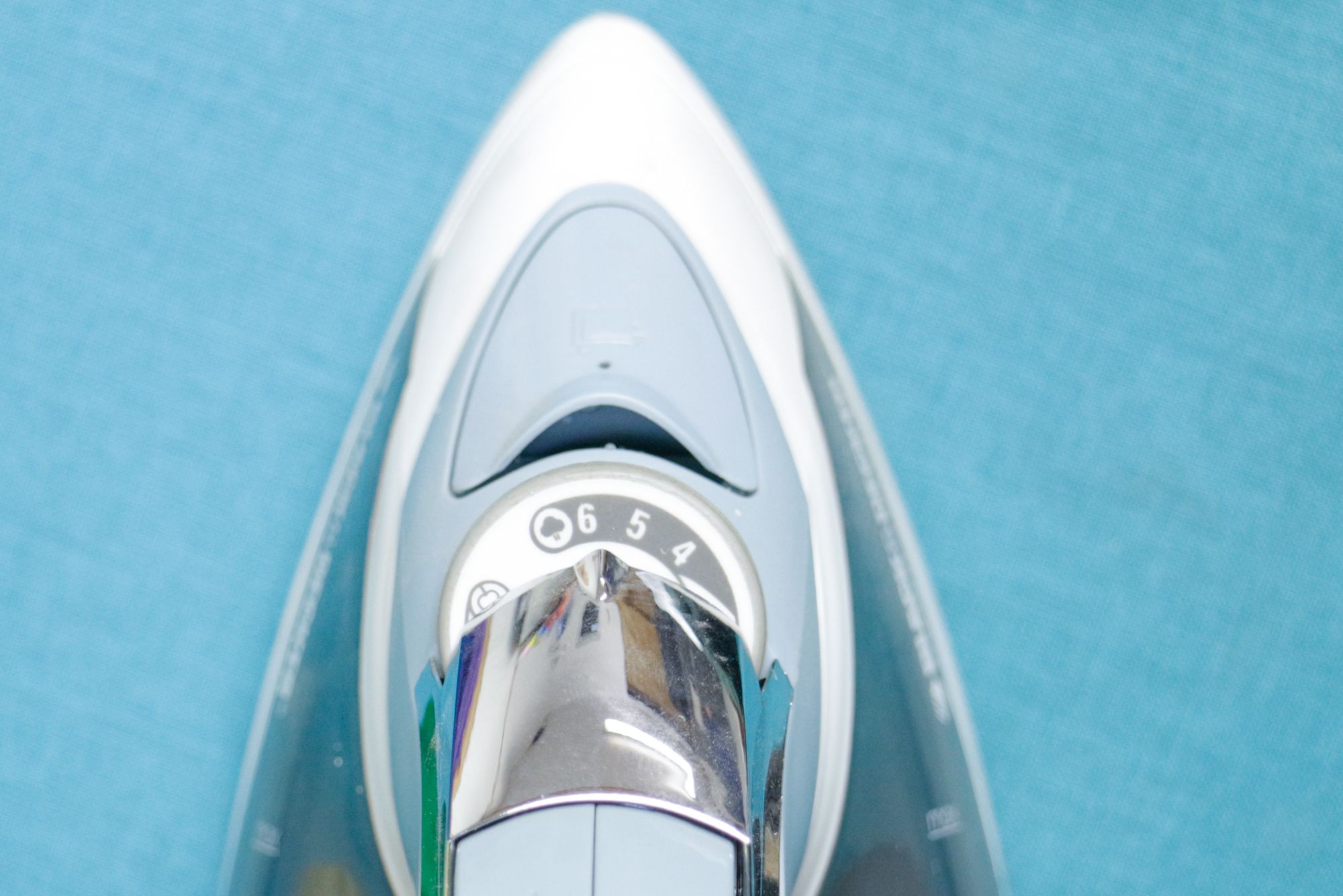

For removing cured adhesive, you'll have to use an iron to melt off the glue residue like we did previously for the fabric glue and hot glue class. (links coming soon) Lay down a sacrificial cloth under your garment, so that the glue stain's face is on the scrap cloth. Heat the dried adhesive with an iron so that the glue melts into the rag. Repeat if necessary.
If the glue stain is really pesky, turn your iron to steam mode - the steam will get in between the fibers and help lift the glue from the garment. Only certain fibers can handle being blasted with steam, so be sure to test in a discreet area first.

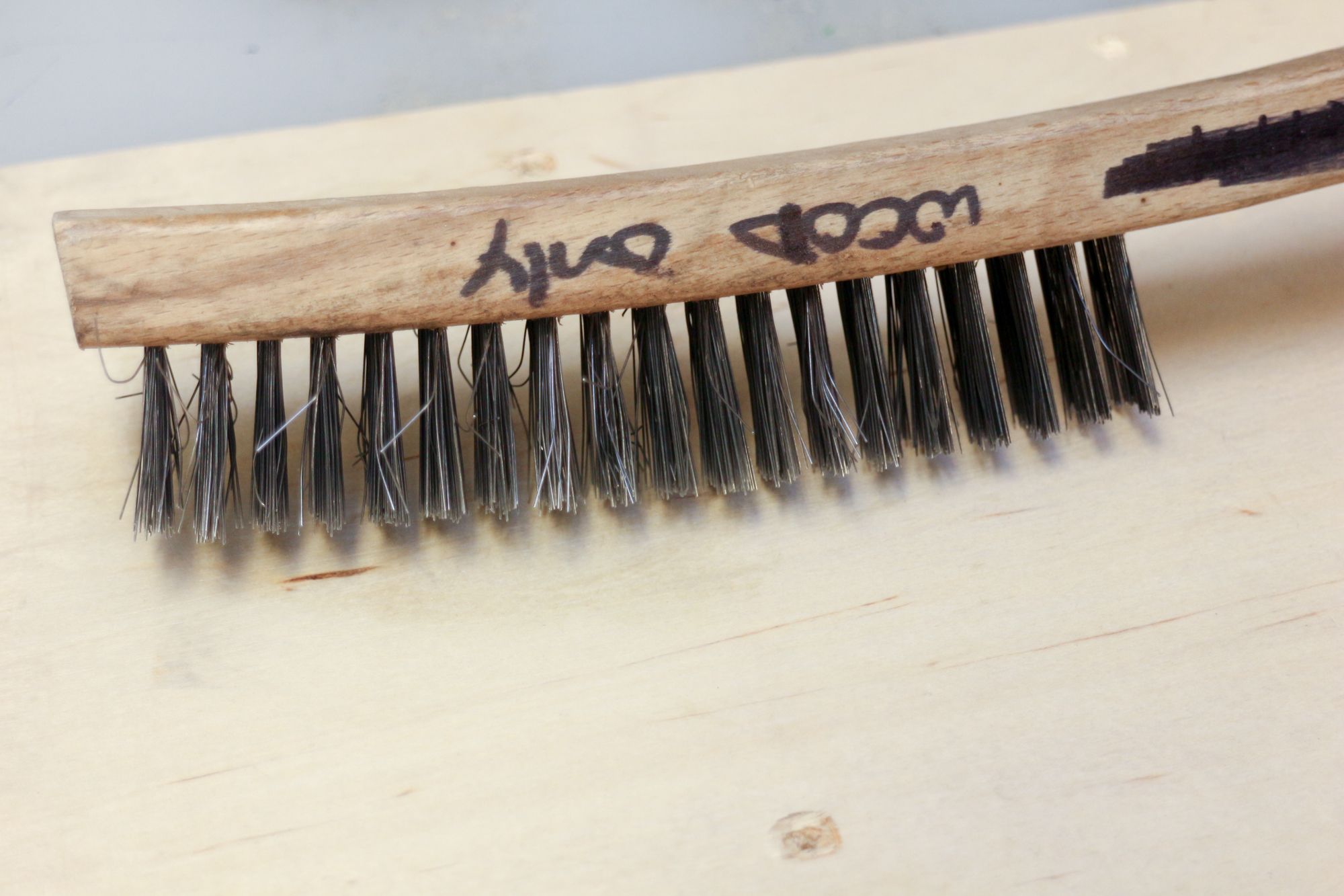

After the glue has been softened with a solvent, try using a wire brush to scrape up the glue. If that doesn't work, allow the solvent to evaporate completely, then sand off the glue.

Check out this Instructable that turns an embroidery hoop into a band clamp to create a surprisingly posh lampshade.
