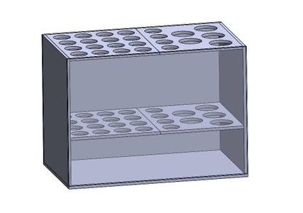

Step 1: The Design
Here is the basic design for the wrapping paper holder. It is just a box with two boards with matching holes in them. I chose two boards to help keep them upright but you could get away with just the top board with the holes.
The measurements on here are for a 23 7/8 x 14 holder that is 17 3/8 inches tall and uses boards that are 3/8 in thick. Again, modify these dimensions to meet your need.

Step 3: Cut the Holes
Now it is time to put the holes in the boards. Everything I could find online mentioned having 2 1/4 inch holes for wrapping paper. I made 20 holes at 2 1/4 inch diameter but I added 5 additional hole at the back that are 3 inches in diameter for any larger rolls we may have.
As I mentioned before, I uses my CNC router to cut the holes but you can just mark out the hole positions you want and use a hole saw to cut them out.
Just make sure that the hole boards you make for the top and bottom match one another so the holes will be aligned when assembled.
