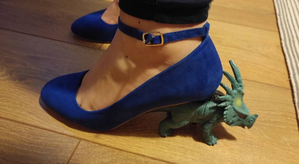

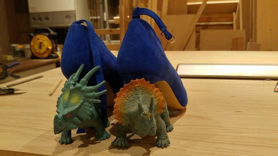

Step 1: Materials + Concept
The idea is to replace the standard fluted heel with a slender support post, then hide that post with a hollow plastic dinosaur. This will give the illusion that the dinosaur is holding up the shoe. To keep this project accessible I used very basic components.
Dinosaurs: You will need to find dinosaurs that are roughly the same size as the heels you want to replace. My local Dollar Store had an entire bin of appropriately sized dinosaurs for me to choose from. Dilophosaurus worked best for me.
Shoes: I chose a crocodile skin texture for my shoes, as it looked the most dinosaur-esque and matched my dinosaurs
Bolts: Any 1/4" bolt will work. I chose these u-bolts to experiment with, but ended up not using the u-bend like I had thought and just cut them straight.
End Caps: I needed to protect the end of the heel spikes from damaging any floor surfaces when walking. I tried to reuse the old heel caps but they just didn't work with my new design. I found that the plastic caps found on spring soorstops fit perfectly and are made from a thick, tough plastic. Perfect for this application. And, if they ever get worn out, they are easy to replace.

Step 4: Heel Welding
Welding:
The original heel for this shoe had a wide flange at the heel which helped support the width and weight of the heel and foot. This new design calls for a slender, uniform heel spike and will require a platform to support the wearer's weight in lieu of a wide flange like the original.
A small heel platform was made from scrap 1/8" sheet steel. I used an angle grinder to cut out rough rectangles, then rounded the corners until I had a platform that fit inside the insole. The platform was then welded to the steel shank.
The 1/4" stainless steel bolts were then lined up and tacked in place to ensure position was correct. While the bold is tack welded on is a good time to make any minor adjustments to the angle of the bolt. It helped to put the insole and shank back in the shoe with the tack weld to ensure the heels are perpendicular to the ground. When alignment is ensured, weld the bolts in place for both shoes.
Cut heel spike to length:
After welding the insole and shank was put back into the shoe with the dinosaur placed along side. The heel spike was then cut to be about 1/4" longer than the height of where the dinosaur back will meet the shoe.

Step 5: Dinosaur Placement
After welding it's time to decide our dinosaur placement. I lined up my dinosaur under the heel of my shoe with the underside of the heel resting on the back hump. Looking down from the top of the shoe into the opening, I marked on the dinosaur where the sole and dinosaur met. Then, using a 1/4" bit, drilled a 1/4" opening through the dinosaur.
Getting the angle and exit point correct on the dinosaur was difficult. I picked up an extra dinosaur that I made several openings through until I got the angle I was looking for, then transferred those locations onto the other dinosaurs.
