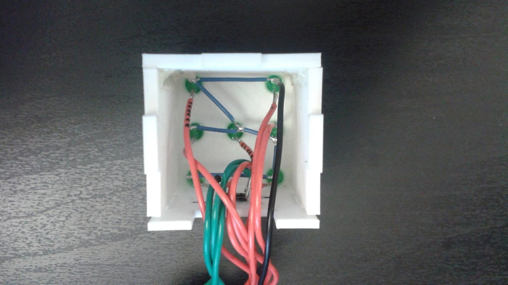

I started by placing all of the LEDs and soldering their connections. For the housing I printed, the LEDs fit perfectly in the holes such that they stayed tightly in place without any glue. Depending on your printer you may need a little bit of glue to help them stay in place.
For soldering the LEDs, it is very importantthat the LEDs are connected with the correct orientation. The anodes of the LEDs will be connected to the digital I/O pins of the microcontroller, and the cathodes of the LEDs will be connected to Ground.
As you can see in my picture, I connected all of the cathodes together with blue wires. Ground connections do not have to be specific, so we can connect all of the cathodes together and then connect that group to ground with a single wire (the black one in the image). This makes it a lot simpler then having seven separate ground wires. After connecting all the cathodes together and to a single ground wire, I connected a separate wire to each of the anodes of the different LEDs. These are the red wires in the picture. As you can see, I used a marker to put some tally marks on each one. This makes it easier to keep track of which wire will be connected to each pin of the microcontroller.
Next, I put the button in the square hole of the front panel. This required a little bit of hot glue on the back to hold it in place. The picture above doesn't show my nicest looking work, but when we put the cube together this side won't be seen.
Recall from the schematic that only 3 of the 4 pins on the button are connected. One is connected to ground through a 220Ω resistor. Another pin is connected to the microcontroller's 5V power source. The other pin is connected to pin 26 of the microcontroller. Pin 26 reads whether the button has been pressed or not. You can see how I soldered the wires in the picture above. Notice that I labeled the wires with one dot, two dots, and a dash. This is to keep track of what wire goes to which pin on the microcontroller. One dot is for the wire that goes to pin 26. Two dots is for the wire that connects to the microcontroller's 5V supply. The dash is for the wire that connects to the microcontroller's GND.
For the 220Ω resistor at the ground connection, I just put one end of a resistor into the end of my connector. The exposed pin of the 220Ω resistor will be connected directly to the GND pin of the microcontroller. If you aren't using MTE cables like I am, you can just solder a resistor to the other end of your wire.

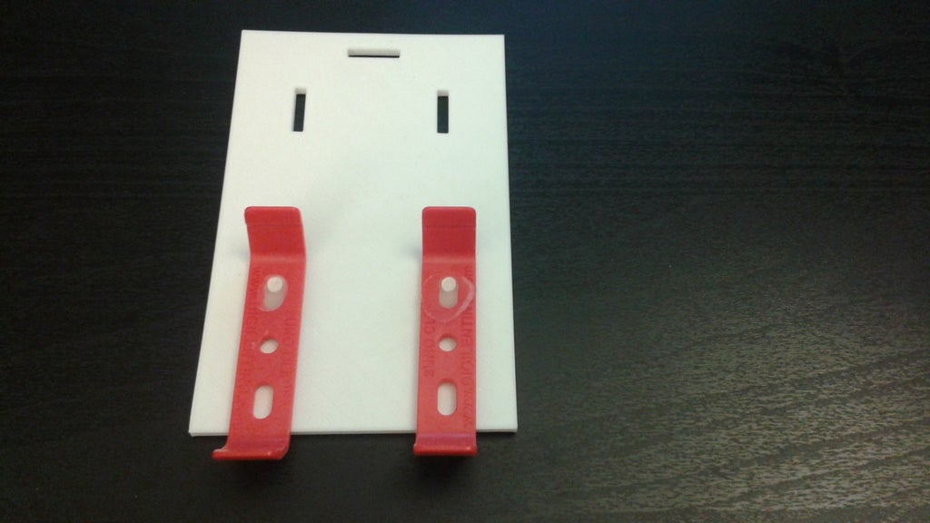

The next step is to attach the zUNO clips to the base. The holes on the zUNO clips were a little too big for the pins on the base, but a little bit of hot glue over the joint makes it fit well and stay in place.

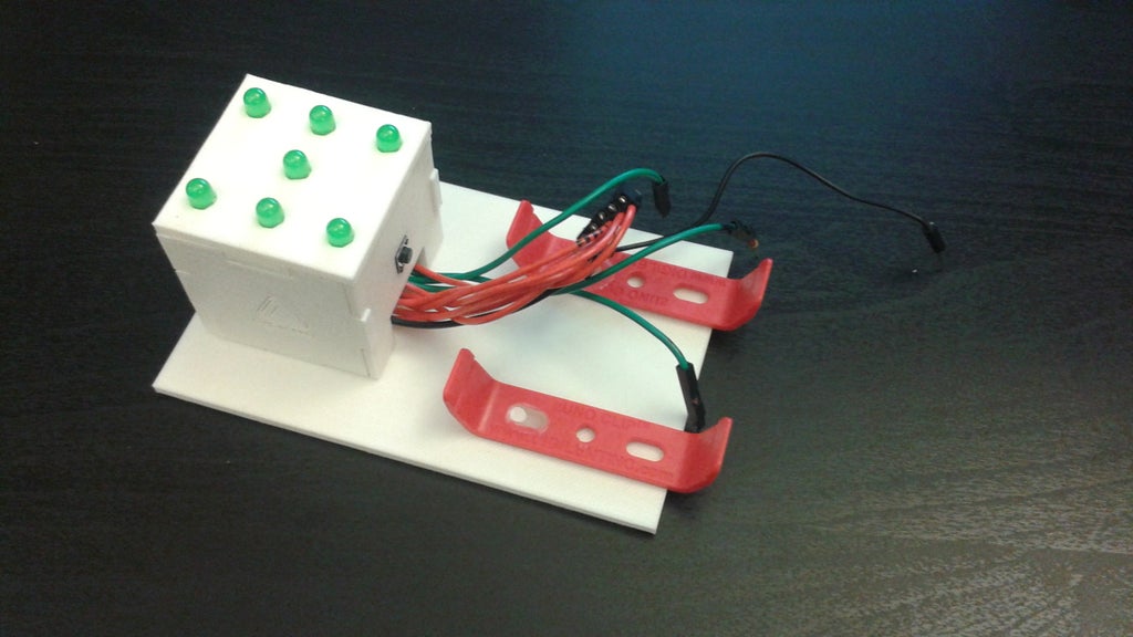

Now let's put the whole cube together. Use glue as necessary to hold the sides of the cube together. Also try to keep the wires lined up nicely so they will all be coming out of the front panel when we place the cube on the base.
All that's left now is to put the cube on the base! I didn't need any glue to hold the cube in place because the cube fit into the holes of the base perfectly. But use glue as needed to keep the cube attached. The final result is shown below! Move on to the next step to see it in action.
Step 5: The Final Result!
Lastly, mount the microcontroller onto the zUNO clips and plug in all the wires.
The pin numbers that each wire needs to connect to is shown in the code in step 3, but to review:
- The LEDs are connected to pins 27-33.
- The ground wire of the LEDs is connected to the microcontroller's GND.
- The wire that carries the button's state (whether it's been pressed or not) is connected to pin 26.
- Another wire of the button is connected to the microcontroller's 5V supply, and the button's last wire is connected to the microcontroller's GND through a 220Ω resistor..
Then just upload the sketch from the IDE to your microcontroller and it's ready to go! Check it out in the video above!
