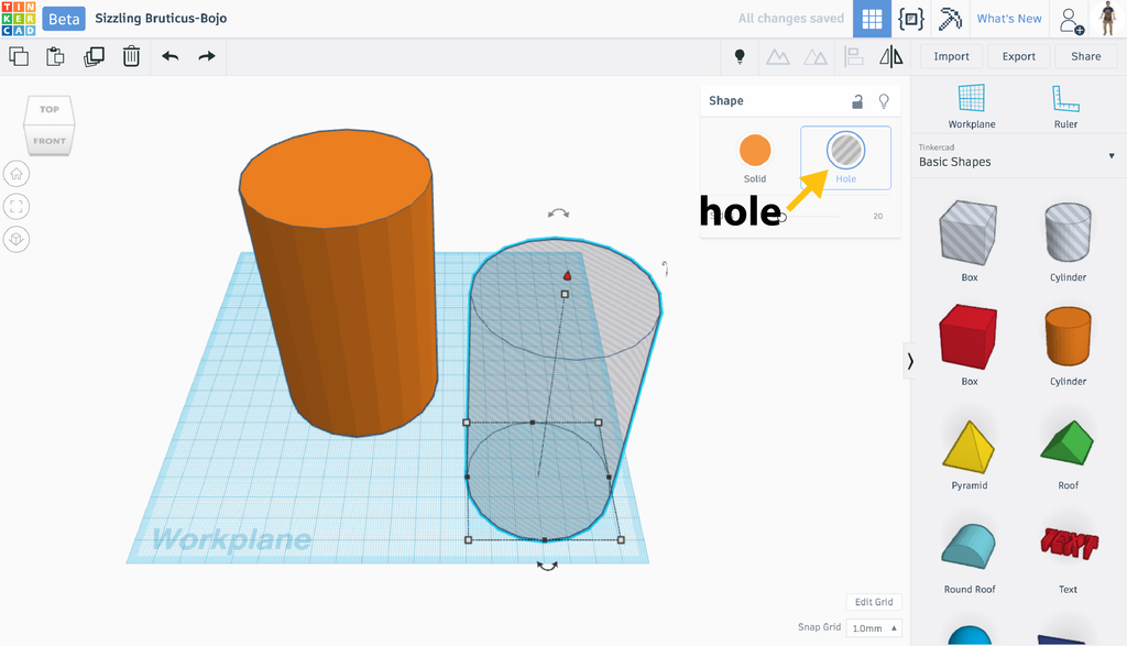

Step 3: Turn the Cylinder Into a Tube
Just like you did in the last step, place a cylinder on the workplane. This time, make it 60mm wide and 100mm tall.
With the new cylinder selected, click the Hole button in the Inspector.
To make a tube, the hole and the solid cylinder will need to be aligned. With both cylinders selected, click the Align button in the Adjust menu. Click on the first cylinder to make it the dominant object, then click one of the center align handles on the workplane.
Click the other center align handle.
Click the top handle to align the cylinders to the top plane so that the tube will be open on the top.
With both objects selected, click the Group button to create the tube.

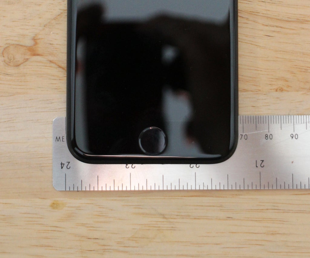

Step 5: Measure Your Phone
Around 68mm wide
Around 7 mm thick
The amplifier works by making the sound from your phone's speaker bounce off the sides of the tube. That means the tube will need a cutout at the back to fit the phone in so that its speaker is inside the tube.
To make sure the cutout will be the right size, use a metric ruler (millimeters) to measure the thickness and width of the phone.
Mine is about 68mm wide by 7mm thick.
TIP: You can also do a search for your phone model and "dimensions", and probably find the exact dimensions right away.

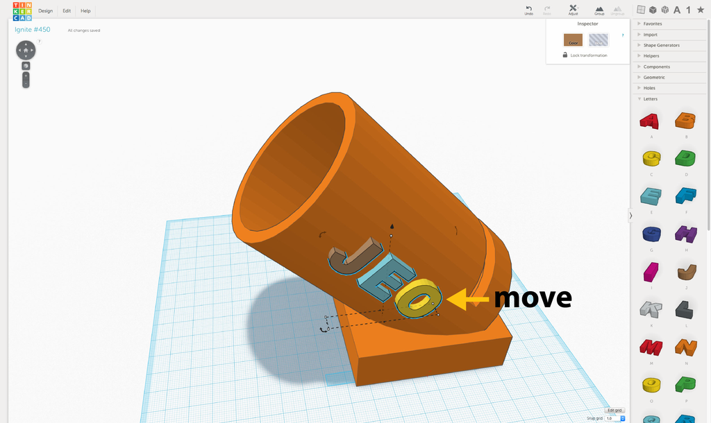

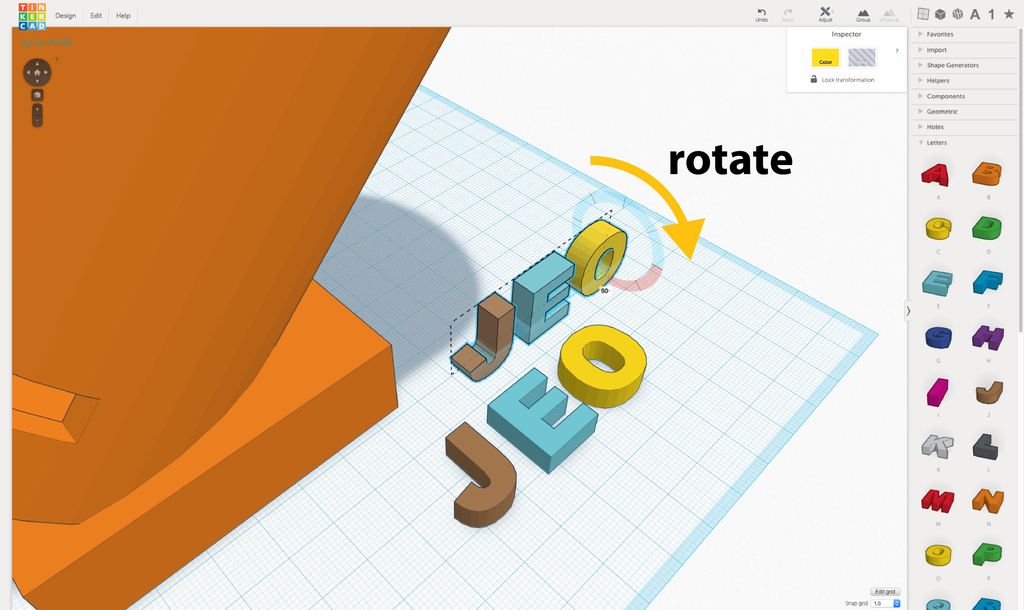

Step 7: Add Your Initials
Open the Letters pane, and drag your initials (my middle name is Edward) onto the workplane. If you need a refresher on how to get the best results using text, go back to the Keychain lesson .
Select all the letters and pull the scale handle. Hold Shift while scaling to make sure everything scales uniformly.
Copy and paste the letters so you can have matching text on both sides of the amplifier.
Rotate the two groups so that the face different directions.
Rotate both groups 45º to match the tilt of the amplifier tube.
Move the letters so that they intersect the sides of the tube.

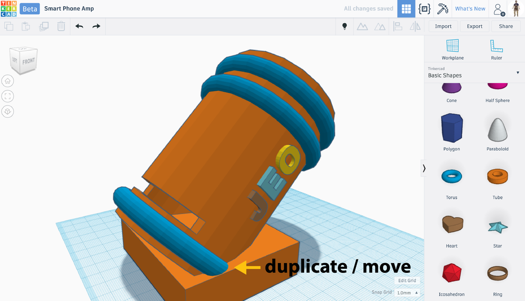

Step 8: Add Some Details
TinkerCAD has all kinds of shapes, symbols, and connectors that you can add to your design. I'm going to use the Torus shape to give my amp a vintage space-age look. If you want to make yours like mine, drag and drop a Torus shape from the Basic Shapes menu.
First, double-click the number for the Tube setting in the Shape window and change the number to "1", then press Enter. This will make your tube thickness smaller.
Next, drag the scale handle and make the torus 80 X 80.
Rotate the ring 45º as shown, then move it until it creates a ring around the top of the tube. The Align tool will be helpful here.
Duplicate the torus, then move it down and towards the back so that it creates a second ring next to the first one.
You can add a third one near the base to make it look a bit more balanced. NOTE: If you add the third ring, be sure to make a hole on the bottom to cut out the bottom of the torus. If you don't, you'll have a protruding piece that will keep the amp from sitting flat on a table!
Click the Group button to turn your amp into a single object that's ready for 3D printing.

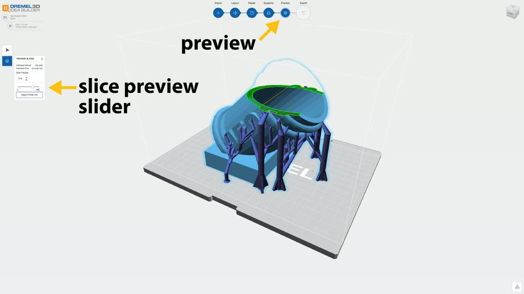

Step 10: Print Studio
Open Print Studio, then click Import. Select the STL file you just downloaded and it'll drop onto the bed.
Select the amp and you'll see some manipulator tools show up, just like in TinkerCAD.
Use the Rotate handle to rotate the amp 90º so that it's sitting flat on its base.
At the top of the screen, just follow the series of button to prepare it for printing. Click Repair, then make sure you see No Problems pop up in the window to the left. If you see errors, Print Studio will repair them for you before you go to the next step.
Next, click the Supports button, then click on Add Supports in the window on the left. Supports are like little trees whose branches hold up the overhanging parts of a model. Without them, you'll end up with a whole lot of plastic spaghetti!
With your model repaired and supports added, you're ready for a preview. Click the Preview button, then move the Slice Preview slider in the window on the left to get a preview of how your printer is going to build the model.
When you're satisfied with the model, click the Export button on the top bar, and Print Studio will make a printing file for your 3D printer based on your settings.
