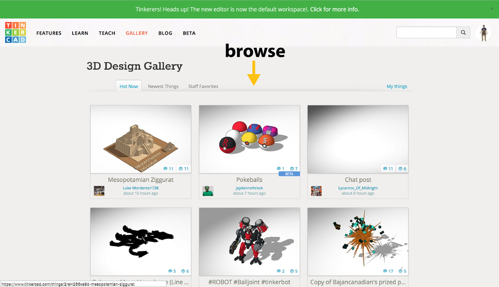

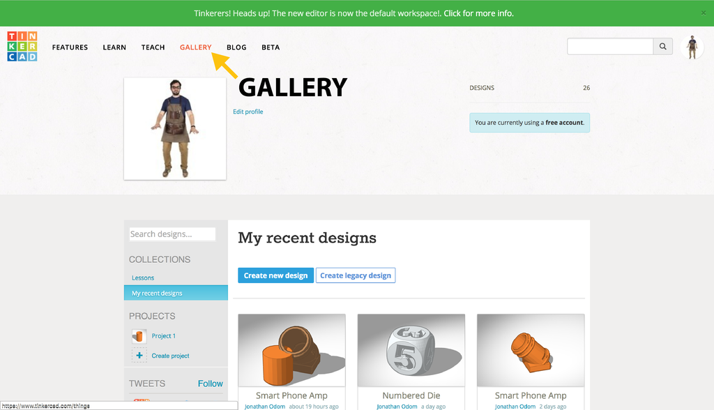

On the main TinkerCAD page, click on the GALLERY to find a cool model to try out.
You can browse by Hot Now, Newest Models, or Staff Favorites which is where I found the Mesopotamian Ziggurat model by LukeMordente1738.
Click Copy & Tinker to create your own copy of the model and save it in your own project.

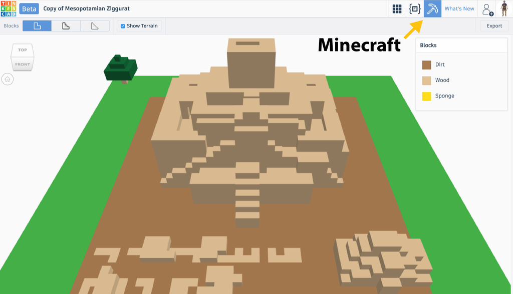

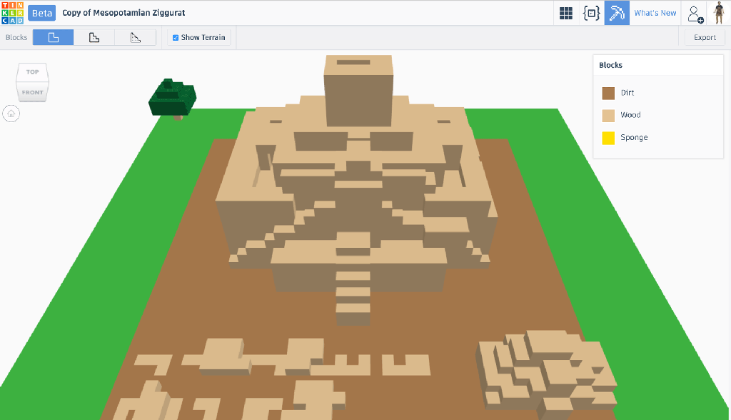

Click the Minecraft icon in the upper right corner, and you'll get a preview of what the model will look like if you bring it into Minecraft.
Click the Block Size buttons on the upper left to cycle through different resolutions.
When you've decided on a block size, just click the Export button to get a file you can import to Minecraft. Remember, the Minecraft Classhas lots of detailed information on this process, so be sure to sign up for it!
