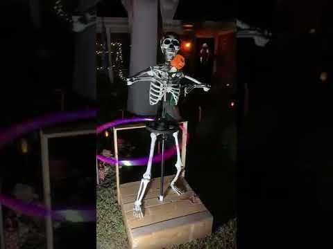

Step 6: The Rider and Lights
The rider needed support. So a conduit was placed into a hole drilled along the edge making sure there was thick enough material below. The hole doesn't go all the way through. Conduit pipe was friction fit tight, add tape if it's too loose. The rider's arm is zip tied and or taped to his conduit walking stick. His feet were screwed down too. Tighten his joints as needed to lock in his pose. I had to add a screw to his neck and one on each shoulder to keep them from moving. The legs and hips seemed ok.
Last, I added the peel and stick Led lights on the inside to give the spooky hovering effect. Access is through the hinged lid. They are 12 volt but I chose to power them with an old drone battery so there are no wire conflicts. Keeping things simple.

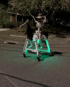

Step 7: Another Version
A few years ago I did another version as a coffin surfer. The wood was finished by burning it with a torch, then spraying Krylon clear over it. This one is spookier but also worked well. Just giving more ideas and possible options.
