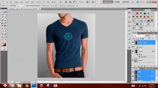

Step 2: Remove the Background If Required

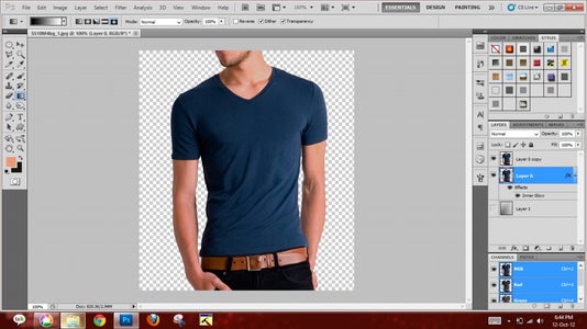

Add the Image with person and duplicate
DUPLICATING is done to have a another copy of the image if we messed  up some where
Use Selection tools : WAND , POLYGON , QUICK etc tools
>> In my case i removed the white portion behind the image
TIP : You can also have another layer(Black or white depending on image)  added behind so that u can see if every unwanted area to be deleted.

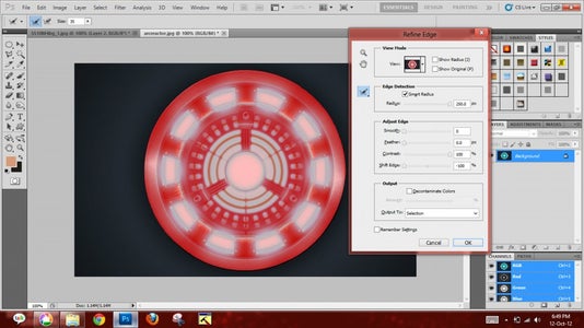

Step 3: Getting Arc Reactor

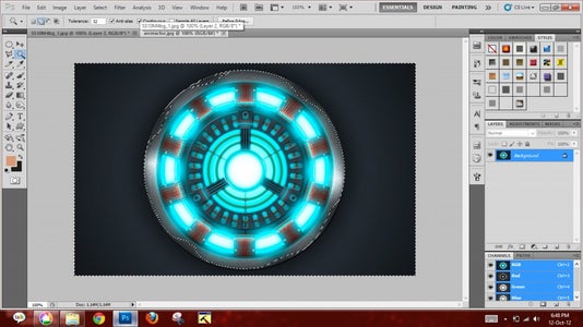

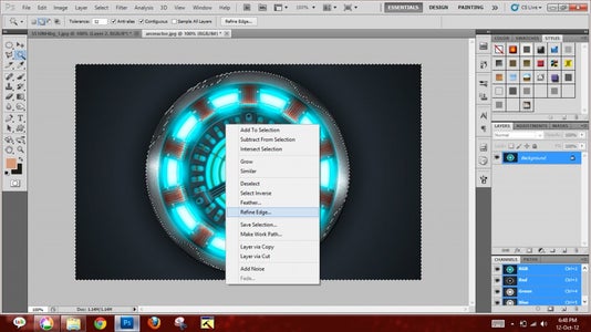

i Added Arc Reactor in new tab of photoshop

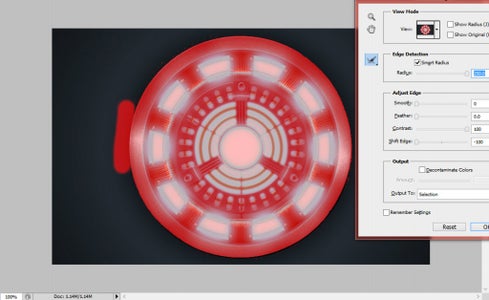

again we need to separate  the arc reactor i use selection tool to separate it.
>> right click with any selection tool and use Refine edges after having a partial selection.
>> use the instruction  on images to process it by ur self

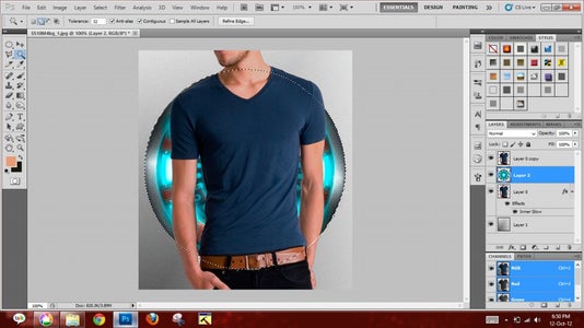

Step 4:

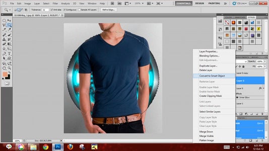

CTRL + V or paste it in the layers ,
You get Another NEW LAYER added of the reactor
>>as seen your reactor can be below the layers
    bring it to above layer by drag and drop
>>You can also make it smart object , right click on layer  and click on convert to smart object
    Smart object when transformed with shape , do not loose details

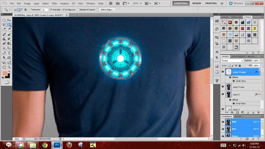

>>Select Arc Reactor and Place it right on Chest , Use CTRL + T or Edit--->Free Transform to transform the shape .
    Use SHIFT while u drag for transformation , it will not stretch image

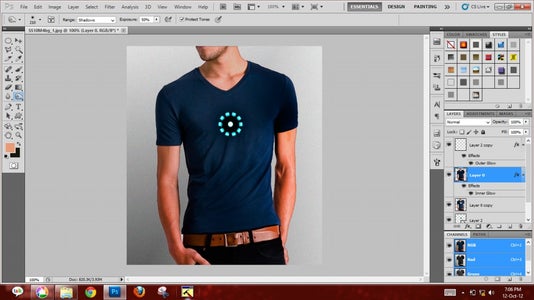

>>when pasted on chest  remove the extra parts from Arc reactor

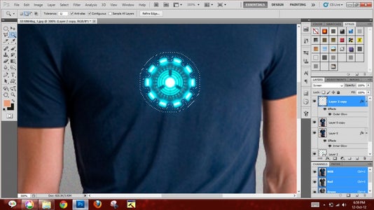

    Also used Burn tool to create darkness on the center potion on layer with person inside

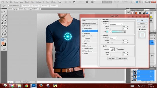

>>Double click on layer to add Blending options
    >> use outer glow with color picked up from the arc reactor and make deatils as in images of blending options,
         it gives glow effect ,,so 90 % is done

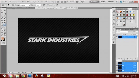

2nd pic = Get Stark Industries logo out of the image and use it as we used the Arc Reactor
