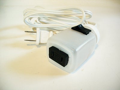

A device for those moments when Mr. Scott is "Givin' you all she's got!" and all she's got is a little too much. This is a simple inline switched 120VAC outlet with a full power setting and a 50% power setting. A half wave rectifier diode facilitates the 50% power setting.

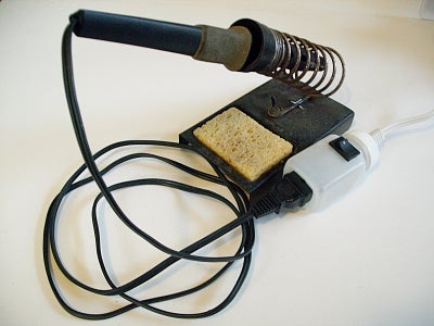

Practical Uses:
- High-Low temperature control for a soldering iron or hot glue gun.
- Bright-Dim control for an incandescent light.
Maximum recommended load for the circuit shown in this article = 100 Watts

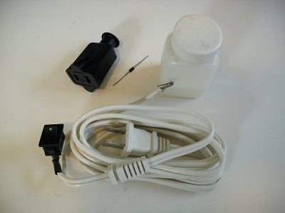

Step 1: What You Need to Make It
- 1 - Lamp Cord with Plug
- 1 - SPST Switch rated for 250VAC and at least 3 Amps
- 1 - Lamp Cord Outlet/Connector
- 1 - IN4004 Diode
- 1 - Small Plastic Pill Bottle
- Electrical Tape or Heat Shrink Tubing
Tools:
- Soldering Iron & Solder
- Wire Cutters & Strippers
- Screw Drivers
- Utility Knife

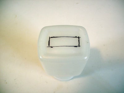

Step 2: Prepare the Housing
- Remove the cover from your lamp cord outlet, the cover won't be needed.

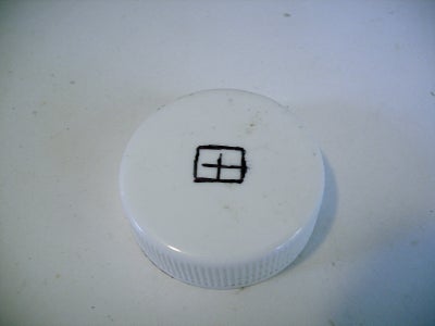

- Measure the outlet and cut a matching opening in the bottom of your pill bottle with a utility knife, make it a snug friction fit.
- Locate a place for the switch near the cap end of the bottle where it will clear the outlet when in place. Measure the switch and cut a snug friction fit opening to accept it.
- Cut a hole in the center of the lids diameter to allow the lamp cord to pass through. The cord I used had a built in strain relief. If your cord doesn't, I advise wrapping some electrical tape around the cord where it will pass through the cap, to help protect the cord from being cut by the sharp edges of the hole.

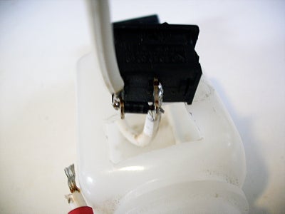

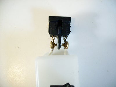

- Solder the diode between the two switch terminals.
- Solder the 2 inch wire to the switch terminal at the end of the diode opposite of the white line.
- Solder the 4 inch wire to the switch terminal at the end of the diode with the white line.
- Pass the switch through it's opening in the pill bottle, with the 2 inch wire going toward the neck and the 4 inch wire going toward the outlet opening.
- Bring the other end of the 4 inch wire through the outlet opening, then fasten it to the remaining screw terminal on the outlet.

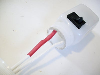

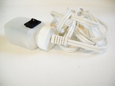

- Push the outlet through the opening and secure it to the bottle.
- Push the switch into the opening and secure it to the bottle.

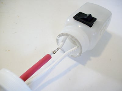

- If you have some heat shrink tubing, cut a 2 - 3 inch length and slip it on the short lamp cord wire past the stripped end.
- Solder the short lamp cord wire to the 2 inch wire end passing through the bottles neck.
- Slip the heat shrink tubing over the joint and heat it. Alternatively wrap it generously with electrical tape.
- Make sure that the switch terminals aren't shorting out on the outlet terminals.
- Screw the cap on tightly.
