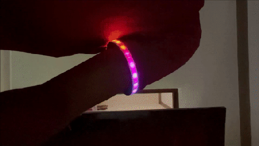

Hey readers in this project I made a 3d printed LED armband and it's not just a regular armband this is fully programmable and you can 3d print this at your home.
The use of arm bands is different for every individual few use them for visibility few for cosplay and a few for fashion but one point is known to everyone, This thing just makes others grab the attention while you are wearing them.
The band uses the ARGB kind of LED strip that is well known by creators and hobbyists for its flexibility in emitting colors based on the codes.
I used Tinkercad to design the ring and the STL file is given below for 3D printing if you are willing to build this project.

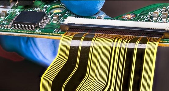

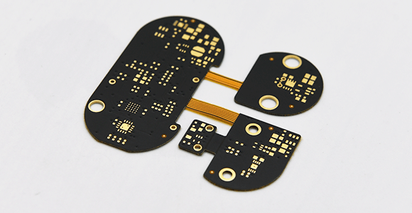

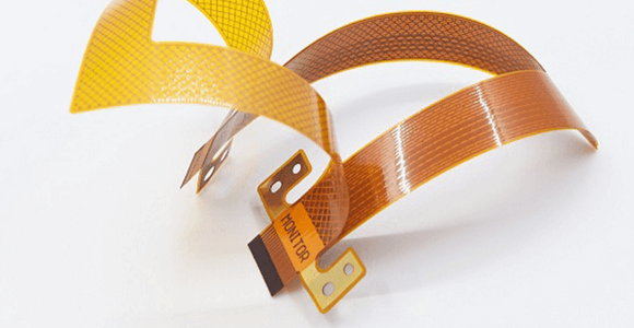

You also can Simplify this circuit with a PCBComplete your electronic projects in the best way from PCBWay
Check here to participate in their sixth design competition, where you can enter to win a free Raspberry Pi pico.
Why them? They have provided me with the best PCB and The quality is just amazing compared to other providers in the market
A revolutionary solution that combines the best of both rigid and flexible circuitry to elevate your electronic projects to new heights.
With their expertise in advanced manufacturing techniques, they offer a seamless integration of rigid and flexible components, ensuring enhanced reliability, durability, and space-saving benefits
Check Here for Rigid-flex Pcbs with this your circuit becomes flexible! i have added the images on this step kindly check

Step 3: LED Band Preparation
This is the best part of the project for me, I started by peeling off the adhesive from the back side of the LED strip.
I then placed the strip on the groove of the band and repeated the same step to the entire strip.
Solder the wires to the LED strip and make sure the wires are inserted via the slots provided in the band.
Now to diffuse the lights I will use paper, Cut the strips of normal writing paper, and glue it as shown in the steps.
Allow the glue to dry completely and trim the excess paper from the band if any.

Step 5: How to Use
Using this is no big deal, all you have to do is wear the band on the arm and then hide the battery pack inside the shirt or you can also extend the length of the wire and place the battery inside a backpack the choice is yours.
Now turn on the switch and almost instantly the band emits beautiful RGB combination colors.
You can also change the light transition speed and brightness along with some other factors on the arduino code if you wish, If you are not sure I suggest you not to make any changes.
You can easily charge the battery, just take it out from the holder and put it for charge and then insert it and use it, The backup of this battery is good so you don't need to worry about charging again and again.
Step 6: Working Video
Watch this video tutorial that also includes the working of the RGB armband, You can also use it as a prop for any costume. This project is a wonderful idea for parties where you can grab the attention of people because of the colors that come out from the band, Thanks and happy making.
