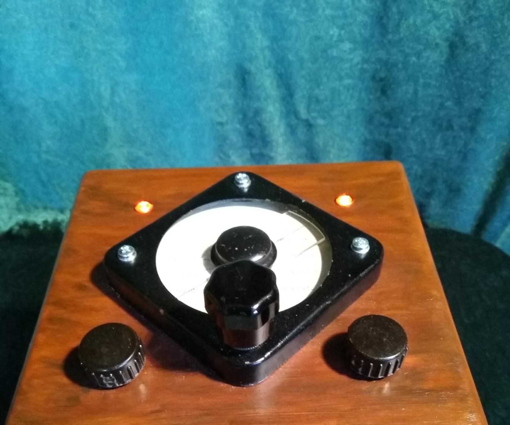

Step 1: Building the Base Case
Building the case is the normal "gluing and sanding" part.
The guide sleeve for the Poti axis must be mounted to the same level as the surface.
Step 2: Mounting the Parts Together
Now we glue everything together and doing the prepaint with a clear nitro paint.
as you can see the poti fits inside the sleeve.
Step 3: Painting and Mounting the Drive Nuts
Before we paint the case we have to press the drive nuts inside the mounting holes
After this we paint the middle part of the case and the top and bottom part.
Step 4: Placing the Parts
Now the lever for the Poti and the Batteries holder, the On/Off switch and the step switch is mounted.
The "Radio" has no build in speaker. So there are terminals to connect an external speaker.
The terminals where made from brass screws and some knurled nuts.

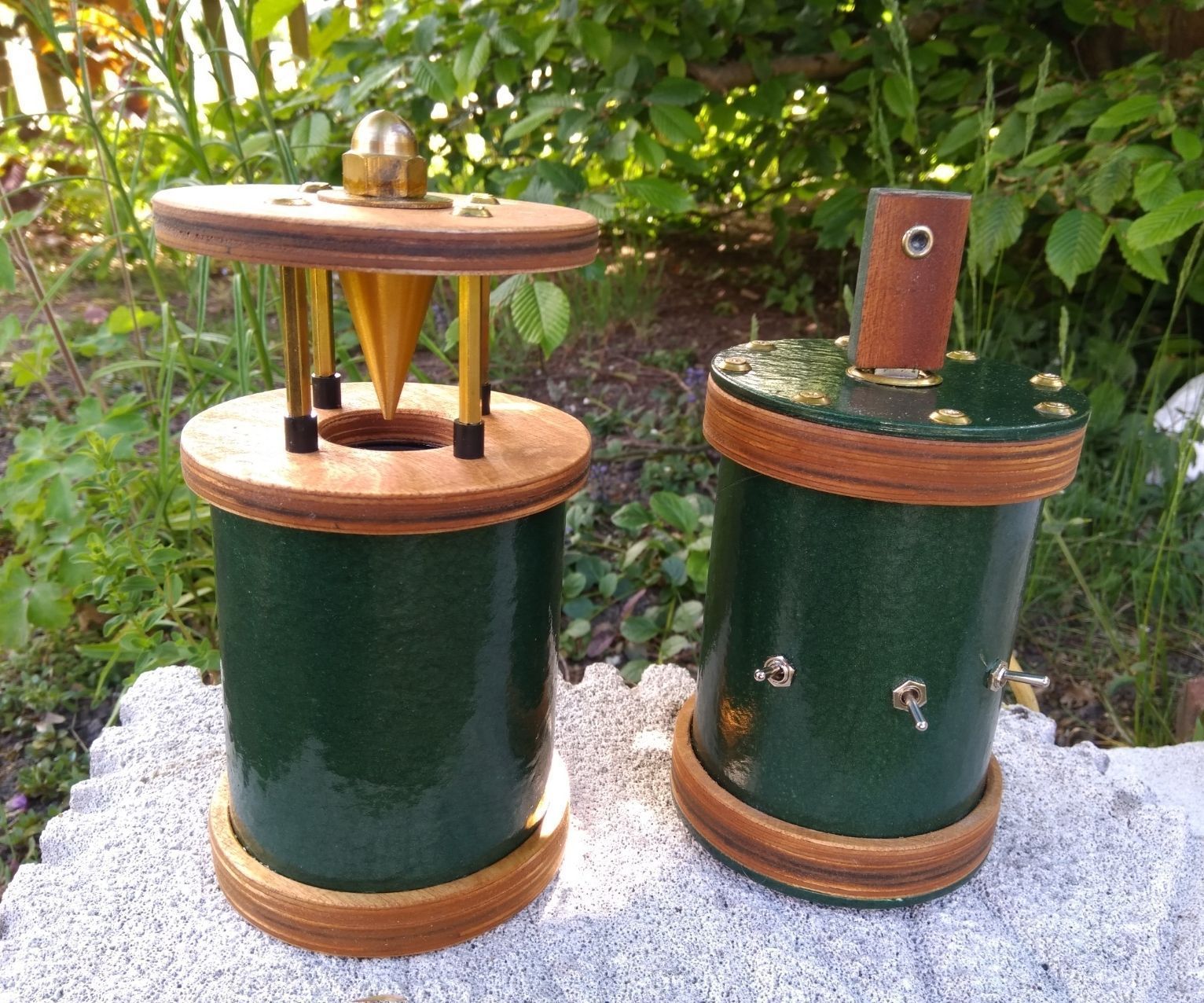

Step 6: The Speaker, the Case
The speaker is similar to build.
The speaker ist 3W / 4Ohm
The case was sanded and painted like the MP3 Player.
Step 7: The Brass Parts
The brass Horn will be soldered to the lamps baldachin and strewed on top of the speaker.
