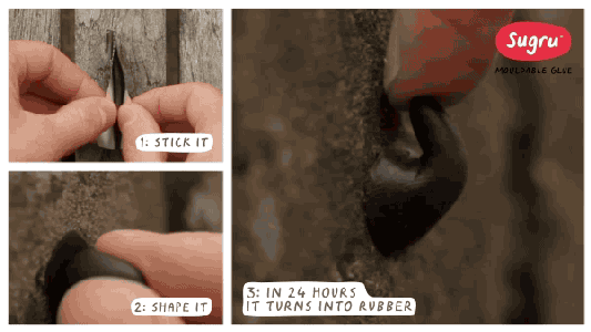

Step 3: Creating Your Sugru Hooks
For this project we created Sugru hooks along on a brick wall, but Sugru sticks to loads of materials you'll found outside in your backyard — from brick, concrete, wood, glass, ceramics and most plastics — so you can hang your lights exactly where you want them to be... along the fence or a wall, around a tree, or up the side of your house (we'll leave that bit up to you!)
  • Pinch a pea-sized piece from one of your Sugru pieces
  • Smudge this piece onto the wall to form a Sugru base layer.
(Sugru bonds super strong to itself, and because Sugru is mouldable you can fill weird gaps easily.)
  • Take one of the Sugru balls and roll it into a small Sugru-sausage and press onto the base layer.
  • Shape the Sugru using a pinch and press method with your fingers.
  • Then bend the Sugru sausage upwards into a hook shape.
TIP: remember the effect gravity will have on this. The Sugru hook will droop a little while curing, so you may want to over-compensate the hook shape a little, so that it cures into the right shape.
For quick video guides on these techniques, head over to Sugru.com/tips
  • Repeat these steps to create the number of hooks you need. One single use sachet of Sugru is enough to make 5 hooks.
