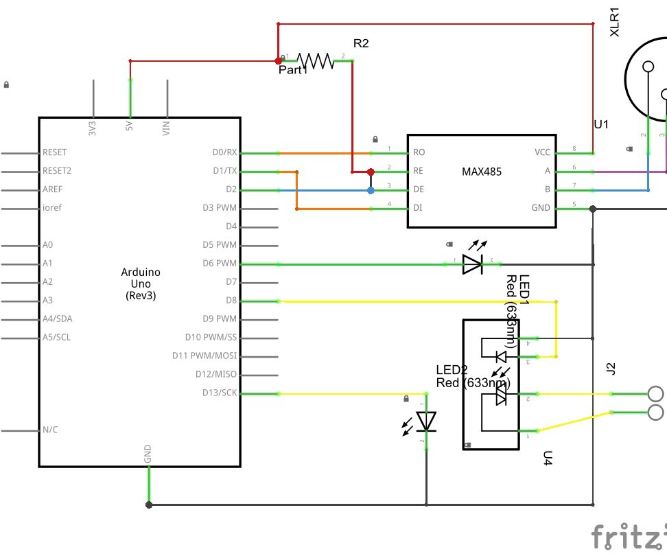

  • max485
  • 3pin(or 5pin)xlr
  • arduino mega or uno
  • ethernet shield (make sure to use an ethernet shield that uses the w5100 chipset , a shield with a different chipset wont work)
  • 16x2 lcd
  • 100 ohm resistor
  • 220 ohm resistor
  • 10k potentiometer
Step 2: Build the Circuit
The circuit is fairly straight forward but you will need some skill.
