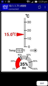

Step 3: Relative Humidity Gauge Example
This example designs a Relative Humidity Gauge similar to the ones used on the Weather Station project. Once you have drawn the gauge and generated to Arduino code, the example will cover updating the gauge with the current reading.
Tip: Although you can scale your GUI components after they are completed, design your GUI components at about final size so you can check the labels are easily readable.
Tip: On some mobiles, if the element's properties panel does not look like it has updated, move the phone's vertical slider a fraction to force Android to redraw the screen.
The first video (RH_Gauge_1.mp4 00:05:00) covers placing all the constant elements for the RH Gauge.
Here are the elements and their properties (from the generated code)
  dwgs.arc().color(7).offset(0.00,0.00).radius(11.00).start(210.00).angle(-240.00).filled().send();
dwgs.arc().color(0).offset(0.00,0.00).radius(12.00).start(210.00).angle(0.00).send();
dwgs.arc().color(0).offset(0.00,0.00).radius(12.00).start(162.00).angle(0.00).send();
dwgs.arc().color(0).offset(0.00,0.00).radius(12.00).start(114.00).angle(0.00).send();
dwgs.arc().color(0).offset(0.00,0.00).radius(12.00).start(66.00).angle(0.00).send();
dwgs.arc().color(0).offset(0.00,0.00).radius(12.00).start(18.00).angle(0.00).send();
dwgs.arc().color(0).offset(0.00,0.00).radius(12.00).start(-30.00).angle(0.00).send();
dwgs.label().color(0).offset(-13.00,6.00).fontSize(0).center().value(0.000000).decimals(0).units("%").send();
dwgs.label().color(0).offset(-14.50,-4.00).fontSize(0).center().value(20.000000).decimals(0).units("%").send();
dwgs.label().color(0).offset(-5.50,-12.00).fontSize(0).center().value(40.000000).decimals(0).units("%").send();
dwgs.label().color(0).offset(6.00,-12.00).fontSize(0).center().value(60.000000).decimals(0).units("%").send();
dwgs.label().color(0).offset(14.50,-4.00).fontSize(0).center().value(80.000000).decimals(0).units("%").send();
dwgs.label().color(0).offset(14.00,6.00).fontSize(0).center().value(100.000000).decimals(0).units("%").send();
dwgs.arc().color(15).offset(0.00,0.00).radius(6.00).start(210.00).angle(-240.00).filled().send();
dwgs.label().color(0).offset(0.00,5.00).text("RH").fontSize(2).bold().center().send();
Having placed the static elements, the gauge value and indications need to be added. These three elements, the value label, the red gauge arc and the black marker line need to updated with the current RH value.
Note about Indices
pfodApp uses indices to uniquely identify dwg elements so they can the update/replaced. Indices also determine the layering order. Elements without indices are drawn in the order received. Elements with indices are then drawn on top in order of their index from lowest to highest. The indices need not be sequential. While you can manually assign uint16_t numbers for indices, the generated code uses pfodAutoIdx objects which allocate globally unique indices sequentially as they are first sent to the pfodApp. The name of the pfodAutoIdx variable has no relation to the actual index.
Marking Elements to Update
In pfodGUIdesigner each primitive drawing element has an update/idx button which when highlighted indicates that the element needs a unique index for updating. Depending on which layer the indexed element is, other higher elements will also need to be indexed to keep the layer ordering. pfodGUIdesigner handles this automatically, so you should only mark the elements that you need to update.
This second video (RH_Gauge_2.mp4 00:03:30) adds the three elements that show an example gauge value of 65%. 65% of the -240 total arc is -156 and the marker line is at the start angle (210 – 156) = 54. These elements are then marked to update. They could have also been marked as they were added. Finally the Arduino code for this gauge is generated. You can save to a file on your mobile, but the code is also dumped to the Arduino monitor so you can just copy and paste it from there.
Finishing the RH Gauge
The generated code is here, RH_Gauge_a.ino Open the new sketch and replace it code with the generated code. Save the sketch as RH_Gauge. Set your network SSID / password and staticIP and upload to your ESP. This will not erase your dwg designs. Open pfodApp and connect to see your gauge design.
Once you have confirmed the display, create two new files in the Arduino sketch (using the top right down arrow in the Arduino IDE display). One file for RH_Gauge.h and one for RH_Gauge.cpp. Then cut those sections of code from the main ino sketch and paste them into their respective .cpp / .h files.
Now you need to replace the 65% example reading with variables to show the actual reading. The pfodApp caches the drawing, so you only need to send the updates to display then new reading.
Here is the generated code with the values the need to updated highlighted.
void updateDwg(pfodDwgs &dwgs) {
dwgs.arc().idx(_update_idx_17).color(9).offset(0.00,0.00).radius(11.00).start(210.00).angle(-156.00).filled().send();
dwgs.arc().idx(_update_idx_18).color(0).offset(0.00,0.00).radius(12.00).start(54.00).angle(0.00).send();
dwgs.label().idx(_update_idx_16).color(0).offset(0.00,0.00).fontSize(6).bold().center().value(65.000000).decimals(0).units("%").send();
The values that need to replace by variables are highlighted above, -156, 54 and 65.00. -156 is the red gauge arc and is calculated by -240*rh/100. The 54 is the end marker and is (210 – 240*rh/100). The 65.00 is the current RH reading. Here is the revised updateDwg method that uses the current rh value to update the gauge.
int rhArc = map(rh,0,100,0,-240); // map rh to -ve angle
dwgs.arc().idx(_update_idx_17).color(9).offset(0.00,0.00).radius(11.00).start(210.00).angle(rhArc).filled().send();
dwgs.arc().idx(_update_idx_18).color(0).offset(0.00,0.00).radius(12.00).start(210+rhArc).angle(0.00).send();
dwgs.label().idx(_update_idx_16).color(0).offset(0.00,0.00).fontSize(6).bold().center().value(rh).decimals(0).units("%").send();
Finally add a setRH(int rh) method to set the current value, and add an int rh; variable to the RH_Gauge.h file. See the RH_Gauge.h and RH_Gauge.cpp files for the modified code.
void RH_Gauge::setRH(int _rh) {
rh = _rh;
The position of the gauge on the screen and its scaling are set by the pushZero( ) statement in bool sendMainDwg() method in the .ino file. For demonstration purposes the gauge will be positioned in the bottom left corner and scaled down to 65% of the design size by using
  dwgs.pushZero(12.00, 40.00, 0.65); //(x,y) offset (12,40)  scaleFactor 0.65
Edit static unsigned long dwgRefresh = 1000; at the top of the .ino file to refresh the menu every 1000ms (1secs) to automatically pick up the latest rh reading. In a real weather station a much slower update is appropriate. Finally for demonstration purposes code has been added to increment the rh reading on every update.
See the RHGaugeClasses_a.zipsketch for these changes and the separate .cpp and .h class files

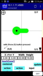

Step 5: TouchAction Adding/Replacing an Element – OnOffSlider
The previous Button example showed how to use a touchAction to hide an existing drawing element. In this example existing drawing elements will be replaced with different elements with different colour and at different positions, when the touchZone is triggered by the user's touch. An OnOffSlider is used to illustrate this.
OnOffSlider
Start a new drawing called OnOffSlider and create the slider in the Off position. See the first part of the video (onOffSliderIntro.mp4 00:06:30) up to 00:02:60, for the how to draw the slider.
Note that the filled circle at the end of the rectangle under the large Off button is colored Green. It will be uncovered when the action moves the Off button to the left. Setting it to Green means it does not need to be updated when the slider on set to On.
Having drawn the slider in the Off position, then add a touchZone to cover it and add three (3) touchActions to
i) move the Black dot in the middle of the button to the left,
ii) move the button to the left and change it color to Green,
iii) change the color of the slider rectangle to Green. The remainder of the video above (00:02:60 onward) covers adding these three actions. Note again the use of the Show (S) button to check/confirm that the action is replacing the correct dwg element. After the three actions are added and closed, you can use the Show (S) button on the touchZone to see the three actions working.
Finally mark the touchZone to update. When the slider is in the On position, the actions need to updated to show the Off state when the user next presses the slider.
pfodGUIdesigner automatically marks dwg objects/labels for update when they are referenced by a touchAction (action) or touchActionInput (input) of a touchZone. You only need to manually mark the touchZone itself for input if you are going to modify it or its actions as shown below.

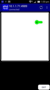

Generate the code (OnOffSlider_a.ino) and upload and test it. Then create new files for the .h and .cpp code and split out the OnOffSlider.h and OnOffSlider.cpp code into the separate files. Add a private bool on variable and the methods void OnOffSlider::setOn(bool _on) and bool OnOffSlider::isOn() See the OnOffSliderClasses.zip for these mods.
In OnOffSlider.cpp in the bool OnOffSlider::processDwgCmds() method add the statement
on = !on;
to toggle the on flag each time the slider is pressed and the touchZone sends a command.
In the void OnOffSlider::updateDwg() method you need to add another block of code to send when the slider is on to show the On state and set the touchActions to show the Off start when touched.
void OnOffSlider::updateDwg() {
if (!isOn()) { // this is the generated code for slider in the Off position
dwgsPtr->rectangle().idx(_update_idx_13).color(7).offset(0.00, 0.00).size(12.00, 5.00).filled().centered().send();
dwgsPtr->circle().idx(_update_idx_14).color(7).offset(6.00, 0.00).radius(5.00).filled().send();
dwgsPtr->circle().idx(_update_idx_15).color(0).offset(6.00, 0.00).radius(1.00).filled().send();
dwgsPtr->touchZone().cmd(_touchZone_cmd_5).offset(0.00, 0.00).size(22.00, 10.00).centered().send();
dwgsPtr->touchAction().cmd(_touchZone_cmd_5).action(
dwgsPtr->circle().idx(_update_idx_15).color(0).offset(-6.00, 0.00).radius(1.00).filled()
).send();
dwgsPtr->circle().idx(_update_idx_14).color(10).offset(-6.00, 0.00).radius(5.00).filled()
).send();
dwgsPtr->rectangle().idx(_update_idx_13).color(10).offset(0.00, 0.00).size(12.00, 5.00).filled().centered()
).send();
} else { // this is for when the slider is On
dwgsPtr->rectangle().idx(_update_idx_13).color(10).offset(0.00, 0.00).size(12.00, 5.00).filled().centered().send();
dwgsPtr->circle().idx(_update_idx_14).color(10).offset(-6.00, 0.00).radius(5.00).filled().send();
dwgsPtr->circle().idx(_update_idx_15).color(0).offset(-6.00, 0.00).radius(1.00).filled().send();
).send();

Finally the slider as designed is generally too large so in the OnOffSliderClasses.ino file scale it down by 0.4 and position it in the top right hand corner ,ie. dwgs.pushZero(40.00,10.00,0.4);
// send main dwg that just inserts the designed dwg at the pushZero position and scaling.
bool sendMainDwg() {
// main dwg just inserts desgined dwg
dwgs.start(50, 50, dwgs.WHITE, false); //false means NO more to come, background defaults to WHITE if omitted i.e. dwgs.start(50,30);
parser.sendRefreshAndVersion(0); //need to set a version number for image refresh to work!!
dwgs.pushZero(40.00,10.00,0.4); // position and scale the inserted designed dwg
dwgs.insertDwg().loadCmd(_onoffslider).send(); // insert the dwg object in the main dwg dwg
dwgs.popZero();
dwgs.end();
return true;
The OnOffSliderClasses_a.zip contains the completed OnOffSlider.cpp and .h files and the modified OnOffSlider.ino file.
If you need to change the design later, generate the code again and use a comparison tool like BeyondCompare to highlight the changes between the new code and the existing .h / .cpp files.

Step 7: A Temperature Gauge
The final GUI example component will be a temperature gauge. The following video (T_Gauge.mp4 00:06:08) shows how it is constructed.
In this GUI design the zero point in the pfodGUIdesigner is moved down and the temperature gauge goes from (0,0) to (0,-35). This simplifies the update calculations.
The generated code is T_Gauge_a.ino. The T_GaugeClasses_a.zip contains the class files, after splitting out the .cpp and .h files and adding the void T_Gauge::setT(float degC) method and editing the updateDwg() method to display the current degC setting
Step 8: Putting It All Together – Final GUI
Now that you have designed your GUI components and broken them out into re-usable classes, you can position and scale instances of them on your final GUI.
The sketch Test_a.zip has the component classes and a test sketch that positions and scales them on the screen. The instances of the GUI components are declared at the top of the sketch.
OnOffSlider _onoffslider(&parser, &dwgs); // create onOffSlider object and add to parser processing
RH_Gauge _rh_gauge(&parser, &dwgs); // create RH_Gauge object and add to parser processing
Setpoint _setpoint(&parser, &dwgs); // create Setpoint object and add to parser processing
T_Gauge _t_gauge(&parser, &dwgs); // create T_Gauge object and add to parser processing
Then in bool sendMainDwg() they are positioned and scaled before inserting into the main drawing. Here the main drawing is longer at 50 x 65.
dwgs.start(50, 65, dwgs.WHITE, false); //false means NO more to come
dwgs.pushZero(25.00,38.00,0.9); // position and set the scale for T_Gauge
dwgs.insertDwg().loadCmd(_t_gauge).send(); // insert the temp gauge in the main dwg dwg
dwgs.popZero();
dwgs.pushZero(20.00,42,1); // position and set the scale for the setpoint
dwgs.insertDwg().loadCmd(_setpoint).send(); // insert the setpoint component in the main dwg dwg
dwgs.popZero();
dwgs.pushZero(35.00,42.00,0.4); // position and set the scale for the OnOffSlider
dwgs.insertDwg().loadCmd(_onoffslider).send(); // insert the onoffslider in the main dwg dwg
dwgs.popZero();
dwgs.pushZero(25.00,57.00,0.85); // position and set the scale for the RH gauge
dwgs.insertDwg().loadCmd(_rh_gauge).send(); // insert the rh gauge in the main dwg dwg
dwgs.popZero();
dwgs.end();
return true;
Finally in the loop() code the various GUI components are linked together
void loop() {
_t_gauge.setT(_setpoint.getSP());
if (_onoffslider.isOn()) {
if (!timer.isRunning()) {
timer.start(3000); // start if not already running
} else {
timer.stop();
if (timer.justFinished()) {
timer.restart();
rh += 5;
if (rh>100) { rh = 0; }
_rh_gauge.setRH(rh);
handle_pfodServerConnection();
Here the temperature gauge reading is set by the setpoint input and on/off slider controls starts/stops the update of the RH gauge with some dummy data.
The main menu is set to refresh every 2sec to update the temperature gauge and RH gauge with their new values. See static unsigned long dwgRefresh = 2000; at the top if the Test.ino sketch
The setpoint and on/off slider are updated immediately by their classed update methods. The setpoint and on/off slider command processing could be modified to update the main menu directly by calling sendMainMenuUpdate() directly instead of their own sendUpdate() methods.
