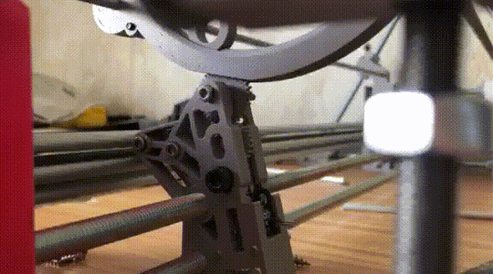

Step 4: Clutch Mechanism
The idea is that the stepper motor rotates CW or CCW and each tablet gear is connected to its own clutch mechanism, which controls if the tablet gear should connect to rotating stepper, therefore rotate the tablet gear.
So if the weaving instructions calls for first and last tablet to rotate CW and everything in between CCW, the stepper first starts rotating CW and clutches engages first and last. Then motor stops, clutches will disengage, different ones will engage and motor starts spinning CCW.
Clutch mechanism was designed in a way, that there is one gear permanently engaged with the tablet gear and one permanently engaged with motor shaft. Between those two gears is the third one, which is connected to a solenoid, that moves the gear to engage with the others.
In other words, when I activate the solenoid, clutch starts to transfer movement from stepper to a tablet gear (because it stucks one lonely gear into two other).
This clutch mechanism consists of two mirrored shell parts, those hold two engaged gears and there is compartment for solenoid which snaps in, so I won't waste any screws (Shells are joined with screws, they are designed with undersized M3 screws and tapped). Third part connects to solenoid a slides up and down and holds the third gear - the clutch gear. There were around 20 iterations of this part to work properly, that was caused by change in design, how clutch attaches to motor.
This mechanism could be even better with one extra solenoid gear. This way, I could connect or disconnect tablet to motor and when engaging second gear, clutch would reverse the movement, so there would be no need to reverse stepper direction and all movements could be done at one go.

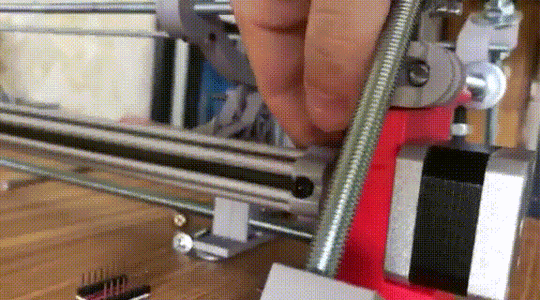

Step 7: Mechanical Testing
There was lot of mechanical testing, trial and error, thorough testing what would work, and what needs to be adjusted. This is first successfull mechanical test of moving shaft (only by hand, so I wont cause something irreversible by accident).
Clutch features a testing hole, when I screw M5 screw inside, the gears will stay engaged, which is for testing purposes. Many of designed parts has some adjustments mechanisms, to position them by little, to compensate for errors.
Video of mechanical test can be seen here: https://www.youtube.com/embed/dzRRYfeZewQ
