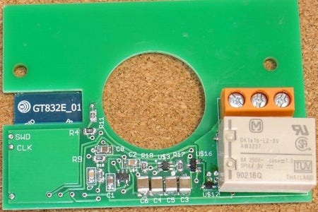

Step 6: PCB Construction and Programming
I used Eagle Cad to layout the PCB. I supplied a zip of the Gerber files to www.pcbcart.com for the manufacture using 2oz copper. I used gerbv to view and check the Gerber files before submitting for manufacture.
The latest PCB is Rev BLE_Lights_14A and includes a few minor corrections. The Eagle Cad files are here. The PCB Gerber files are here. The parts list (.csv) is here.
The bypass FET used here can only handle about 4A with the heatsinking provided by this board layout.
Programming the nRF52823 module
The circuit board is laid out for a GT823E-01 nRF52832 module, but the PCB can be modified to accommodate other small modules. See Easy Very Low Power BLE in Arduino – 2022 for some alternative modules. Easy Very Low Power BLE in Arduino – 2022 also covers how to program the nRF52832 module.
Note: The GT823E-01 module seems to be in short supply. The HOLYIOT-YJ-16048-NRF52832 is a suitable alternative, but needs the PCB to modified to suit.
The nRF52832 was programmed with the BLE_LightSwitch_R15.ino sketch. That sketch will serve up a control menu for pfodApp, but you can also use Nordic nRF Toolbox to send the commands to turn the light on, {A} or off {B} or toggle on/off {T} . See Very Simple BLE Power Switch for more an example of using the Nordic nRF Toolbox.
Once the board is programmed you can connect to is using pfodApp. Set up a connection to the BLE Light Switch as described in pfodAppForAndroidGettingStarted.pdf, then when pfodApp connects, your Android mobile will display the following button menu and the current state of the light.
