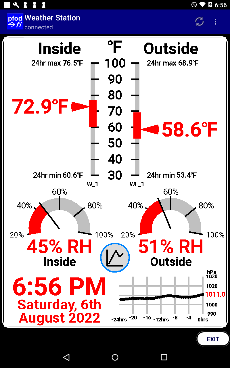

The Weather Station Display
There are a number of options for the Weather Station Display :-
- You can use the ESP32-C3 to serve a simple web page with the current values. See the Web Page Temperature Display section of a Simple BLE Temp Sensor for Beginners for an example of a very simple webpage.
- You can use the ESP32-C3 to post the readings to the cloud and then process and plot them from there (this use of the C3 running with BLE has not been tested).
- You can use pfodApp on an Android mobile/table to display the Weather Station gauges as shown above. Since pfodApp works on Android devices from 8 years ago, you can resurrect one of you old devices to use as the display. Even a new inexpensive Android tablet is price competitive with a similar size LCD/TFT display. You can also use BlueStack on a PC/Mac to display the Weather Station.
In this project, pfodApp will be used to display the Weather Station. pfodApp keeps all the display code in your Arduino sketch. No Android coding is required. Once you design the graphical gauges (see Custom Arduino Controls for Android), you can easily position and scale them on the screen. Since all the code is in your Arduino sketch you can modify the Weather Station display as you require. pfodApp also simplifies plotting. Revision 2 adds a chart button to open a chart page with the last 36hrs of measurements. You can zoom the plots using two finger pinch/spread.
You will know when you have the display/gauges setup correctly when other household members complain when the Weather Station is not running.

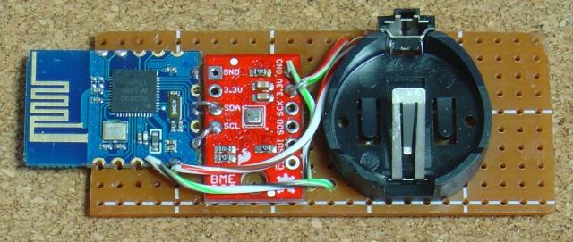

The Very Low Power BLE Sensors
2 x GT832E_01 ~US$15.90 each mounted on vero board
2 x Sparkfun BME280 board ~US$21.50 each
2 x Sparkfun coin cell holder PRT-00783 US$1.60 each and
2 x CR2032 coin cell PRT-00338 ~US$2.10 each
1 x programmer MuseLab, CMSIS-DAP (~US$9)
Optional -- 1 x Sparkfun VELM7700 ~US$6 and 10 x 22uF capacitors 445-173294-1-ND ~US$10 for 10off

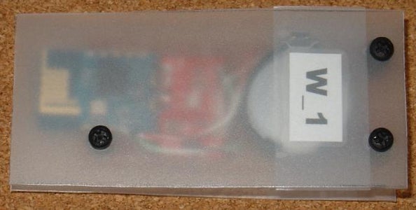

Hook up wire and vero board and plastic sheet/cases

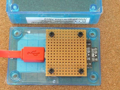

Step 1: The Weather Station Display and BLE to WiFi Bridge
To set up to program the ESP32-C3 see the instructions on Single Board BLE to WiFi Bridge ESP32 C3
The ESP32-C3 handles both the BLE scanning for the sensor broadcasts/advertising AND sets up a WiFi server to serve the Weather Station display and plot data. Unzip ESP32C3_WeatherStation_Rev2a.zip to your Arduino sketch directory (If you are updating Rev 1 ESP8266 hardware use ESP8266_WeatherStation_Rev2a.zip) and program the ESP32-C3.

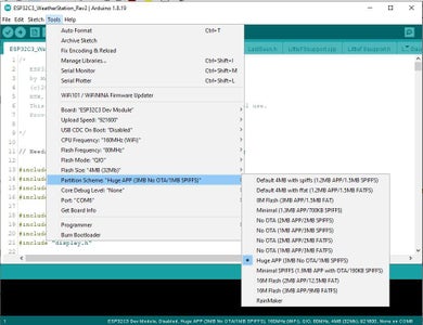

Note: The program is large and you need to select the Partition Scheme for Huge APP (similarly for the ESP8266 if you are updated Rev 1 hardware)

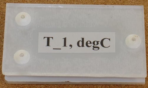

BLE Sensor Names
The BLE sensor names are set at the top of the display.cpp file. Here the outside sensor has a Lux sensor as well. For just Temp and RH and hPa, W_1, and W_2, would be appropriate.
// These are the names of the BLE devices to listen to
static const char OUTSIDE_DEVICE[] = "WL_1,"; // note the trailing , so T_1, does not match T_11,
static const char INSIDE_DEVICE[] = "W_1,";
These names must match the ones you coded into your BLE sensors. See the Very Low Power Sensors section below.

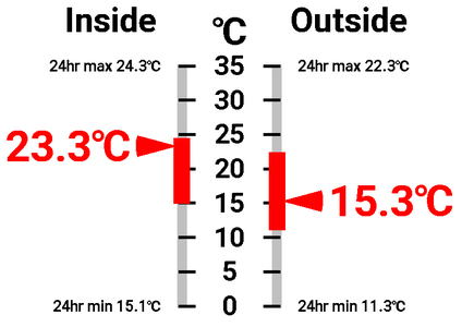

Temperature Ranges
The range of temperatures on the scales are set by the inside_temp, outside_temp constructors at the top of the display.cpp file. e.g
TempGauge_C inside_temp(&dwgs, false, 0, 35, false); // scale points on right, current temp on left 0 to 35degC range, no labels
TempGauge_C outside_temp(&dwgs, true, 0, 35, false); // scale points on left, current temp on right 0 to 35degC range, no labels
The inside and outside ranges must be set the same as only one scale is drawn for both.
If the temperature exceeds the scale range the correct reading will be displayed at the top or bottom of the scale.
The chart of the previous 36 hrs readings will automagically expand to accommodate higher or lower readings.

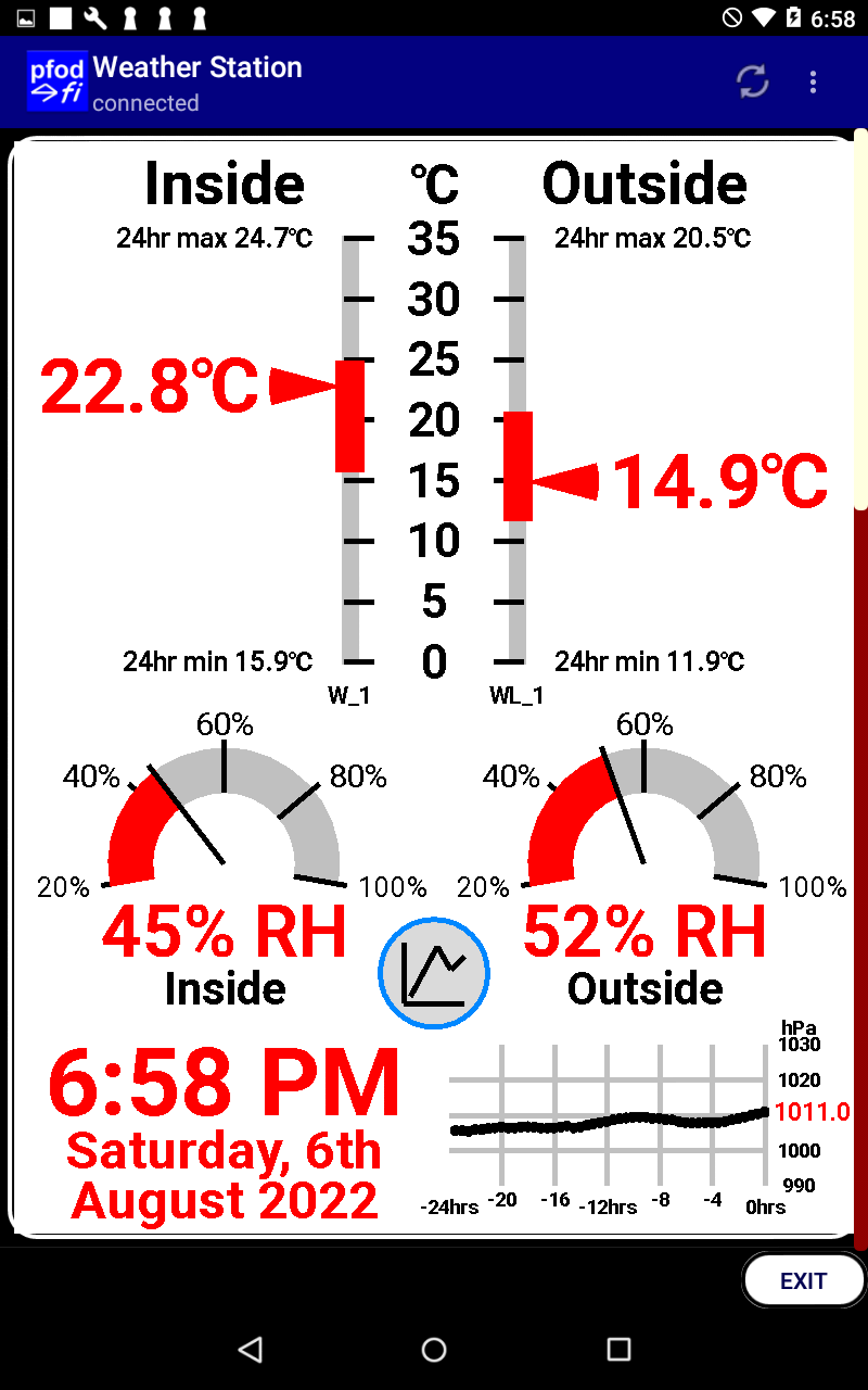

Step 2: The Display Gauges
The ESP32-C3 is programmed as a pfodDevice to serve up the Weather Station's graphical display to pfodApp on an Android mobile/tablet or PC or Mac running BlueStack. The Weather Station Display in this project is an old Android tablet. pfodApp will run on Android versions back to Lollipop (API 5), Nov 2014, so you probably have an old Android mobile lying around that you can use for the display.
There are lots of options for the layout and gauges used for the Weather Station. See Custom Arduino Controls for Android for a tutorial on creating pfodApp controls in your Arduino sketch. The display.cpp together with the various components in ESP32C3_WeatherStation_Rev2.zip creates the display above. The display refreshes every 20 seconds.
The sensors advertise the readings for 10sec every 100sec. If the ESP32-C3 BLE scanner misses a reading due to interference, out-of-range, low battery, etc then the display will update with the time since the last reading was received e.g. outside WL_1 will update to WL_1 4 mins ago.
The main screen display is a drawing menu item (A) that loads the dwg 'z' (see display.cpp) The dwg loaded consists of a number of sub-elements and an inserted dwg. The entire display is completely controlled by the Arduino's sketch code so you can change it as you wish to your own colours or language.

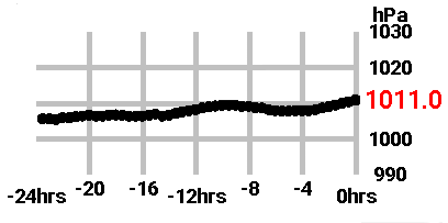

The Barometric Pressure Plot
The hPa plot on the main screen is coded in hPa_BarGraph.cpp. It differs from the other elements in that it is a separate dwg that is loaded separately from the main screen dwg and then scaled and inserted at the appropriate offset in the main screen dwg.
The sendMainMenu() code creates a dwg menu item (see the free pfodDesigner app for designing menu items) that fills the menu item with dwg 'z'

Inside/Outside Temperatures
This display is a combination of two deg C gauges with labels suppressed on each gauge and the labels written separately in the middle.
The Inside / Outside labels are added separately (see the code in sendDrawing_z2() and sendDrawing_z3() in display.cpp). The temperature gauges include an indicator for the range of temperatures over the last 24hrs. Temp24hrMaxMin.cpp keeps track of the max/min over the last 24hrs.

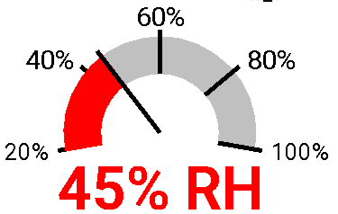

The Relative Humidity Gauges
The Relative Humidity Gauge code is in rh_Gauge.cpp

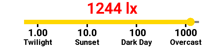

The Lux Gauge
There is also a lux gauge, Lux_Gauge.cpp
The outside sensor includes a light sensor. This returns a lux reading. However the outside sensor is placed in the shade to prevent direct sun from effecting the temperature reading. This reduces the lux reading. To compensate for this the code in the display.cpp scales the reading by x 2 before storing it for display. This factor was estimated from another VEML7700 sensor in full sun. For the next project ,which intends to use the lux reading to turn the hall night lights on and off, the actual true lx value is not important as the switching set point can be set as necessary, however the x 2 factor gives a “Sunset” reading at sunset.

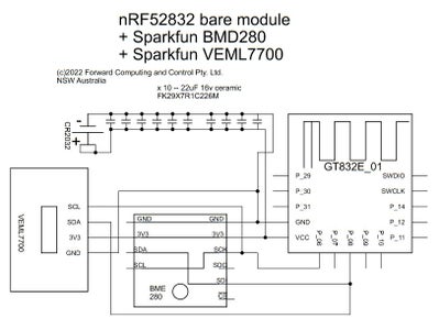

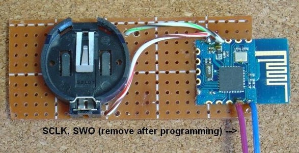

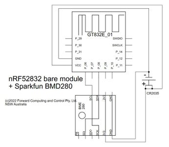

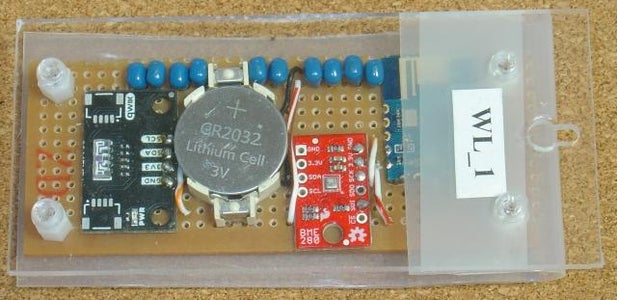

Step 3: The Very Low Power BLE Sensors
Component Selection

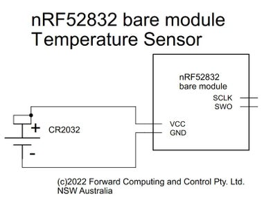

The two basic components are a nRF52832 'bare' module and a coin cell (in a holder).
The following nRF52832 'bare' modules available from Aliexpress can be used. They include:-
GT832E_01 ~US$15.90 mounts on vero board
Jessinie XL52832-D01 nRF52832 module ~US4.90 and Jessinie Test Board Adapter Plate for NRF52832 ~US$1.70 – Total ~US$5.60
BLM-KTB522 ~US$6.30 (no crystal) pin for pin replacement for Skylab SKB369, needs to be mounted on a PCB
Those 'bare' nRF52832 do not have any extra components or power regulators that will used extra current.
Add to this a CR2032 coin cell and holder, e.g. Sparkfun coin cell holder PRT-00783 US$1.60 and CR2032 coin cell PRT-00338 ~US$2.10 – Total US$3.70
So using the Jessinie module and adapter and a coin cell and holder the total cost (excluding shipping) is < US$10
A Simple BLE Temp Sensor for Beginners shows you how to use just these two components to get a usable BLE temperature sensor. For the relative humidity and barometric pressure, you need to add a Sparkfun BME280 board (~US$21.50) Adding this very low power board gives about 4 and a half years of run time on a CR2032 coin cell. It also avoids the time consuming temperature calibration so you may choose to used it just for the temperature sensor also. This project also includes a light sensor, Sparkfun VELM7700 (~US$6) . Sparkfun VELM6030 (~US$6) also looks suitable, but was not tested. Because the light sensor only works down to 2.5V, you do cannot access the full capacity of the coin cell (down to 2V). This reduces the run time to about 3 and a quarter years.

Construction
The WL_1 sensor, which includes a temperature, relative humidity, barometric pressure and light sensor, is placed outside and the W_1 sensor, without the light sensor, is used inside. If you don't want the light sensor, use the simpler W_.. sensor (see below) and modify the Weather Station code to filter for W_.., instead of WL_1, e.g filter for W_2, for example if the sensor's name is W_2,
Naming Sensors
Since these sensors are so simple and inexpensive to make, you may well end up with a number of them advertising the temperature and/or other measurements, from various locations. To distinguish between them, the lp_BLE_Temp_uC.ino sketch uses the following convention. The temperature sensors advertised name starts with T_ followed by a number, e.g T_1, followed by a comma and the temperature value. This design will also be the basis for other sensors which add a very low power, temperature/humidity sensor or a temperature/humidity/barometric pressure sensor and/or a lux sensor.
This project used the following name format
Format of advertised name, e.g. T_5,25.5
LOCAL_NAME prefix T_.. devices LOCAL_NAME,degC
LOCAL_NAME prefix H_.. devices LOCAL_NAME,degC,%RH
LOCAL_NAME prefix W_.. devices LOCAL_NAME,degC,%RH,hPa
LOCAL_NAME prefix WL_.. devices LOCAL_NAME,degC,%RH,hPa,Lux
Set LOCAL_NAME, at the top of the sensor sketches and then use the prefix to parse the advertised data.
Step 4: Sensor Construction -- T_1 – Temperature Sensor
Follow the instructions in Easy Very Low Power BLE in Arduino -- Part 1 2022 to setup the Very Low Power BLE support for nRF52832 boards and programmers.
The construction and calibration of the T_1 sensor is described in Simple BLE Temp Sensor for Beginners. Because the nRF52832 on-board temperature measurement is not very accurate, the T_1 sensor requires calibration before use. After determining the calibration correction the nRF52832 is programmed with the lp_BLE_Temp_uC.ino sketch. This sketch only has constant correction. You may need a formula as described Multi-point Calibration. The sketch is set to advertise for 10 secs every 100sec and T_1 should run for about 5 years on a CR2032 cell.
Step 5: Sensor Construction -- W_1 – Temperature, Humidity and Barometric Pressure Sensor
To avoid doing a multi-point calibration, you can instead fit a Sparkfun BME280 temperature, humidity and barometric pressure sensor. Again the circuit is trivial (pdf version) If you don't need the sensor including the light sensor, WL_1, below, then this sensor can be used outside as well, but with a different LOCAL_NAME, say W_2.
This sensor, named W_1, is programmed with the lp_BLE_GT832E_01_BME.ino sketch. Unzip lp_BLE_GT832E_01_BME.zip to your Arduino sketch directory. This sensor will run for about 4 ½ years on a CR2032 coin cell.
Step 6: Sensor Construction -- WL_1 – Temperature, Humidity Sensor, Barometric Pressure and Lux Level Sensor
In preparation for a future project that will turn the hall night lights on at sunset and off at sunrise, the outside sensor used here for the Weather Station includes a light sensor, SparkFun VEML7700.
Note: Cut the I2C tracks on the back of VEML7700 to disconnect the two pullup resistors. The BMD280 provides the I2C pullups.
The VEML7700 light sensor has a minimum operating voltage of 2.5V. The 10 off, 22uF 16V ceramic capacitors supply the pulses of current the VEML7700 needs as the coin cell's voltage falls and its internal resistance increases. However even with these capacitors, the 2.5V cut off means a shorter effective operating life from a CR2032 coin cell, approximately 3 ¼ years. This sensor is named WL_1, following the naming convention established above. In the construction the backing plastic was folded over the top of the board to protect against dust etc settling on the circuit. The rest of the cover is open on the other 3 sides. In a more extreme climate, a more protective case would be needed.

This tutorial has presented an Indoor/Outdoor Weather Station using two very simple, very low power BLE temperature/RH/hPa sensors using only three components, a nRF52832 'bare' module a temperature/RH/hPa sensor and a coin cell. The sensors run for ~4 ½ years a CR2032 coin cell.
The display uses an old Android tablet and pfodApp. The gauges are fully customizable in the Arduino sketch. This Rev 2 add time and date and hPa plot and chart of the previous 36hrs values.
