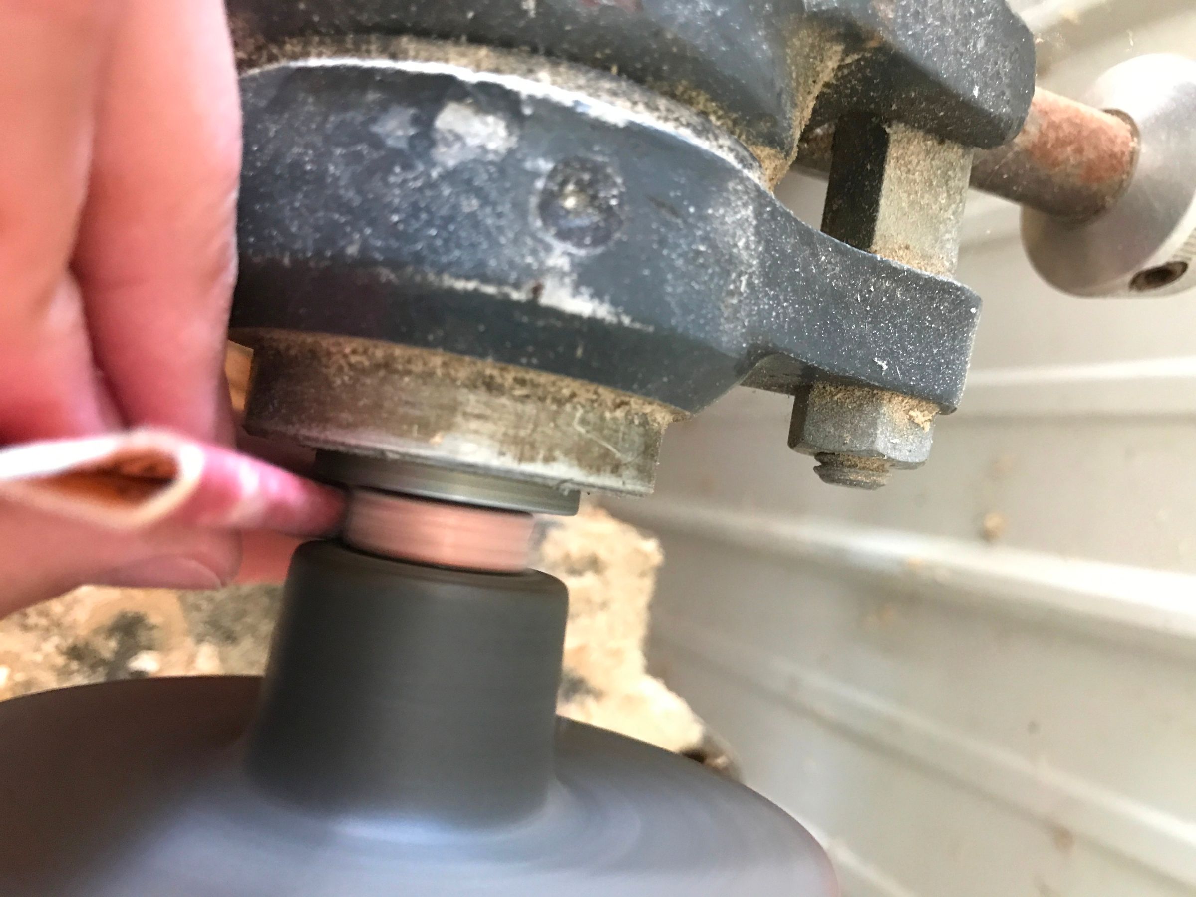

Once I was satisfied with my soldering I started polishing the ring. I started sanding it with some high/medium grit with my hands but then I decided to put it on my wood lathe to speed the process up.
After a little bit I switched to a high grit emery paper.
