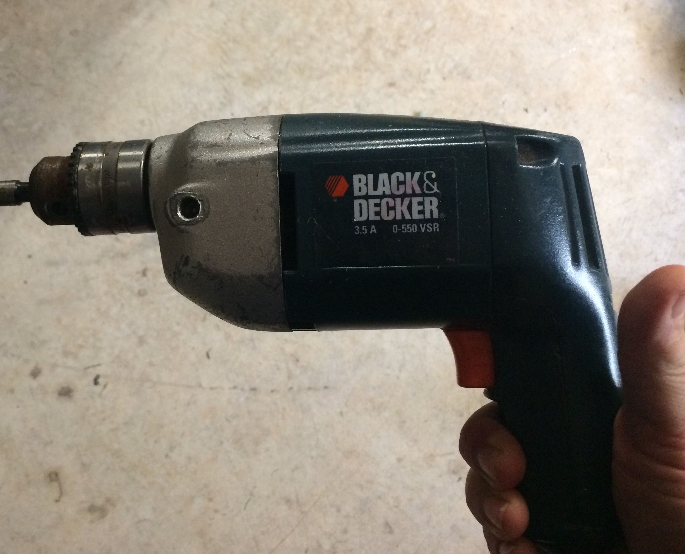

Step 1: Tools Needed
Hammer
Level
Tape measure (if you can't measure with your level )
Screwdriver
Wood Glue / outdoor rated adhesive
Ladder

Step 11: Consider Adding Water Release Options...
This step was added after I built the stands and have had them out in the back yard a while. I had to drill holes in the sides of the barrel to allow water to drain out. Consider drilling a couple holes in floor of barrel before pouring the sacrete. Take PVC pipes and fit them in the holes and then pour the sacrete. Once it’s cured, cut the pipes at the sacrete line so you’ve made a couple water drains.
I am currently retrofitting my barrels with pvc lines to create vents to dry out the soil to prevent it staying supersaturated.
