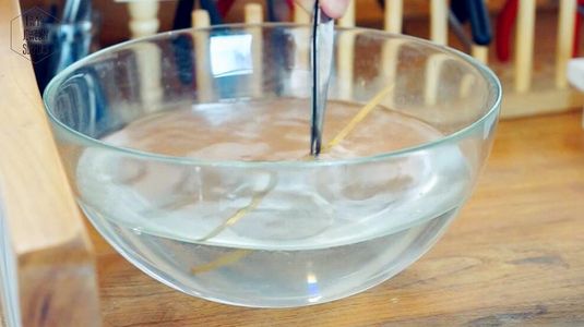

Step 3: Heating and Cooling
Place the brass piece onto the heating platform and heat the brass to soften it. Cool it off in the water.

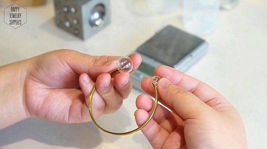

Step 6: Comparing
The cleaned brass bracelet will be compared to the chosen glass balls.
