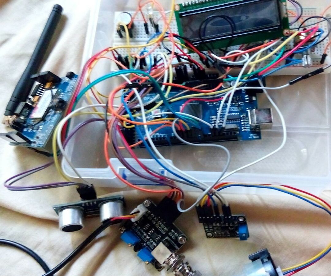

Step 2: Breadboard View and Circuit Diagram
Attached are the Breadboard view and the Circuit diagram of the Project.
Step 3: Arduino Code
Kindly note that, this is the original code of the ArduDroid App for the arduino version. But i only did a little edit to suite this tutorial. Also you will note that with most of the code i have commented that, this is because i do not need them. You can also go ahead and do the changes you need. Hope this helps.

Step 5: Pictures of the Project
