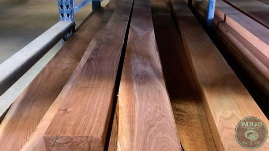

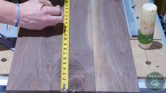

To prepare the walnut wood, I used my track saw & track to get a straight side for each board. Most of the time, my track saw does the job of a jointer.
Next, I used the straight side for reference on my MFT3 table to square each end of each board.
I kept the straight side against the MFT3 guide rail system to make sure each end remained square.
Then, I made the final rip cut on the other side with my track saw to a final width of 5″.
Finally, I cross cut 3 boards at 50″ long for the bench seat top.

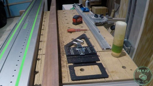

Step 2: Bench Seat Wood Joinery
As I listed in the tools section at the beginning of this article, a biscuit joiner or a dowel jig work as an alternative joinery method.

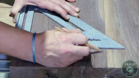

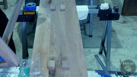

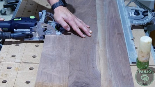

First, I marked the domino locations 3″ from each end and made marks 12″ apart in between.
I labeled each mark with corresponding letters on each board in case I mixed them up. A speed square is a great way to draw an accurate line.
Once I marked the domino locations, I cut each mortise using the top of the bench seat as a reference.

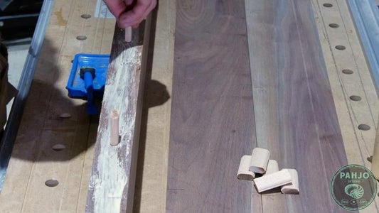

Next, I spread wood glue and inserted the dominos. I placed the boards together, clamped them with parallel clamps, and let the glue dry for a few hours.

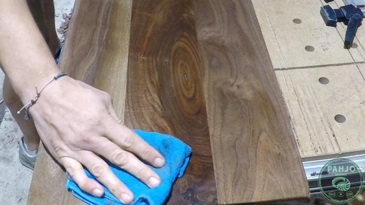

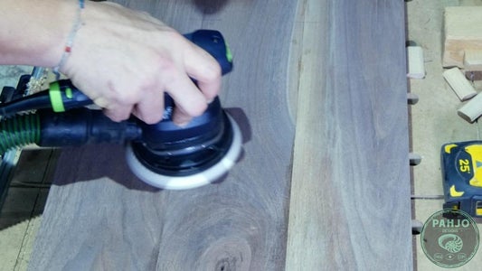

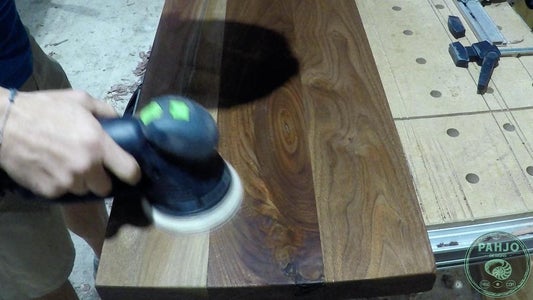

I sanded the wood with 80, 120, 180, 220, and 320 grit sandpaper.
For an extra smooth wood surface, wipe the surface with a damp rag after sanding with the last grit to raise the grain. Sand again with the highest grit while the surface is still damp.

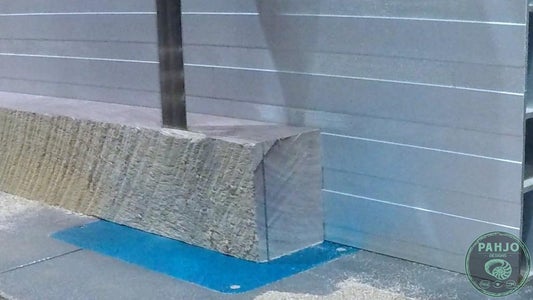

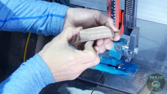

First, I cut the cross support and stretcher piece of walnut to size on my bandsaw. If you have a table saw, I recommend to use the table saw to make this cut.
As a side note, I sold my table saw and this piece of wood was too small for my track saw.
So, most people believe you can’t get a straight cut on a bandsaw.
But, I beg to differ. With the proper bandsaw, bandsaw blade, a few passes with my low angle jack plane, and the proper sanding technique I can get a very straight cut.

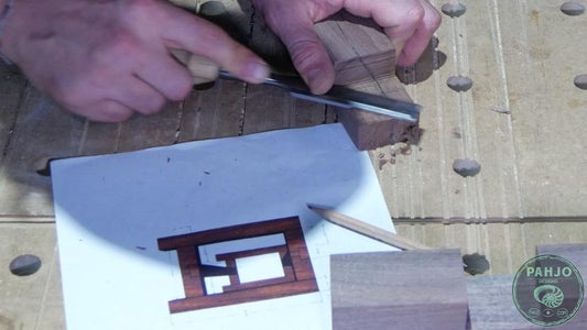

Step 5: Make Half Lap Joint

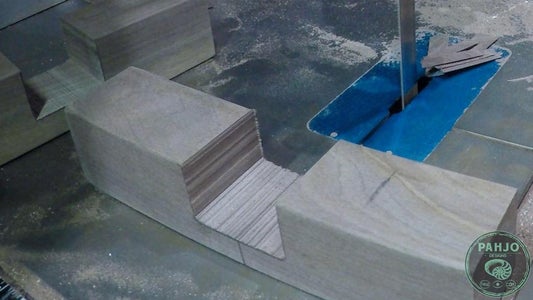

After I cut the pieces of walnut for the wooden bench seat bottom, I measured and marked the locations of the half lap joints.
I cut the half-lap joints on my bandsaw. To cut a half-lap joint, each joint needs to be cut half the thickness and the same width of the other board.

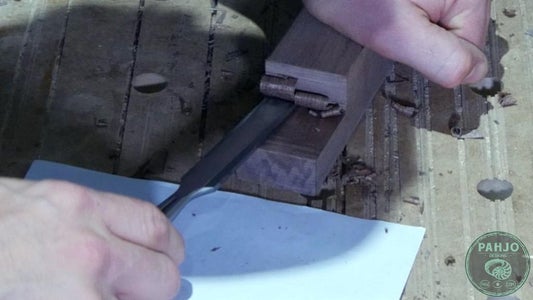

Also, I always cut my half-lap joints a bit small and clean them up with my chisels. Sandpaper works as well, but takes longer.

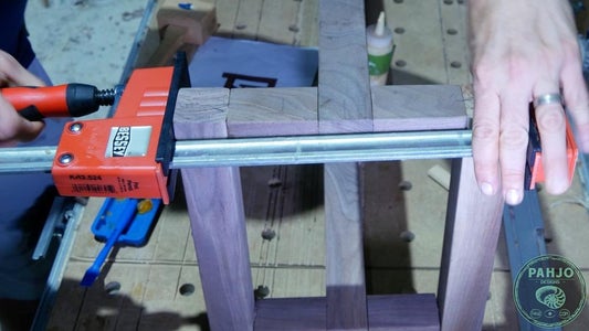

Step 6: Assemble Bottom

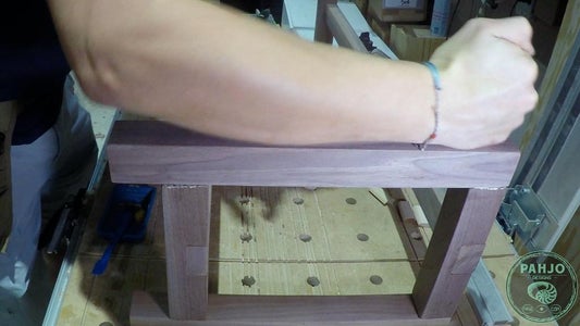

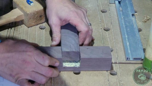

Once I finished cleaning the wood joints with my chisels, I glued the cross braces for the top runner and bottom runner.
Next, I clamped the half lap joints with F clamps and allowed them to dry for a few hours.

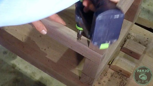

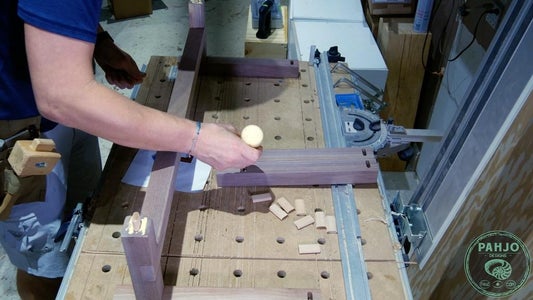

I used my festool domino to join the bottom and top runner to the 4 posts of the bench frame. Finally, I checked for square, used parallel clamps to secure everything in place, and allowed the bench bottom to dry overnight.

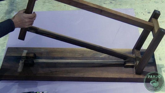

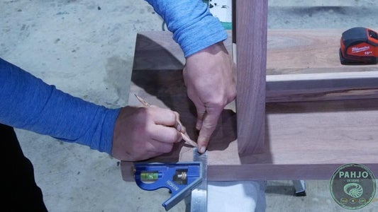

Step 7: Center Bench Bottom to Top

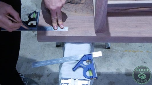

First, I used 2 speed squares to easily mark the location of the four bench legs. The first speed square measures from the side while the other measures from the end. By using 2 speed squares, I eliminate the potential of error when adjusting 1 speed square to measure 2 distances.
Once I marked the 4 locations, I placed the top of the legs bench bottom on the marks and traced it on each end.

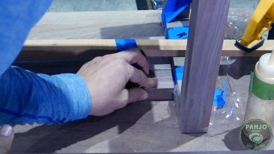

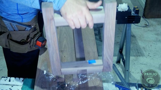

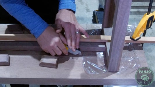

I find connector blocks (handmade pieces of wood) with threaded inserts make it easy to connect a table bench bottom to a bench seat. Additionally, it allows anyone to disassemble and reassemble the bench seat for shipping or transport.
So, I used pieces of walnut wood to cut out 4 identical connector blocks. Next, I used plastic wrap to prevent the connector blocks from sticking to the dining table bench bottom. Then, I applied glue and placed the connector blocks in the ideal location.
I used a scrap piece of thin walnut with a few clamps to apply a bit of pressure so the glue will adhere properly. Finally, I removed the bench bottom from the bench seat.

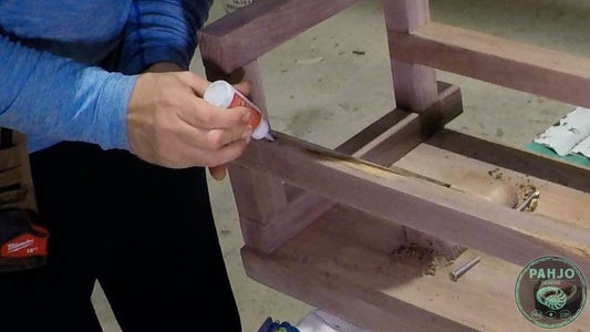

Step 9: Install Threaded Inserts

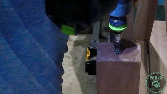

Threaded Inserts work really well to connect pieces of furniture together.

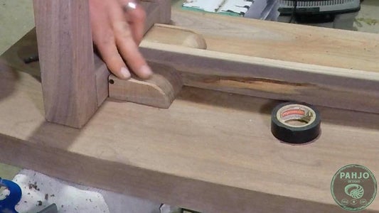

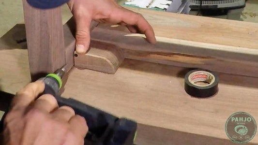

First, I placed the bench bottom in position and marked the depth of my drill bit with a piece of electrical tape.
Next, I drilled through the connector block and into the middle cross bar slightly deeper than the length of the threaded insert.

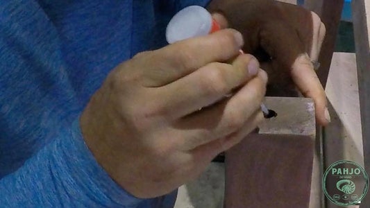

I removed the bench bottom and applied glue to the hole I drilled on the cross bar.
Then, I used my drill to secure the threaded insert in the hole very slowly in order to avoid stripping the hole. After the glue cured for a few hours, I secured the dining table bench seat to the bottom with a screw.

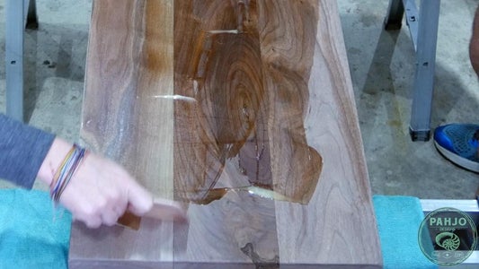

Step 12: Apply Wood Finish
As a last step, I used Rubio Monocoat Oil Plus 2c to finish the kitchen table bench seat. Actually, my wife applied the finish to this dining table bench seat. She did a great job!
Remember, a little bit goes a long way with this finish.

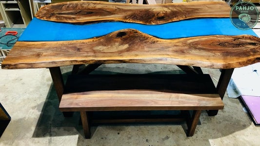

The bench fits perfectly under the side of the new dining table and looks great with the chairs at the end of the table.
