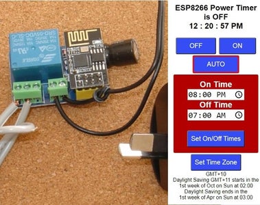

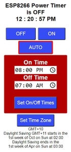

In day to day operation you will want to be able to change the mode of operation, Off, On or Auto and to set the On and Off times (used when in Auto)
(How to connect the Power Timer to your local network and how to set your time zone will be covered later, but usually not needed)
The mode and On/Off times are set via a web page. Scan the QR code to connect your browser to the ESP8266 Power Timer main page. The IP is set as part of the setup (see later). See below for how to create this QR code for your own IP. That page lets you turn the power On or Off or set to Auto so that the On/Off times control the power. To change On/Off times edit the times and then click on the Set On/Off Times button.

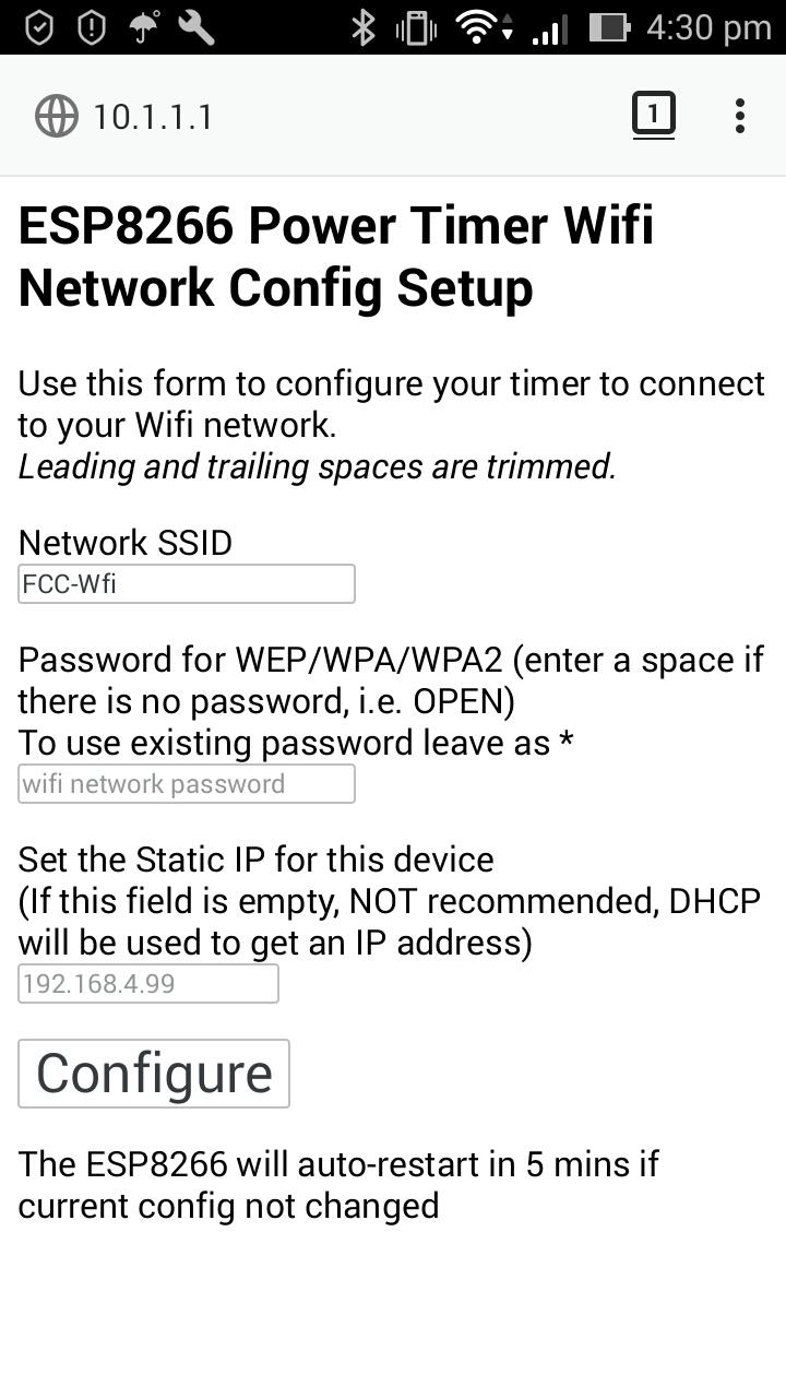

Once you have coded these default settings the Power Time should just connect to your network when you plug it in.
If it does not connect you will see the ESP-01S Blue led flash rapidly (5 times a second) for 30 sec as it tries to connect and then start to flash slowly (1sec on 1sec off) indicating the Power Timer is in network setup mode. In network setup mode the Power Timer creates a temporary Access Point (network), for 5 mins, that you can connect to to set your network's SSID, password and the static IP. At the top of wifiConfig.cpp you will find the default Access Point SSID and password
#define wifiWebConfigPASSWORD "12345678"
#define wifiWebConfigAP "PwrTmr"
This QR code will connect you to that network. See below for how to create you own QR code if you want to have a different configuration SSID and pw. If you want to use this default one you can print out this pdf file.
Note: The Access point (router) always uses the 10.1.1.1 private
network address regardless of what your home router uses. When you connect your mobile to this temporary access point and use your browser to open http://10.1.1.1 you will see this configuration web page
Note: When in Access Point mode, a DHCP server on the ESP8266 provides an IP for your computer/mobile. Set your computer/mobile to get it IP via DHCP (this is the usual setting). If you have set a static IP on your computer, if it is not in the 10.1.1.xxx range it will not connect to the PwrTmr access point. Change your computer to use DHCP instead while doing this network setup.
The SSID will be filled in with nearest network. Fill in the SSID, password and choose a free ip on your home network and click on Config to display this result webpage. The Power Timer will reboot in 30sec and try to connect the the configured network.
So to summarise. In order to display the ESP8266 Power Timer Wifi Network Config Setup webpage above, you should set your computer/mobile for DHCP. BUT when you fill in the Static IP field in that webpage, you need to choose an unused IP from your router's network.

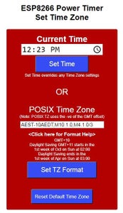

Step 5: Updating the TimeZone/dst on a Completed Power Timer
As noted above, you can set the local timezone/dst before you program the ESP-01 so usually that is all there is to it, unless you move to a different timezone or the politicians change the rules. In that case you can update the Power Timer's timezone and dst rule without having to reprogram the ESP-01
Open the Power Timer Settings web page and click on the Set Time Zone button to open the TZ setting page.
Here you have the option of just setting the current time (+/- 2mins) or entering the POSIX string that describes the timezone.
Updating the Time Zone by setting the Time
If you enter the current time and click Set Time then the Power Timer will calculate the correct time zone offset from GMT without any daylight saving rules. Just setting the current time and clicking Set Time will return to the main page with a GMT offset but no dst settings (see the third photo above)
This is the simplest way to set up the Power Timer if you move to another timezone. If that time zone does not have daylight saving, then this is all you need to do. Even if it does have dst then you can still use the simple method but you will need to reset the time twice a year as dst starts and stop, just as you need to for mechanical clocks.
Step 6: Updating the Time Zone by Setting the POSIX String
If the zone you have moved to has daylight saving rules you can enter the appropriate POSIX string (copied from TZ.h for example) to set the dst rules. See Explanation of TZ strings (local copy here) for how this string is constructed. When you click Set TZ Format the input string is parsed and cleaned up and if the cleaned up string is different from what you entered then it is re-displayed for your approval or further corrections.
Once the input string equals the parsed/cleaned up string, that TZ is accepted as valid and the Power Timer returns to the main page.
The parser is a simple one and can be easily confused by invalid formats. At a minimum you need to specify the number of hours:mins to add to your timezone to get back to GMT. e.g.
-10 for GMT+10
5:30 for GMT-0530 The : in the POSIX string is important.
Next if your timezone has daylight saving then you need to add a comma and specify the start of dst month . week . dayOfWeek and optionally /hr which defaults to 2am if missing. This is followed by a , and when the details of when dst ends. The parser/cleanup will fill in defaults for the week (5 == last week in the month) and dayOfWeek (0 == Sunday) if missing, and if the end of dst section is missing it will default to 6 months later. The default dst shift is 1hr.
E.g. entering
8,10
will be parsed and cleaned up to
<-08>8<-07>7,M10.1.0/2,M4.1.0/2
There is popup help for the time zone format

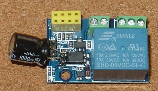

Finally there is Reset Default Time Zone to restore the time zone setting that was programmed into the ESP-01 as its default.

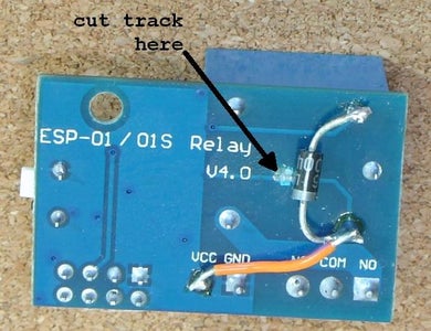

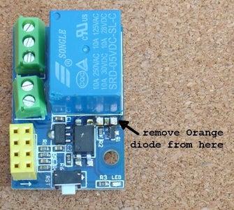

Step 7: Building the Relay Module

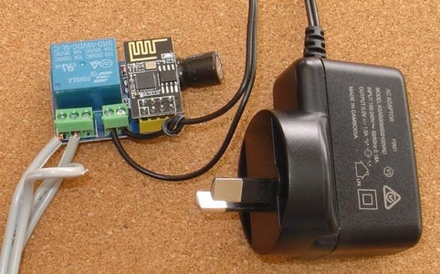

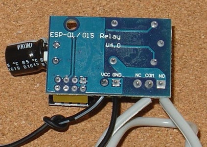

The relay module is pre-built so there is not much to do other than, add the 1000uF capacitor, plugging in the programmed ESP8266, wiring up the 5V supply and wiring in the power line you want to control.

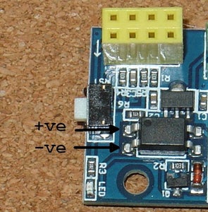

Preventing Relay Flicker on Startup
When the ESP-01 (actually any ESP8266) starts up, it toggles GPIO0 for a short time. This is enough to trigger the relay for a short time. To prevent this relay flicker on startup as large (1000uF) capacitor is added across the optical isolator inputs.
First add the capacitor 1000uF 6.3V (or higher voltage) across pins 1 and 2 of the opto-isolator. Note carefully the polarity of the capacitor and match to the pins as shown below.
The schematic for the Relay Module V4 is here.
Then wire in the 5V supply and the low voltage (<30 dc) power lead you want to control.
Note: Carefully check which lead is the +5V lead. that lead goes to the VCC terminal.
Otherwise you will damage the module. Here the +ve has had a knot added to it to make it easy to identify. For the power lead you want to control just cut one of the pair and strip the ends and insert in the COM and NO terminals.
That is the construction complete. You can put it in a clear plastic box so the ESP-01S and Relay module leds are visible and attach the QR codes. In this project, the relay module was mounted in an opaque box so extra leds/resistors had to be added. They were soldered to the bottom of the relay board so the ESP-01S module could still be easily removed for programming.

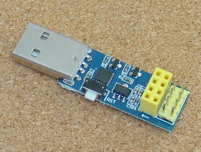

Step 8: Programming the ESP-01S or ESP-01
An inexpensive serial Adaptor with break out pins, ESP Link V1.0 was used to program and test the ESP-01S. To program, link the GPIO0 and GND pins with a jumper lead and a 330R resistor. The resistor value is low enough to initiate programming when the reset push button is pressed, but not so low as to short out any ESP8266 output if it is plugged into the wrong pins. In the Power Timer, GPIO0 is used to drive the relay and is normally driven HIGH to turn the relay OFF on startup. The 330R resistor limits the GPIO0 pin current to 10mA if it is driven HIGH, so you can safely plug in the jumper while the sketch is running and then just press the reset push button to get into programming mode.
To program the ESP-01S or ESP-01, install the ESP8266 Arduino IDE add on V3.0.2. Other versions of the ESP8266 code will have their own set of bugs/features. The Power Time code has been developed and tested using V3.0.2. The ESP Link V1.0 requires a CP2104 driver. If it is not automatically found you can install it from Silabs VCP driver (windows/mac/linux)

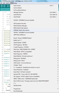

Unzip the ESP2866_power_timer.zip file to your Arduino sketch directory. You also need to install the following libraries using the Arduino Library Manager:- SafeString V4.1.14+, ESP Async WebServer V1.2.3 and ESP AsyncTCP V1.2.2. libraries.zip contains these libraries. Unzip to your Sketch directory.
You also need to install the ESP8266 LittleFS data uploader.
  1. Download ESP8266LittleFS-2.6.0.zip from https://github.com/earlephilhower/arduino-esp8266...
  2. In your Arduino Sketch directory create a tools subdirectory (if there is not already one) and unzip ESP8266LittleFS-2.6.0.zip to that tools subdirectory. (local copy here)
  3. You should end up with a file called esp8266littlefs.jar in a directory ...\Arduino\tools\ESP8266LittleFS\tool
  4. Stop and restart the Arduino IDE and you should see under Tools menu the ESP8266 LittleFS Data Upload.
Also in this menu, select Generic ESP8266 Module as the board and towards the bottom of the menu, under “Erase Flash” select “All Flash Contents” The “Flash Size” should be set to 1MB(FS:64K OTA~470KB) The Power Timer only uses FS not OTA.

To program the ESP8266, insert the 330R link between the GND and GPIO0 breakout pins of the serial adaptor and press the reset push button and compile and upload the sketch. This takes some time.
Then to upload the html files in the /data subdirectory of the ESP8266_power_timer directory, press the reset push button again and then choose Tools → ESP8266 LittleFS Data Upload. This is much quicker.
Remember to close the Arduino Serial Monitor if it is open, before using ESP8266 LittleFS Data Upload, otherwise the upload can fail.
Finally remove the ESP8266 and plug it into the Relay module and turn on the 5V supply. The blue led should flash quickly for a few seconds and then go on solid. You can then open a web page at the IP you chose, e.g. http://10.1.1.212 and set the Power Timer mode and On/Off times.
If the Power Timer cannot connect, after 30 seconds the blue led will flash slowly and the temporary access point will be setup for you to correct your WiFi SSID and password. See Connecting the ESP8266 Power Timer to your local WiFi network.
Step 9: Modifications to the Relay Module
The relay module has a 5V Relay rated for 240V 10A, but the screw connectors will not accept heavy duty power cable and one relay contact PCB tracks is unnecessarily close to the GND pin. So this module is not recommended for mains power use. For low voltage use, <30VDC, there is another possible problem. The relay has a 5V coil, but Version 4.0 of the relay module uses the 3V3 supply to drive the relay (V1 previously used VCC). While the two modules tested both worked as is, this low coil voltage seems marginal.
With few modifications, shown below, relay can be drive from the VCC (5V) supply. The diode added is a 1N4001 or similar. The orange diode removed is the previous 'flywheel' diode. It is important to remove this orange diode.
So if you find that the relay does not always pick up (turn on), the try the above modifications.
