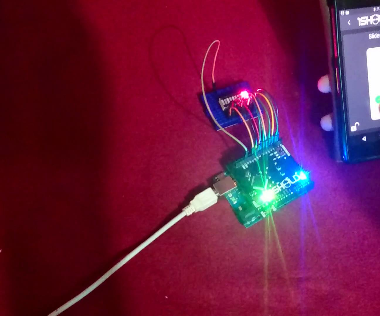

So i make a system using the arduino and the amazing 1sheeld to save a LDR readings in an excel sheet and that is what we are going to do now.

1x Arduino board
1x 1sheild board
1x LDR
3x jumpers
1x 10k resistance
1x Small bread board
1x Android phone
Step 2: Connect the 1sheeld Over the Arduino
