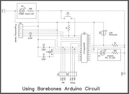

Step 2: Ardweeny Assembly and Mounting
Assemble the Ardweeny and mount the Ardweeny on the protoboard near one side of the board. Be sure none of the pins are in the common bussed strips of the protoboard if there are any. For the sensor headers, you will need to break the single row header into the appropriate pin count. You will need two 3-position headers (one for the relay and the other for the PIR sensor) and one 2-position header, for connecting the photocell cable.
See the schematic for the Ardweeny and barebones Arduino circuit. The schematic shows a power good LED that is not included and it is not critical to the circuit. It is just included in the schematic for reference and testing if you need to troubleshoot.
You will need to make wire or solder jumper connections from the Ardweeny to the pin headers for the sensors. You will also need a location on the board for the incoming 5V power and ground connections.

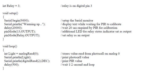

Step 6: Programming
Your will need a USB to Serial TTL programmer to upload code to the Ardweeny/Arduino. There is a zip
archive containing the Arduino code. One bit is for testing and verifying the sensors. The other is finished code for a functioning light. Using the test code is necessary for determining what level of darkness to react to. The default in the final code is "100", but yours may need some tweaking depending on your environment. The code is commented to assist with making changes to variables such as delay time and how long the light stays on when triggered.
Step 7: Code
/* The sample code was created by Ryan Winters for an Exterior Light project
for Jameco Electronics. Use this code to test the function of the sensors and also to record values reported by the sensors using the Serial Monitor.
Relay signal should be connected to digital pin 3 (ATmega328 physical pin 5) PIR signal wire should be connected to digital pin 2 (ATmega328 physical pin 4) Photocell signal should be connected to analog input 0 (ATmega328 physical pin 23) Status LED should be connected to digital pin 13 (ATmega328 physical pin 19) Status LED is already built into the Ardweeny (still digital pin 13, physical pin 19) ***********************************************************************/
