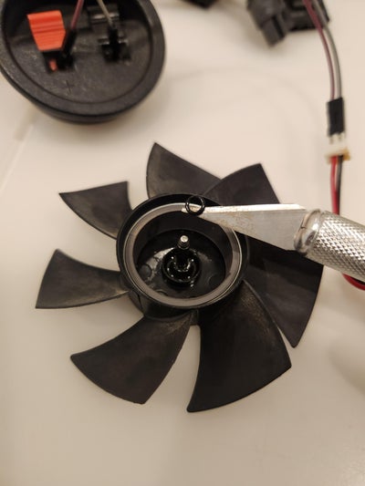

Step 4: Fan Issues

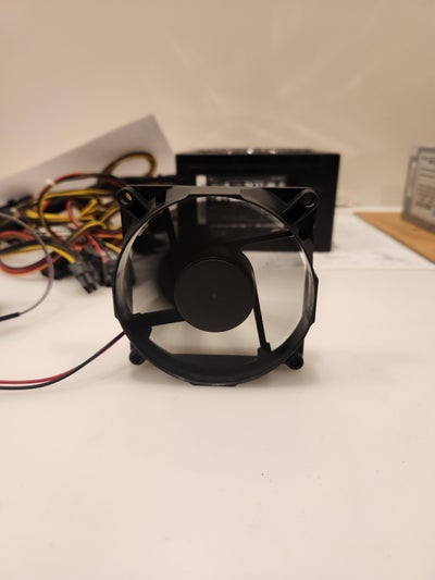

The most common issue of an old PSU is the cooling fan. More often than not, the fan has run out of lubricant and due to that, it no longer runs smoothly.
To start, unscrew the fan from the case and unplug it from the circuit board. We can now fully isolate the fan and start our repairs. First, try powering the fan with a completely separate 12V power supply (If it works then there is an issue with the circuit board, and you can wire 12V from one of the output wires to the fan internally - However this is almost never the case). If the fan still doesn't run or runs slowly it is time to start the disassembly.
Remove the sticker covering the back, try to save this as we want to stick it back on at the end. Then use a screwdriver or pliers to remove the plastic cover as seen below:
Then remove the plastic split ring. This can be tricky to do, but with 2 thin screwdrivers, you shouldn't have an issue. I have only put it on the end of an exacto-knife to show you what it looks like.
You can then remove the small rubber O-ring. Some are half-red half-black and if that is the case, remember which colour was down so that when you reassemble it later, you put it back in the correct orientation.
Now remove the blades. You can do this by gently pulling them away from the frame. They are magnetically held in place so you do need to pull them off, but it only requires very little force.
Now remove the rubber O-ring from inside the fan blades. This can just be done with your fingers.
Using a clean cloth or rag, wipe off all the existing grease. You might need to use a screwdriver or knife to scrape off any solidified dirt but be very careful so you don't damage the fan. Then take your lubricant (Light machine oil or mineral oil are some examples) and pour a very small amount through the main shaft hole, and using a slightly soaked rag, wipe it onto the main shaft and the plastic around it. Push the fan blades back into place and spin it by hand to make sure everything gets an even coating. Then remove the fan blades once more, wipe off any excess or drips, and reassemble the fan in the opposite order we took it apart (You can refer back to the images above).
Here you can see the result of a fan I fixed, which initially wouldn't start due to the grease being completely dried up.

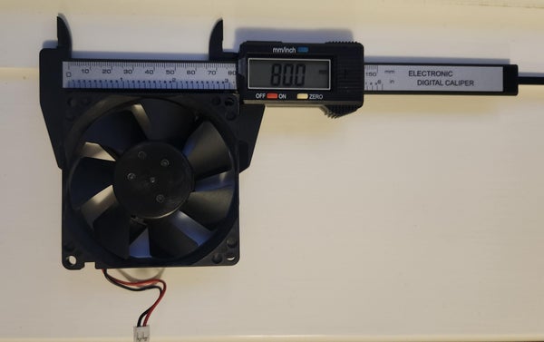

If lubricating the fan didn't work, try replacing it. The specifications of your fan can normally be found on the sticker stuck to the back. Normally they are about 12v 0.1A. Your replacement fan should match the original voltage and size, and have a current draw equal too, or less than the original. You measure a fan as shown below:
