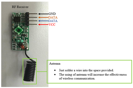

These RF receiver modules are very small in dimension. The low cost RF Receiver can be used to receive RF signal from transmitter at the specific frequency which determined by the product specifications. Super regeneration design ensure sensitive to weak signal. The receiver has 4 pins, but we actually use 3 of them: GND (Ground), VCC (5V) and one DATA pin. Same as RF transmitter, these RF receivers are breadboard friendly too. Both RF transmitter and receiver must work in pair in order to communicate with each other.

Step 2: Pin Definition
