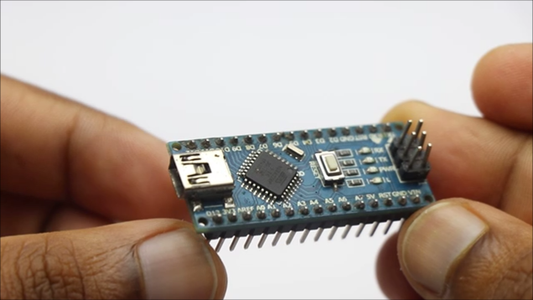

To make the project compact I will use Nano, If you don't have Nano you can also use Uno (same circuit and codes)

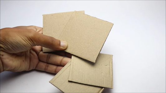

  • Cardboard to build the casing

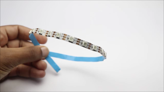

Step 1: Preparing LED Strips

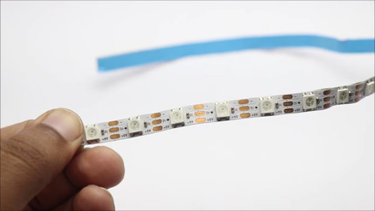

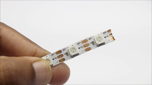

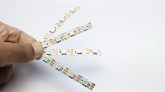

We are not using normal RGB strip in this project, we are using ARGB LED strips.
Addressable RGB, here the individual LED on a strip can be addressed, in short, we can control the colors emitted by a single LED on the strip and vary the factors like colors and timing.
These LED has 3 pins, 2 for positive and negative power supply and the remaining one for digital input or code from the controller.

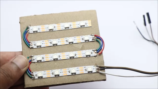

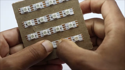

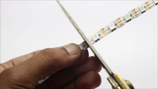

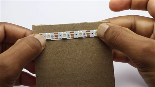

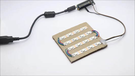

Cut the LED from the strip, I will be using 4 since I'm making a 4x4 matrix, Remove the adhesive from the back and place the strips on cardboard.
Repeat the same steps for the other 3 strips too, and make a note of the pin on the strips.

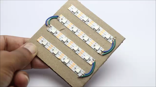

We are using 16 LEDs from the strip, Before soldering note the direction of signal flow of the LED

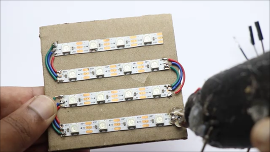

Step 2: Arranging ARGB LED Strips

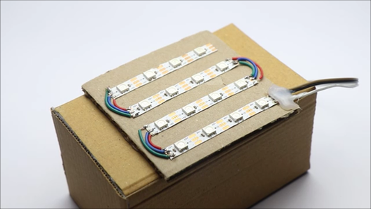

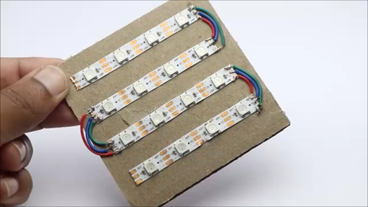

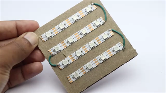

After we place the LED on the cardboard, check if all the strips are sealed to the base this is because few strips come with poor adhesive and this may cause problems later.
Now we can start to connect the wires to LED strip, if you are a beginner seek the help of an adult in soldering, because the pins of the led strip are close to each other and if you miss solder rework may consume extra time.
I used the wire pieces of jumper wires, and to identify the connections I used the wire of specific colors.
This step takes time and after you solder all the wires in the end add female jumper wires and the end of which should be secured with the hot glue.
If you have soldered the other terminals of write well no need to secure them again with hot glue.
This was the main part of the project and now we have finished it, the remaining steps are easy and we will see it further.

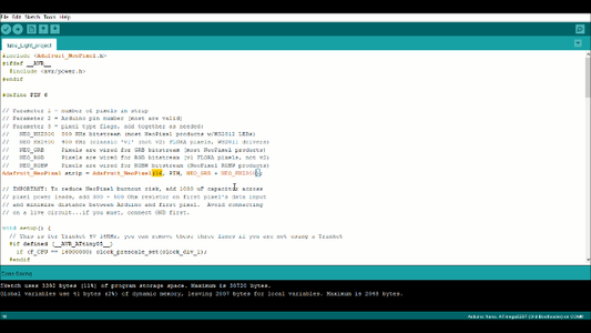

Step 3: Arduino Code
If you are using the same number of LED like i did no need of making any changes to the code, if your count is different than mine you might need to change one part of code (highlighted on the image)
Change the number of LED as per your need, in my case it was 16, change it accordingly.

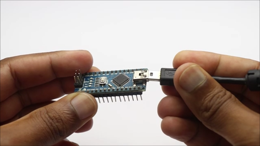

Rest of the code will remain same, Connect your nano board to the computer and open the IDE software and paste the below code.
The code is given below and the name of file is tube light project.
Check for the proper board type and port and click on upload button, if you face any issues at the time of upload you might need to check for libraries, if you are still not able to figure it out in some cases you can ask me in the comments.
After the code is done uploading to the board, Disconnect the wires.

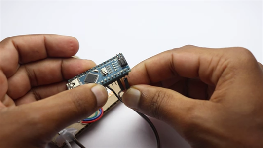

Step 4: Circuit Diagram
If someone asks what is the easiest task that a hobbyist could do, I will show them this circuit diagram!
Indeed everyone will because the circuit is very straight forward, the ARGB strip has 3 pins for connections, The positive pin, Di or digital input and lastly the gnd.
Connect the Di pin of the strip to D6 pin of nano, whereas the other 2 are connected with the +5v and gnd pin of nano.

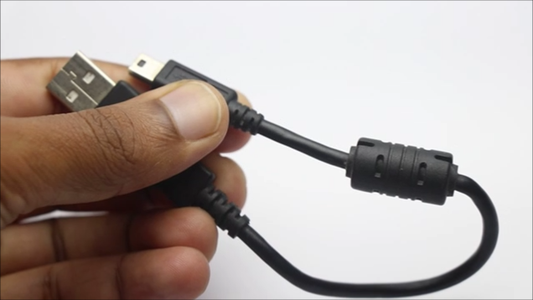

After this circuit connection is complete, connect the USB to the nano and the other end to the power bank.
The LED on the strip will start emitting beautiful colors, if any of your led strip is not glowing check for the connections again on that particular part.
This completes the circuit for this project, pending now is putting this up together and we will do that now in next steps

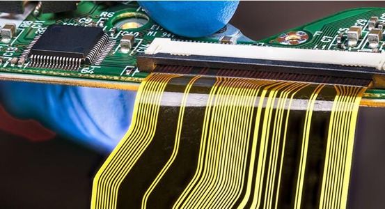

Check Here for Rigid-flex Pcbs with this your circuit becomes flexible! I have added the images to this step kindly check.
A revolutionary solution that combines the best of both rigid and flexible circuitry to elevate your electronic projects to new heights.
With their expertise in advanced manufacturing techniques, they offer a seamless integration of rigid and flexible components, ensuring enhanced reliability, durability, and space-saving benefits

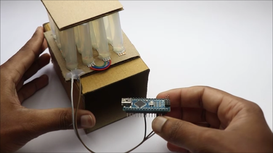

Step 5: Adding Glue Stick

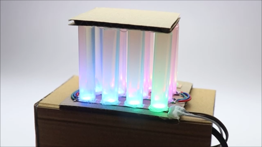

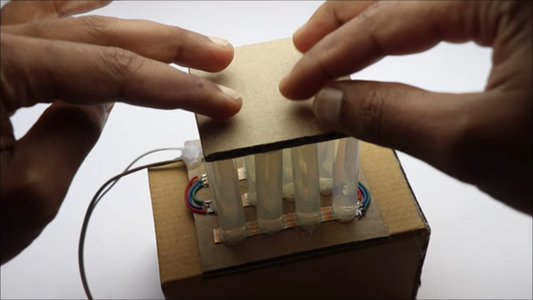

Glue this board that has led to the top of the box that holds all the electronics together.

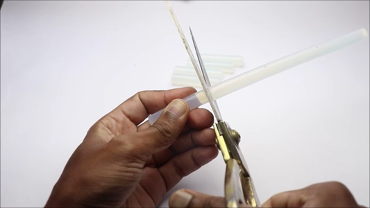

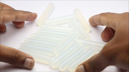

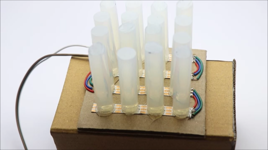

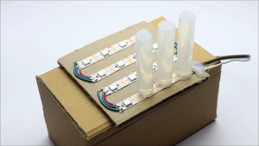

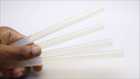

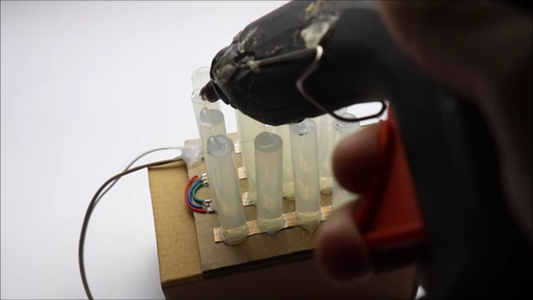

Now the diffuser will be placed on top of all these LEDS on the strip, i marked 5cms on each gluestick(my length of gluestick was 20cms)
Repeat the same steps for other 3 sticks, in my case i will get 4 pieces of stick from each glue sticks
Cut the marked areas, now heat the glue gun and just touch the tip of these each stick and place it on top of the LED.

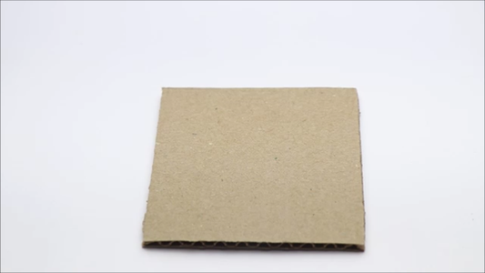

Repeat the same step for other 15 stick and wait to dry, after all the sticks are dry, add a drop of glue on all these and gently place a piece of cardboard.
This completes the diffuser part, now organise all the electronics inside the base below.

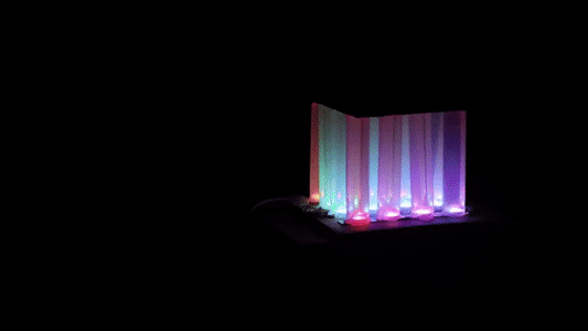

Step 6: How to Use

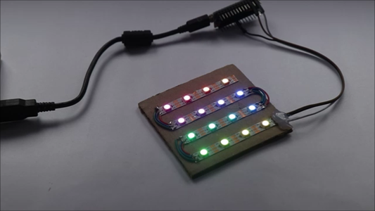

Using this light is very simple, All you need is power bank.
Just connect the power bank to the nano board and watch the LED turn to on.
This illuminates crazy color combinations and if you know how to program you can also change the colors as per your taste since the LED are programmable and there is no limit to generating color combinations.
