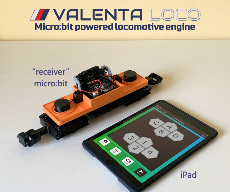

Step 2: Setting Up Micro:bit IOS GamePad App
For installing micro:bit iOS App on your iPhone or iPad, pairing the app to the micro:bit and setting up the Game Pad, please refer to the project "Using IPhone or IPad and Micro:bit Game Pad App to Control an RC Car" throughout the step 2 to 12. In this previous project, we've assigned the Game Pad buttons A through D in the following ways:
- Pressing button A -> The car going forward
- Pressing button B -> The car going backward
- Pressing button C -> The car turning left
- Pressing button D -> The car turning right
For this project to turn on and off the LEDs, why don't we assign the Game Pad button 1 and 2 in the following ways:
- Pressing button 1 -> Turning on the LED lights
- Pressing button 2 -> Turning off the LED lights
