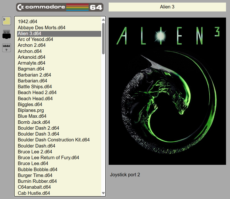

Step 4: Using the Spreadsheet
Ensure all the physical connections are made between the Commodore, Arduino and PC. Check the Hardware Connections step for details and diagrams if needed.
  • Remember that the Commodore should always be turned off when physically connecting to it
  • On the c64 or vic20 tab, click the Connect button to connect to the Arduino. A colour indicator around the button shows the status of the connection
Background colour: Connection not started
Red: Not connected
Orange: Connected ok, handshake in progress
Green: Arduino handshake ok, ready to go
  • If there is a problem connecting, reset the Arduino and wait 5-10 seconds, then click Disconnect and Connect again
To select a program to load, click on the cell of the program you want or alternatively, enter the program name in the cell beneath the Connect button. Usually Excel will find the name before you type it in full.
Click on the Show box art button to see box art associated with the program. Clicking through the program names will show art for the selected program where available.
