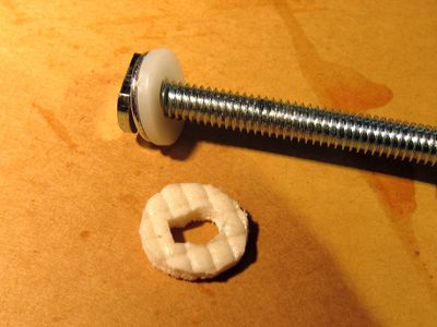

Step 4: Camlock
I found that the camlock (WoodRiver cam action hold down) works much more efficient if it has some kind of spring back so I made a washer from the leftover drawer liner. An X-acto blade works real well for this. One of the pictures shows a small gap between the walnut and the bottom Padauk wood. I didn't want too much friction when sliding it across. I then applied some plastic tape to the bottom of the walnut. This will make for easy sliding and no scratching of the wood. This is Slip Tape used for skateboarding but you should be able to get a similar type at most any woodworking store. UHMW Slick Tape
Now cut a small square of pad to place on top of the walnut. Double sided tape will not work. Use hot glue. The adhesive from double sided tape will move all over the place when you put pressure on it. I even tried 3M and it didn't work too well. The pad still came off. This completes the top section of the parachord jig.
