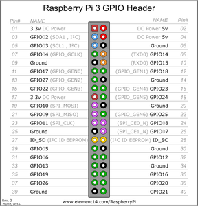

First, we want to set up the I2C drivers for the Raspberry Pi. I2C is a type of communication protocol that allows data exchange between microcontrollers and peripherals with very little extraneous wiring (for more in depth description, check out the following link: https://learn.sparkfun.com/tutorials/i2c). We begin by downloading command-line utility programs that will help get the I2C interface working by typing 'sudo apt-get install -y i2c-tools'. Then to set up the I2C interface itself, we first turn it on by typing 'sudo raspi-config' and then scrolling to '9 Advanced Options' -> 'A7 I2C' -> 'yes' to enable I2C -> 'yes' to automatically loading the kernel module -> '' button -> 'yes' to reboot.
After this, we can check that the interface is working by typing 'ls /dev/*i2c*' to which the Pi should respond with '/dev/i2c-1'. We can also check whether any devices are present with the command 'i2cdetect -y 1' which should display the addresses of peripherals detected. For troubleshooting, check out these links: (https://learn.adafruit.com/adafruits-raspberry-pi-lesson-4-gpio-setup/configuring-i2c, http://www.raspberrypi-spy.co.uk/2014/11/enabling-the-i2c-interface-on-the-raspberry-pi/).

The schematic involves connecting the I2C controlled PWM chip(PCA9685) to pins 3 and 5 of the raspberry pi. The 5V Pin on the GPIO header can be used to power the entire Raspberry Pi board, so it is attached to the 5V supplied by the two USB-B Connectors. The Raspberry pi will provide a 3.3V power source once it is powered, which can be used to power the PWM chip. Each of the outputs of the PWM chip is connected to a small MOSFET driver circuit containing a 10Kohm pulldown resistor, 2N7000 Mosfet, and a diode to protect the circuit against inductive kickback from the
