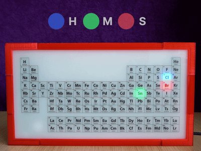

In this guide, you'll learn how to create a unique clock that displays the time with the atomic numbers of elements on the periodic table. By illuminating specific elements on the table, time is represented in hours, minutes, and seconds. If you are familiar with the periodic table or the atomic numbers of the elements, you can tell the time from far away just by seeing the elements!
How Is the Time Displayed?
The time is displayed using 3 colors Blue, Green, and Red representing hours, minutes, and seconds. If Oxygen is illuminated Blue, and Neon is illuminated Green it means the time is 8h:10m or in other words Neon past Oxygen!

I recommend you to print all pieces before assembly. It will be much easier to assemble with every piece on your reach.
I've used two different filaments for the frame and the base.
Red Filament - All frame parts
White Filament - Base and Light guides

Step 2: The Periodic Table
I created the Periodic table from scratch in Adobe Illustrator to match the exact dimensions, the design was later UV printed onto the 3mm plexiglass. I contacted a local advertising agency that produces engraved keychains etc. but also offers UV prints on plexiglass.
My second option was to print the periodic table onto transparent sticker paper with an inkjet printer and attach the paper to the plexiglass. This would also keep the transparency for light to shine through however the first option was more accessible for me that's why I went with that one instead.

You are done with the basics now it's time to test this clock! Now while doing that you should check a few things to be sure that this clock can run for 7/24 straight.
Things to look for:
  • Is every LED properly displaying all the colors?
  • Is the clock on time after several hours?
  • Are the LEDs in order?
If your answer is no for at least one of those questions, you can check the Troubleshooting step!
If your answer is yes, then congratulations you've built a precise clock!
