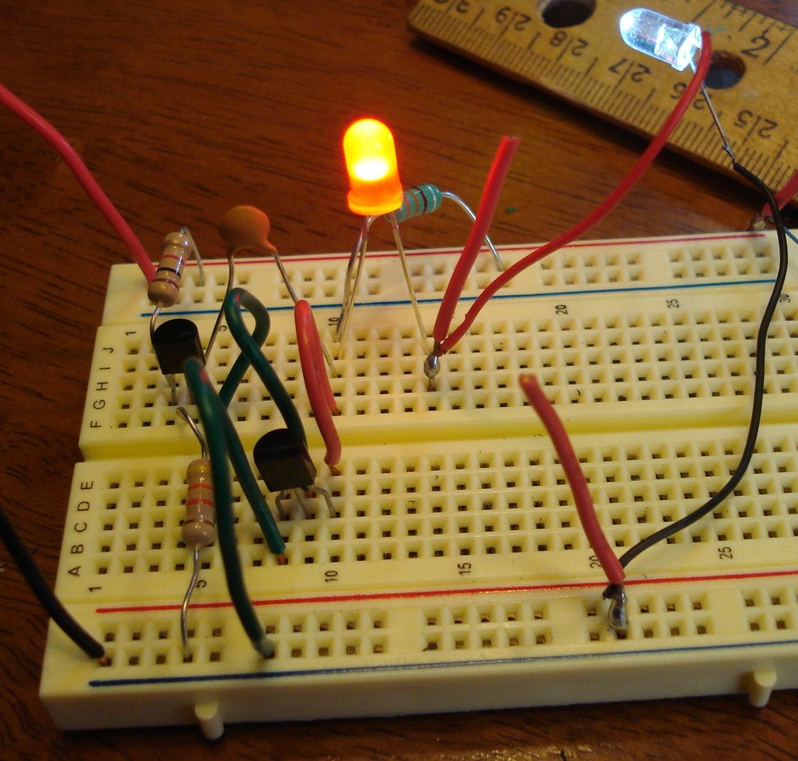

Here is an image of parts before final assembly and test. But I really recommend that you visit and view:

Finally, I've included a pic that reveals how I wired things up. And if you prefer a different operation of this device, just change the program for the 08M2 Picaxe.
