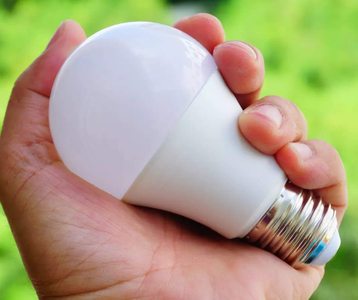

Step 7: LED Bulb Mount

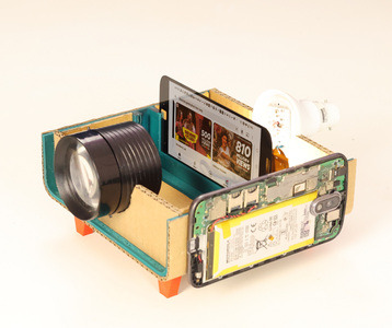

Cover the case with cardboard and insert the projector's 3D-printed back side for mounting the LED bulb. Remove the round diffuser from a 9-volt LED bulb by twisting it with your hands, then place the LED bulb at the back side of the LED display.
Step 8: Lens Mount

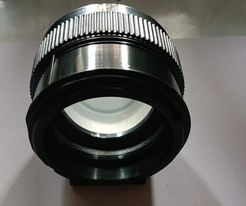

Place the projector's 3D-printed front side for mounting the lens. Mount a 500-mm focal length convex projector lens on the front side. This lens can move front and back to remove blurry projected images. I need to setup lens only first time you set projector.
Step 9: Turn ON

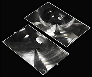

Connect a 9-volt bulb to the power supply and the mouse to your smartphone via the OTG pin. Then turn on the LED bulb and smartphone. For a narrow display picture, place a 7-inch focal length lens in front of the LED display and deliver a 500mm F convex lens. Then place the top case over the projector.
Step 10: Use
Throw a beam on any white surface by playing any video on your smartphone with the mouse.Turn off all room lights for better brightness and quality. If the projected image appears blurry on the surface, move the projector lens slowly forward or backward.When the projected image is clear, stop moving the lens.
