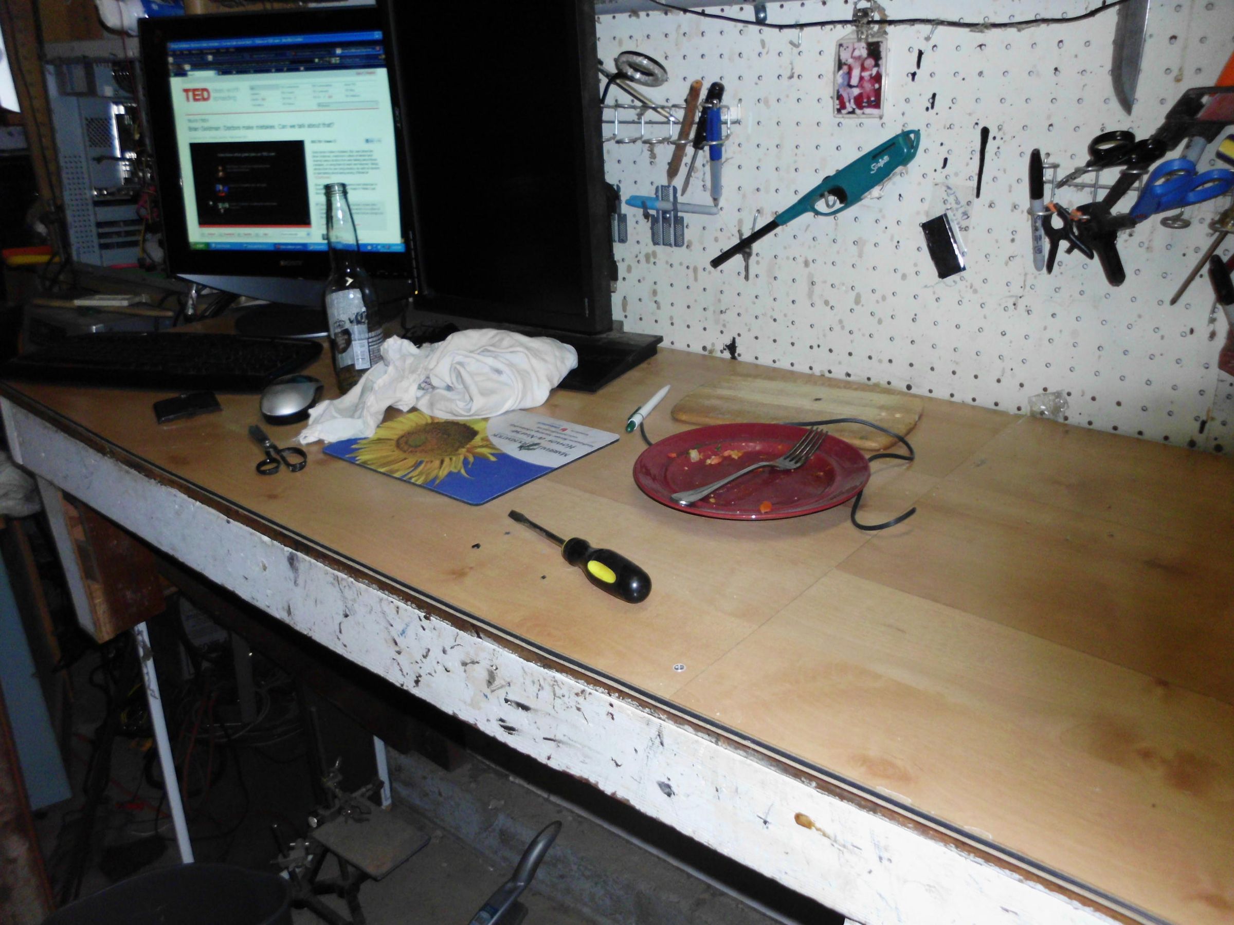

I split it open and removed the battery pack. I laid the new pack in and cut one side of the handle as far as the current circuity would allow.
Step 2: Put It Back Together
I put the driver back together as the wires I would splice were long enough to do this work outside the driver. I have a bunch of these batteries so I planned on swapping them out. With this in mind I put a new connector (TAMIYA fitting) left over from Remote car days. Later I decided to just tape it in and charge it in place after trying bungees and other methods of holding the battery. I taped it in with what is known as rescue tape. I buy generic tape off amazon in packets like the one above the drill in the picture. Stuff is awesome for all kinds of uses. I have other drivers but this one fit in places the others won't and I like making trash useful again.
