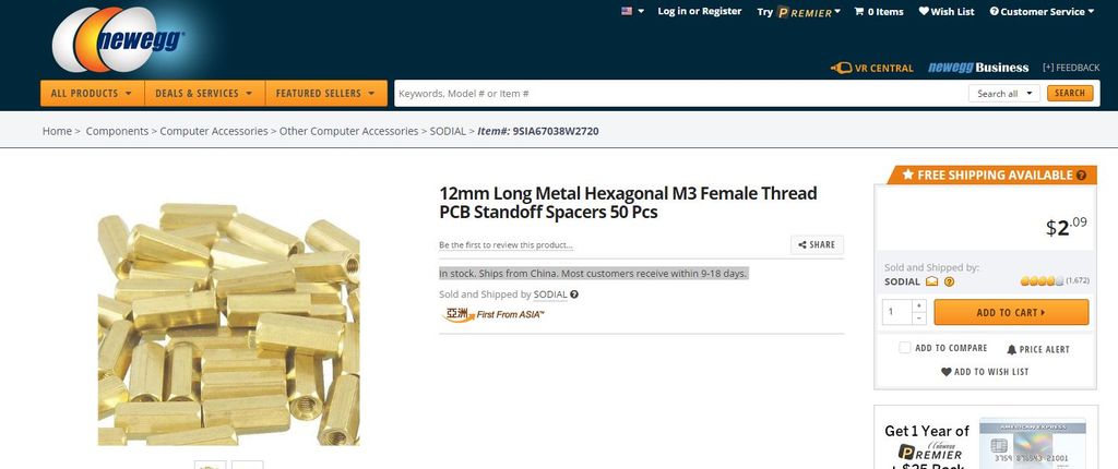

Step 6: Install Coupling Nut
I had a 3 mm coupling nut which I cut with a hacksaw to make threaded spacers to replace the Molded Plastic housing. I cut these the same length as the original housings (About 6 mm long) A 3mm screw attaches the coupling nut to the Laptop Lid. This screw goes a little less than halfway in the coupling nut. You need to leave some threads available for the hinge to secure to. There will be two screw heads showing on the laptop lid. The sketch shows the side view of how the coupling nuts are secured.
