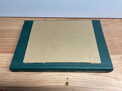

Step 2: MAKE THE SUPPORT
Cut your hardboard so it fits inside the book but leave a border of paper at the edges. You can do this with the utility knife but be careful. You don’t want to see the hardboard from a sideview, only pages.

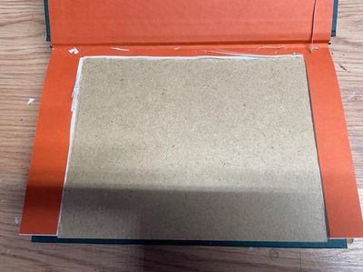

Step 3: CUT THE PAGES
Center the support and bracket upside down inside the rear cover. Cut away enough pages with your utility knife to clear the support. Then cut away a narrower channel of pages to clear the bracket.
Step 4: ATTACH THE BRACKET TO THE SUPPORT AND GLUE
Centre the bracket on the hardboard, mark the mounting holes. and drill. Attach the bracket with pop rivets. (Or screws and nuts.)
Test to see if it all fits. You may have to cut away or notch the top cover. Also, if you used screws you may have to cut spaces in the inside cover to clear the heads so the cover will sit flat. If it’s all good, glue everything in place. (Remember to glue to the inside back cover.Turn it right side up and place some heavy weights on it till dry.

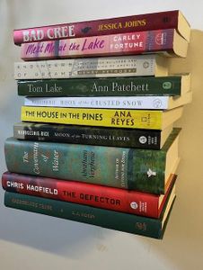

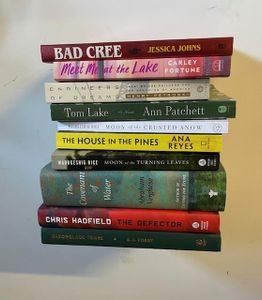

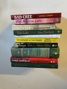

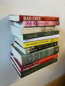

Step 5: ATTACH TO a WALL
Make sure it’s level, mark the hole locations. Attach to the wall using plastic wall anchors and screws. Stack up your books.
