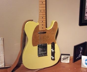

Since I was going for the relic look, I ordered as much of the hardware in that worn or aged look as I could. I had a left-over black pick guard on hand, and when I laid it on the body with the neck, it just seemed to fit the build. It was starting to look like a guitar!
