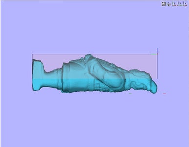

Step 2: .stl to Cut3D to ShopBot .sbp
For preliminary testing, I used 2"x4" pine wood. Actual dimension 1-3/8" x 3-3/8"
I imported the stl file into Cut3D software and scale the CAD to my desired dimension.
I rotated the object so that the front is facing up or in +Z direction.
Next step in Cut3D, I define my wood stock size.
I would be using 0.25" diameter ball nose cutter.
I intend to cut the front and rear separately and glue them together.
For the front, I am cutting to 1.25" depth. For the rear, I am cutting to 0.75" depth.
Since the ball radius is 0.125", it should cover 1.75" depth for which I scaled my object to be.
I will then use a table saw to trim each of the parts to their right thicknesses.

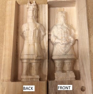

Step 3: Shopbot Parts and Finished Works
Attached photos shown are from my first try. The discontinuity occured at the top hat and below the arm.
They would be remedied if I cut them on the same piece of wood instead of separate wood and gluing them.
In this case, I would have to use thicker wood or make the figurines smaller to fit the 2"x4" woods.
I could use these for painting practice.
